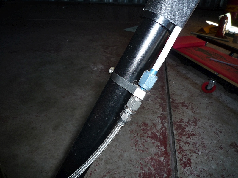

Jeff,
This is the only picture that I found quickly... it shows the transition from the aluminum tubing to the flexible S.S. hose with the little clamp I made. The flex goes down similar to Bruce's picture, but follows the structure a little tighter/closer. It then attaches to a 90 deg. fitting on the caliper assembly.

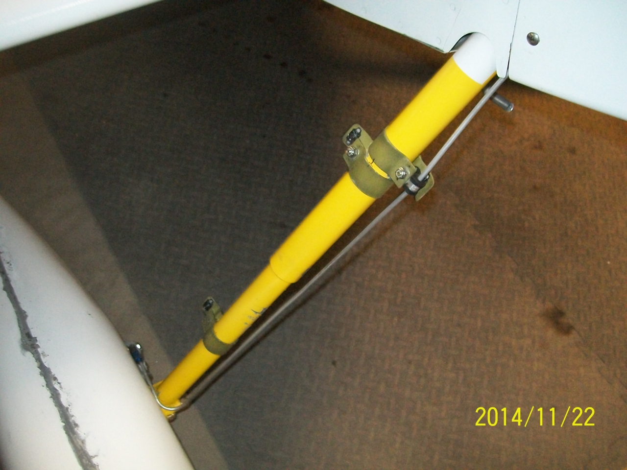

Hey fellas, here's another example for brake line.

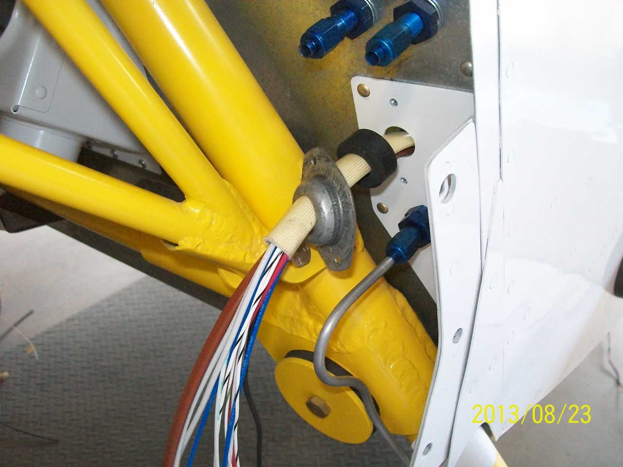

Mine is 3/16 SS with service loop on each end for flexing. It also has rubber lined standoffs to keep it from touching anything along the way. I look at calipers and exposed lines for freedom each time when I check brakes for preflight. Ya gotta know the A-frame gear is secured quite well at the top, but the two lower bushings at fuselage allow some freedom, right where R & L brake lines typically emerge. That's an important place to have a loop and some flexibility. Mine don't really grip the leg, they're free to slide through the Adel clamps. The other critical point is obviously where the caliper floats on the brake disc. You'll see I only have one real tie-down, which occurs halfway down the leg. Rubber sleeves protect the line from the fairing, but there's lots of freedom as indicated before making end attachments. Fairings have to be removable for occasional inspection so the trailing edges are held by screws. I'm confident that any sign of wear will show on the fairings first since they're just thin aluminum sheet while tubing is steel. It's a matter of routine inspection that we all do. Steel is also less prone to fatigue and better for high temp. That's something to consider: my brakes got pretty hot as I was still on the learning curve with my plane.
In the top of the photo you may notice two fittings into the firewall for cabin and carb heat control cables. They're really automotive 'choke' cables, not fluid connections. I made a pair of crossed cuts into end of the AN832 bulkhead fittings so the nut and sleeve clamps down on the flexible control cable. Kind of an inexpensive way to make a pass through on the firewall.
My two cents,
Les Krumel

Very nice, Les! I really like your idea to use the bulkhead fittings for the control cable penetrations. Absolutely right about needing to accommodate movement at the bottom of the firewall area. I didn't have to do a "loop", as mine goes over a little more towards the center before penetrating, lining up where I wanted it with my master cylinder(s). Even as stiff as they are, the gear legs also do flex and you have to keep that in mind also (not directing that at you of course, but just thinking to myself). Watch your brake line where they go "loosely" through the Adel clamps. I've seen loose Adel clamps really eat into 4130 tubing when a little dirt gets embedded in the surface of the rubber. My aluminum lines are securely attached to the gear leg at the union where the S.S./Teflon hose connects shown in the picture. Otherwise, they ride the leg with rubber & duct tape... no problems in 26 years. Another nice possible advantage to using hose at that point is that you can remove the brake cylinder assemblies for cleaning or lining replacement easily without disconnecting hydraulic lines or having to bend any tubing.
