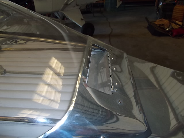

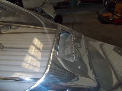

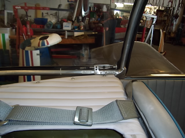

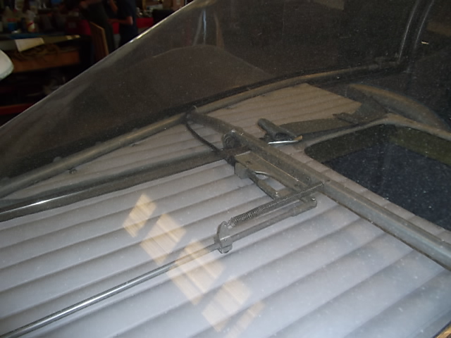

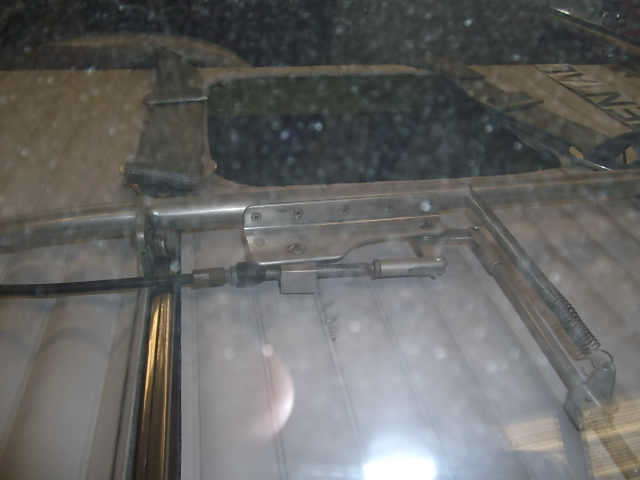

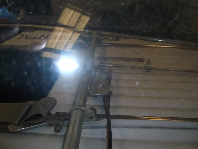

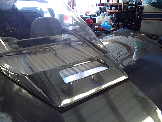

This is the best I can do . Went and took pics of John Kerr's AC, which is still for sale after 6 months of the FAA blowing smoke up my arse having to due with a reissue of a Special Airworthiness Certificate . A subject I will cover in depth at the Sedona Fly In . If anyone is interested in John's AC I am the point of contact . I'll publish stats on the AC later .
The canopy vent is 3" wide x 10 inches long . It is controlled by a push pull cable on the left side of the canopy . The open/close mechanism is a bell crank arrangement . Sorry no drawings or parts list , but from the pics you should be able to figure it out and hopefully not crack the canopy ! ::)

I don't have one but I remember the big boys telling me it is the size of a dollar bill. Same size for the trim tab on the aileron. With inflation now it might be the size of a 5 dollar bill

That is close to the size RB came up with. The one in the Photo was in the aluminum rear part of the canopy, I have also seen them just in the Plexiglas. It may be better to have it incorporated into the aluminum for longevity of the Plexiglas???

I recommend starting smaller and work up .. 3 X 10 is way too big! The max size should be the size of a dollar bill .. I'd even say 80% of the size of a dollar bill is plenty.
Hair grows back .. plexi-glass does not!
