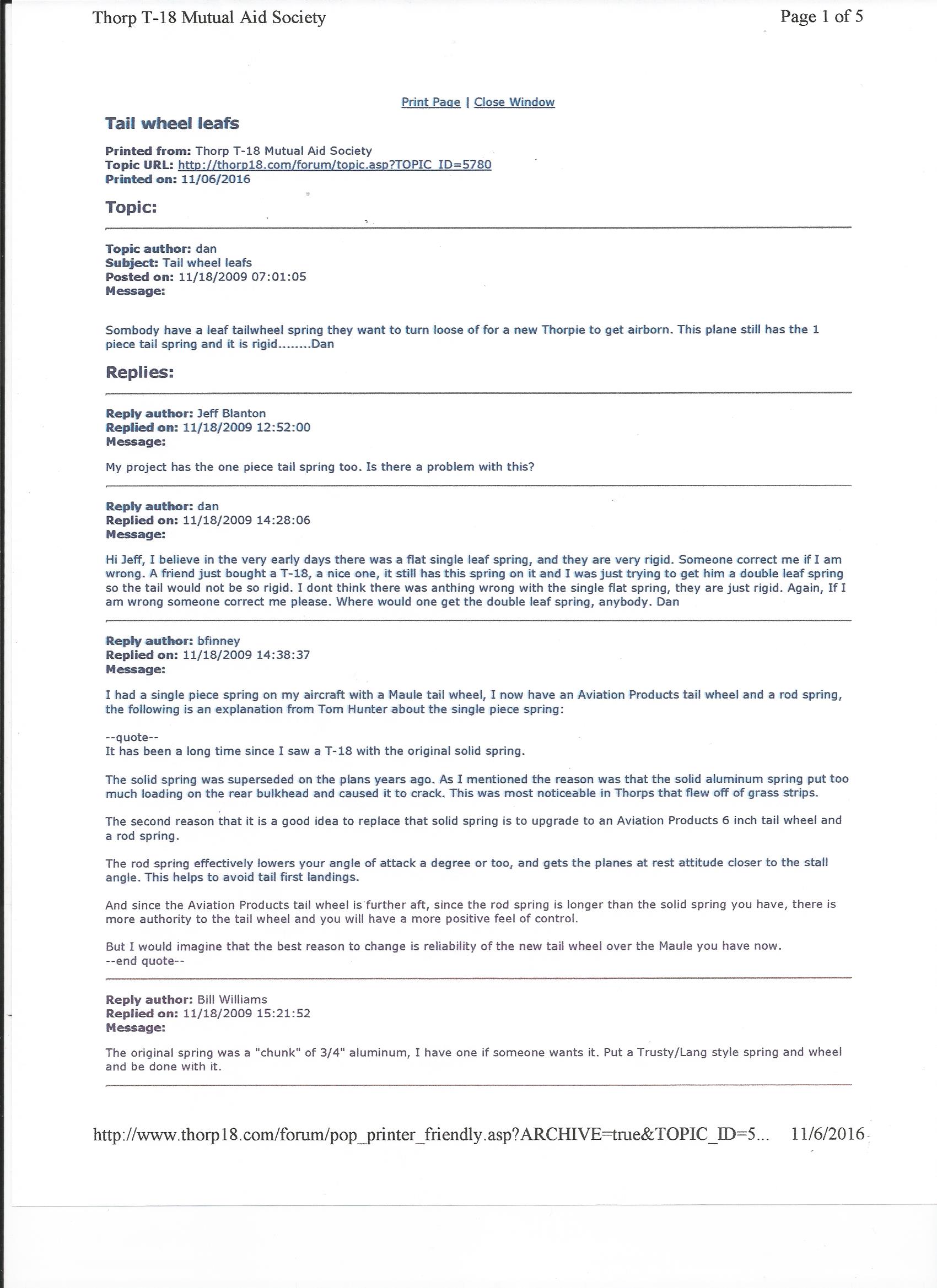

What Cubes said plus this from the "Old Forum." Great resource , more people should use it .
