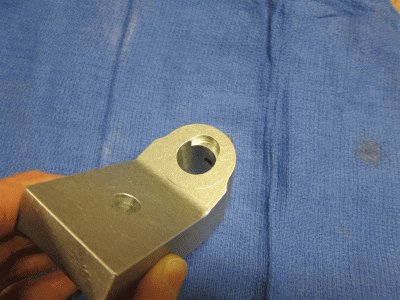

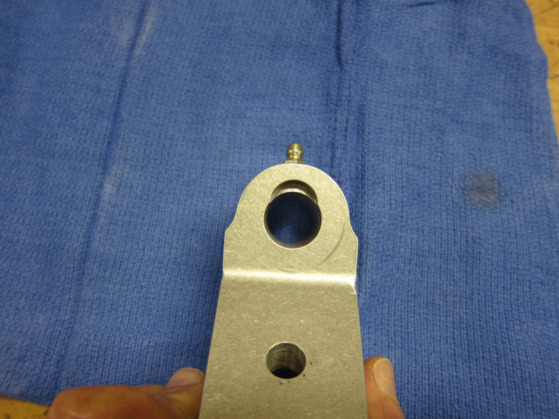

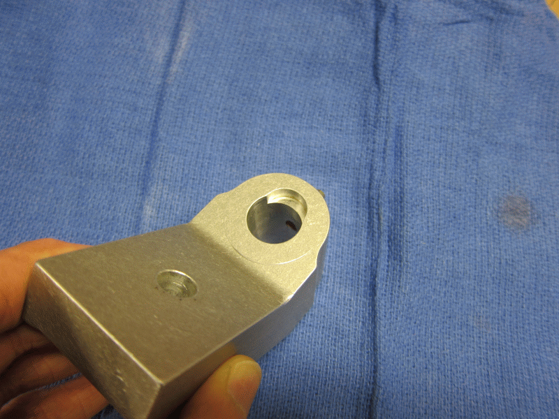

PostPosted: Wed Apr 02, 2014 8:46 pm
Here are a couple of pictures of an unmodified hub, Jim. the cut-out was obviously made with a 5/8" diameter end mill. If you use one of those, locate it in the existing cut-out, then go about .020' in both directions (left & right), it will probably be close to what you want from my experience. You may have to go a little more in each direction to get exactly what you want. A little goes a long way... .020" is not very much material to remove, of course. The action of the lubricated key on the "ramps" will be fine. There are more complicated ways to do it a little differently if you so desire.
