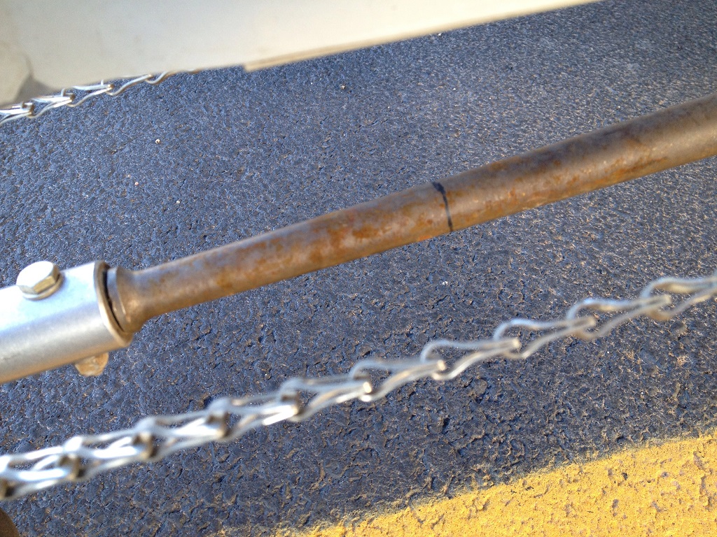

I've noticed recently that my Trusty tailwheel spring has some surface rust on it. See attached photo. Do I need to paint this, or can I just do something to get rid of, and then mitigate, the surface rust?
If I need to paint it, do I have to remove it to do so? I was thinking I could just hit it with an appropriate spray primer and spray paint, without removing it.

Brian : Not that big of a deal to remove it . You probably have some surface rust on the rod where it attaches to the bolster and where the rod inserts into the tail wheel . Removing the rod would allow you to get ALL the rust off before you prime and paint .

I painted mine. Looks good and makes it easier to clean. If you didn't want to paint it, at least keep some Boeshield T-9 on it.

A little rubdown with some scotchbrite to remove that little dab of rust, then a little epoxy primer, then a little enamel or somthing of the sort and it will be good for years......Dan

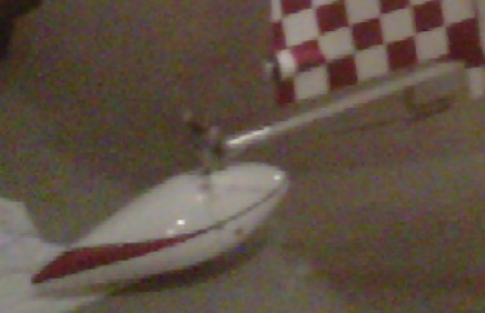

Mine was rusting while on the shelf waiting to install. Painted it a few years ago, holding up fine.

Thanks for all the advice. For now I think I'll use the T-9 and then plan on removing the tailwheel spring, and paint it, during the annual, in June.
