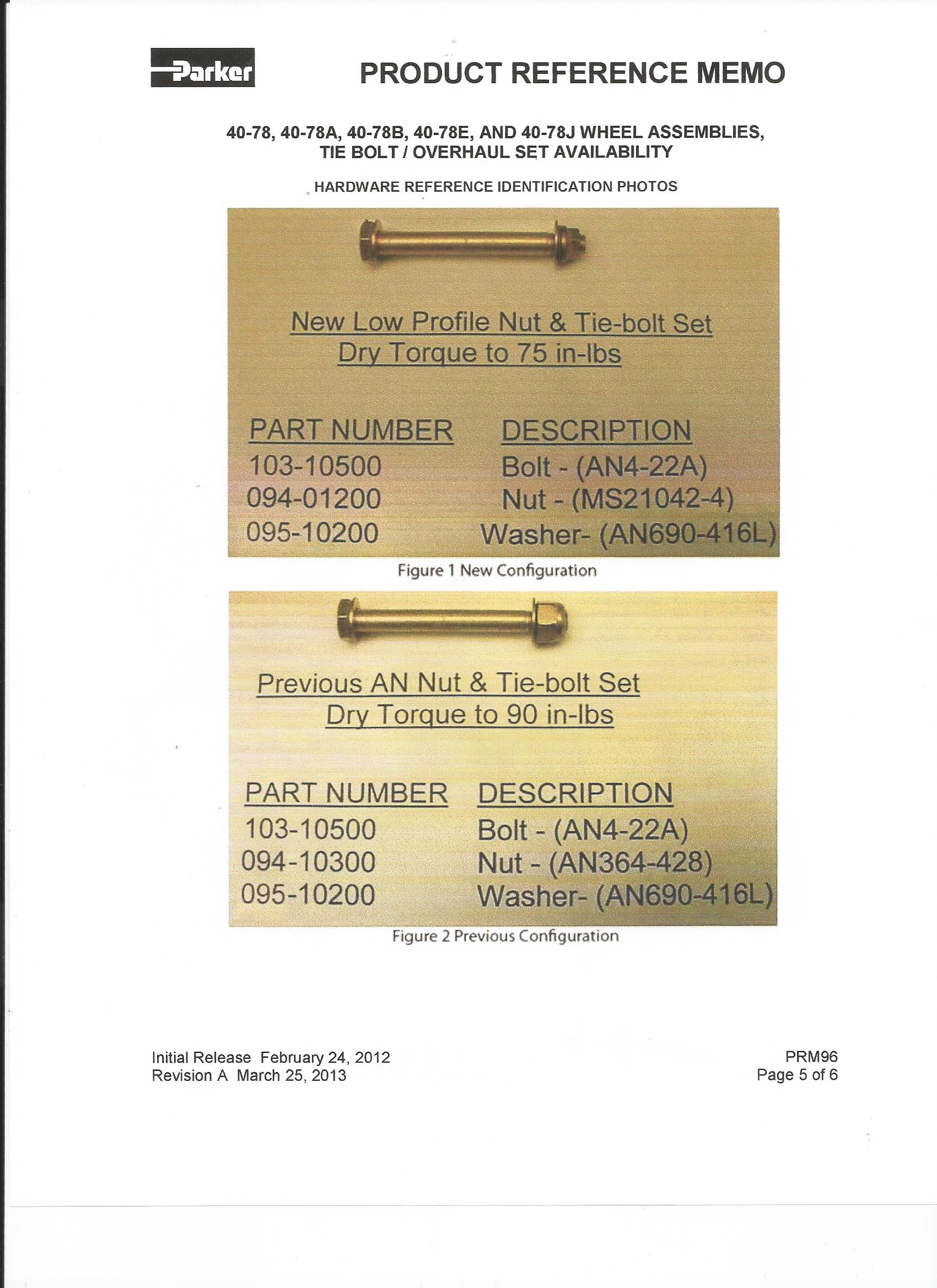

Something to probably install during your next tire/tube brake job . ::) Sure makes R & R the wheel assembly easier . ;)
PostPosted: Sat Mar 05, 2016 8:09 pm
How does it make it easier, Rich?
PostPosted: Sat Mar 05, 2016 8:40 pm
You can put a socket on the "nut." If you need any further instructions I can type them up and send them to ya !
PostPosted: Sun Mar 06, 2016 2:08 am
Ahh..."I see" said the blind man! I switched to that style nut a long time ago on my wheels. What I'm curious about now is why they specify a lower torque value compared to the AN365 nut. In my experience the all metal lock nuts have a higher "running torque" than the nylon lock nuts. The running torque is added to the specified torque to get your torque wrench setting of course. Regardless of that, it seems like the actual torque required to pre-load the bolts (the same bolts that have been used forever on these wheels) would still be the same - the bolts are the same. Maybe they decided after all these decades that those bolts & nuts were tighter than they need to be? Type your answer up & send it to me. ::)

You funny man young grasshopper ! ;D No need to send message as you have turned on the light and can now see the printed page ! ???

Could have used that info last week when I re-tired!
PostPosted: Sun Mar 06, 2016 6:39 pm
About 35 years ago I ground the edge of a socket to a thin wall for this very reason. I still have it. Used it a couple of weeks ago when I put shiny new disks on.
PostPosted: Sun Mar 06, 2016 6:49 pm
I use two Craftsman 1/4" drive sockets and ratchets out of the box, no modifications

I use snap on socket, no clearance issues
