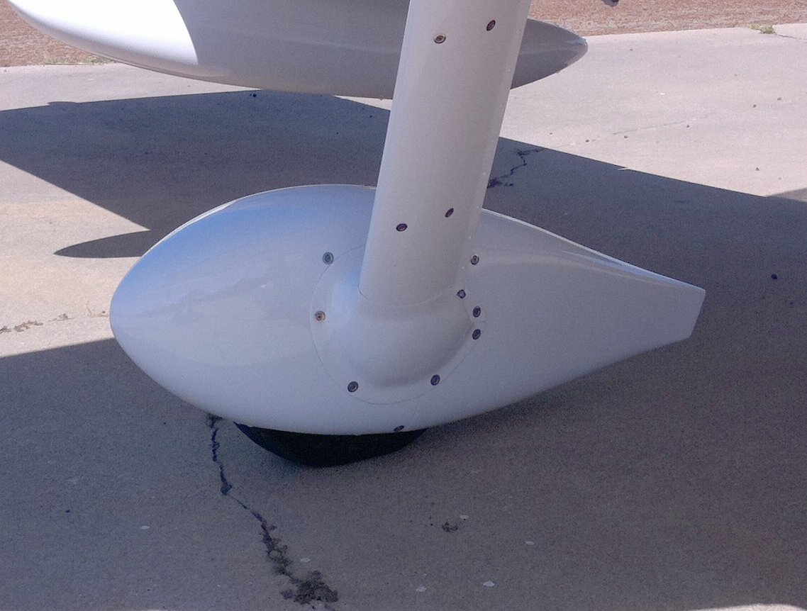

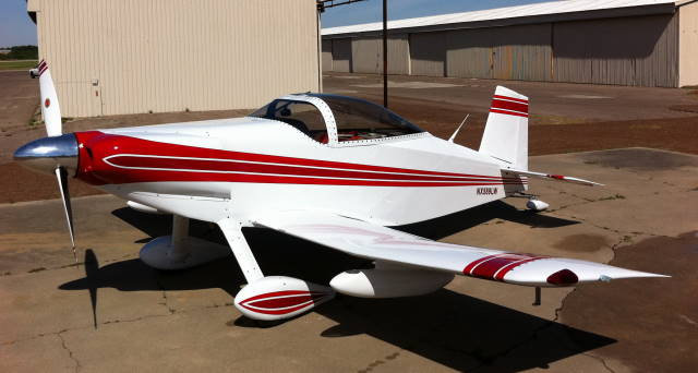

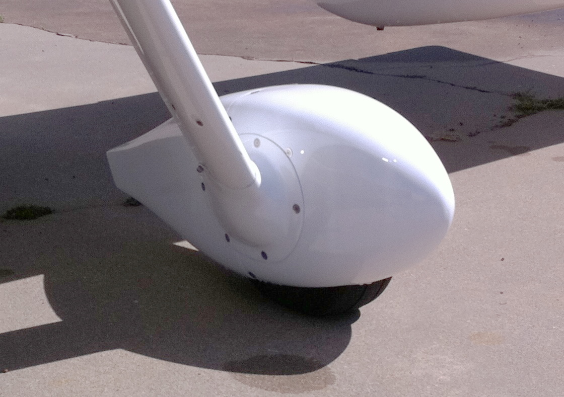

N589LW picked up a new pair of Sam James shoes last week. Actually last month but it took me that long to get them fitted, intersection fairings made, painted etc. ...
I used to have a set of Rattray's on there that I had actually installed at the wrong angle of attack. Had they been straight I probably would have lived with them but since I was going to have to make a new set of intersection fairings to get them straight I decided to move out of the 1970's and get some 'high tech' wheel pants.
I didn't expect to gain anything out of them speed wise. My goal was to not loose any speed. I can honestly say I didn't gain a knot or loose one, so mission accomplished!
In case anyone is wondering these are priced at $112.50 a piece ($225 a set) so they're about the best deal around.
They required a bit of work to get fitted, but what doesn't?

Lee: Did they come with a nice "gel coat" on them or did you have to do a lot of prep work filling pin holes and smoothing out the ruff spots. I know I spent hours preping mine and probably could have spent more gettin them ready for paint. We could really use a good glass man for the group that does a nice job gel coating our parts like the tips, cowls and wheel pants. I am not a fiberglass man ( and never intend to be one when I grow up ), but I would have paid a premium ( I mean $$$ ) for some really nice fiberglass parts to put on my A/C and not spent hours and hours trying to make it look good ! The only thing this stuff has that metal doesn't is when I make a mistake I can just add more glue !

No gel coat, the finish is very good as far as pinholes go and light. Looks like he gets a good saturation coat first, the parts are glass smooth on arrival. The only flaws are at the seams, there you have to sand/fill a bit and a few pinholes do come out of that due to sanding down the top coat to eliminate the seam.
BTW ... gel coat is for boats ... on airplanes it just adds weight and ends up cracking later.
