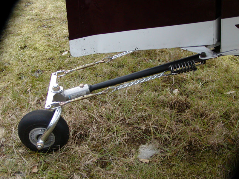

Floo the plane yesterday - a sunday mid day "get closer to the creator" (or the black hole at the center of our galaxy sucking us in to a space/time continuum if you're a astro dweeb) flight - picture perfect landing - toofy smile and taxi back to hangar - went to spin plane to line up for hangar entry and "pop" - port tailwheel chain broke - well, not the chain, but that teardrop shaped wire clip thingy right where the 150 deg bends happen. Shirley glad it didn't go pop during rollout, or ground loop city. Mee wunders whether I had the chains a tad on the tight side, and have been over loading said teardrop clips to the point of premature fatigue.
So...what's does one call those little teardrop shaped clips, anyway?
Tho I think it scared me enuff to do away with them, re-design and get sumpin a little stronger.......It got me thinkin about doing a single rod rigid connx on just one side of the tiller bars, unless the hole to hole dimensions are the same on both the rudder bar and the tiller bar, then you could hard connect both sides for symetry purposes.

I'm not sure that thingy has a name, ACS just calls it a "clip".
I wouldn't do the single sided rigid setup, you need the springs and there's too much force on that tailwheel, something has to give a little during operations, if it's not the spring it's going to be in the form of something fatiguing and breaking.
The best set-up around come from Bob and Bill. I'll let them speak up but put short they use swaged cables and turnbuckles. I'd like to swap mine out as well, maybe we could talk them into making a couple of sets for us (hint hint).

Before things go south on this discussion I'll add that those little clips have served many a tailwheel for countless hours and are completely airworthy.
The main reason I want a set of cables is that they look nice, N51863 has been using the same set of "clips" for 30 years + and they still look fine and show no signs of wear.
I think we had this discussion about a year or so ago, but I think what happened here is that Frase had his clips attached directly to the tailwheel arm rather than to an AN eye bolt. (incorrect Frase has his attached to AN-42(s)) This created pressure points on the clip. Frase did you in fact have the clips attached directly the arm?
Here's what I think works best (if using chains);
tailwheel arm -> AN-42 -> 'clip' -> chain -> compression springs -> AN-43 > rudder
Also before we swamp Bill or Bob with this, ACS sells custom cable assemblies, all they need are the dimensions.

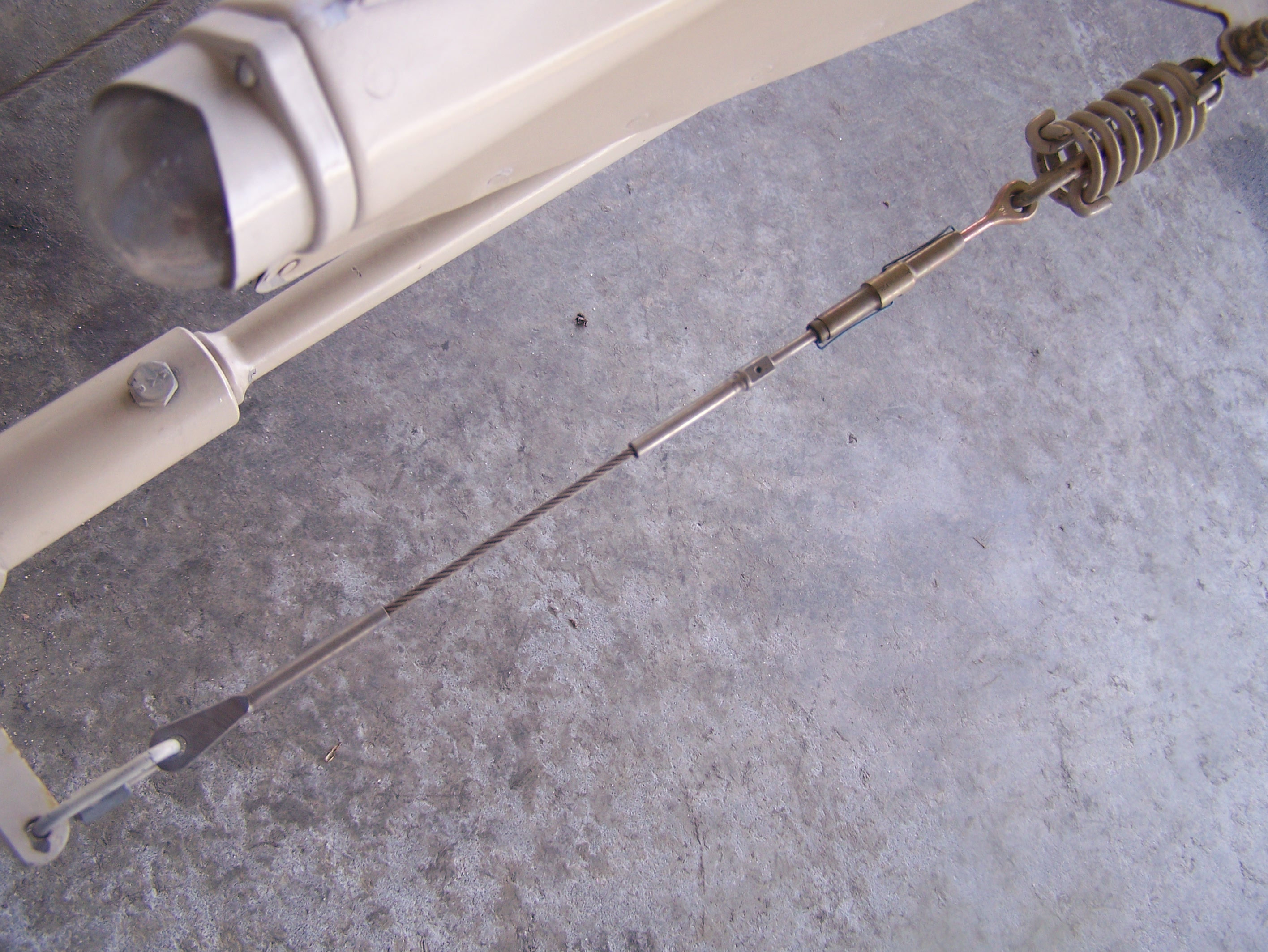

Here's a photo of my setup using turnbuckles and Fraser's "swigit copulator" that I procured from Home Depot Aerospace. My chains connect directly to the springs and a clip is used from the chain to the turnbuckle.
Image Insert:
Fraser, if it would make you feel better I'm willing to sell you some of those clips that your life depends on for $25.00 each. [:)]
