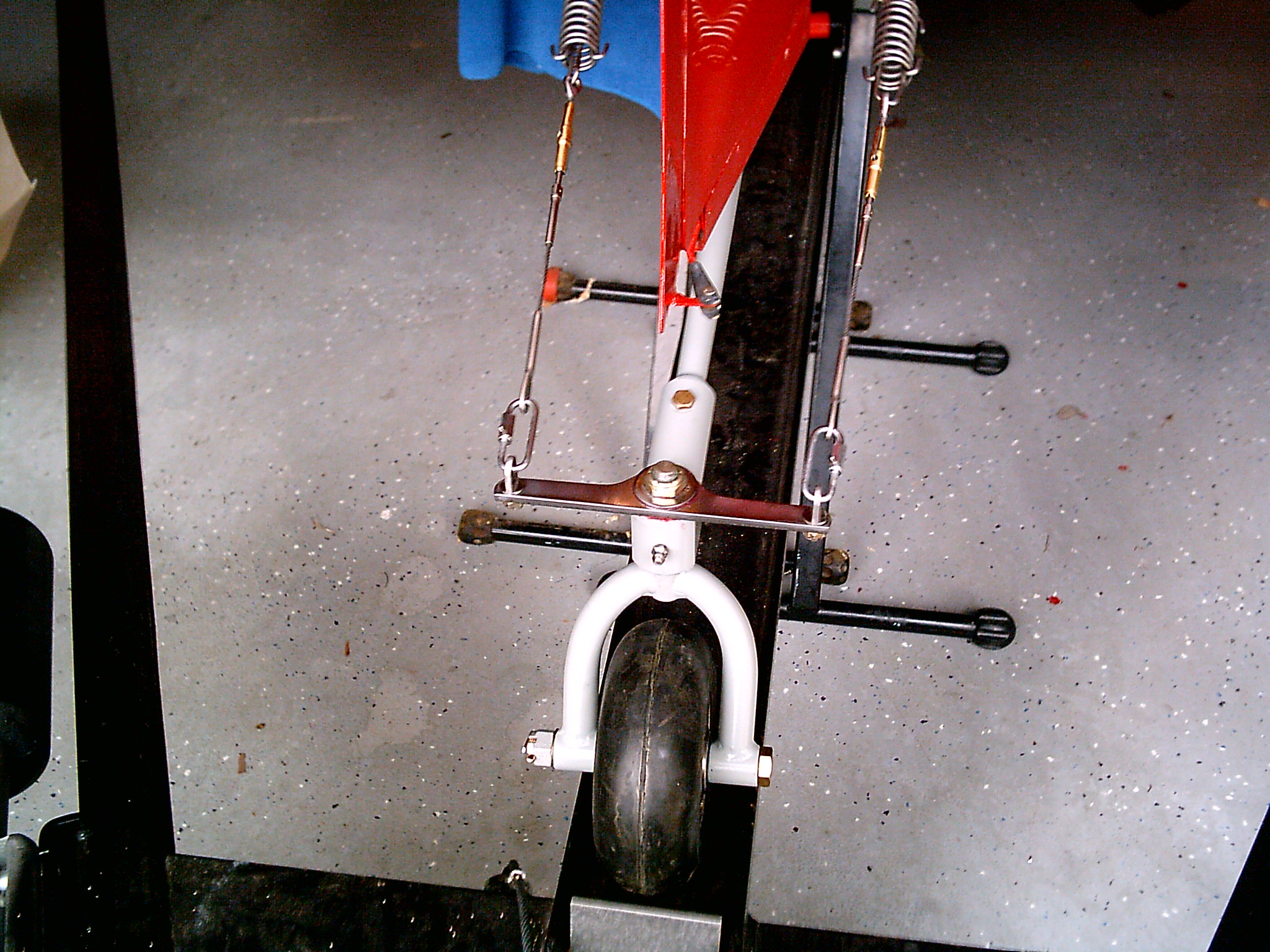

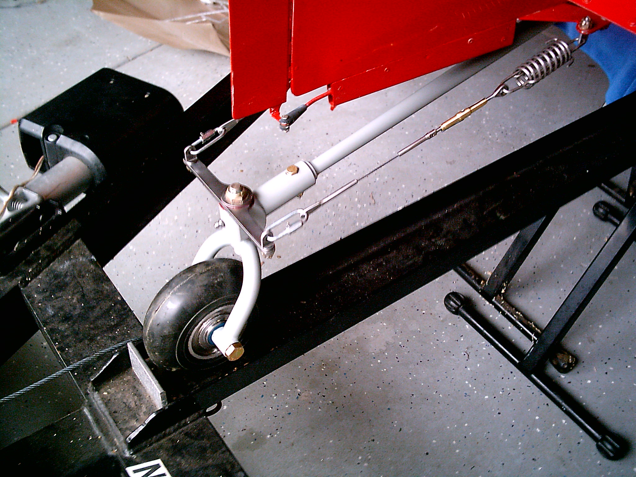

Just got the rod , fork and other tail wheel hardware back from the powder coating shop . No more painting ! ;) Since I had the wheel off it needed a new bearing and rather than put a new bearing on a worn tail wheel I replaced the wheel also . Now was also a good time to clean up the eye bolts and stainless steel hardware . BOOM !
