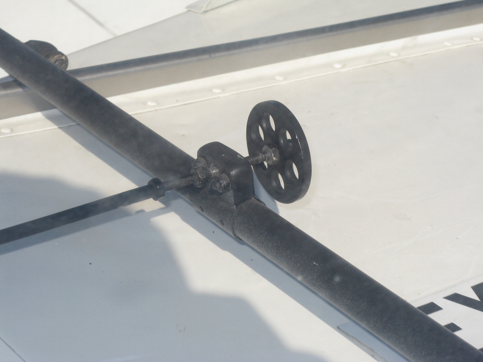

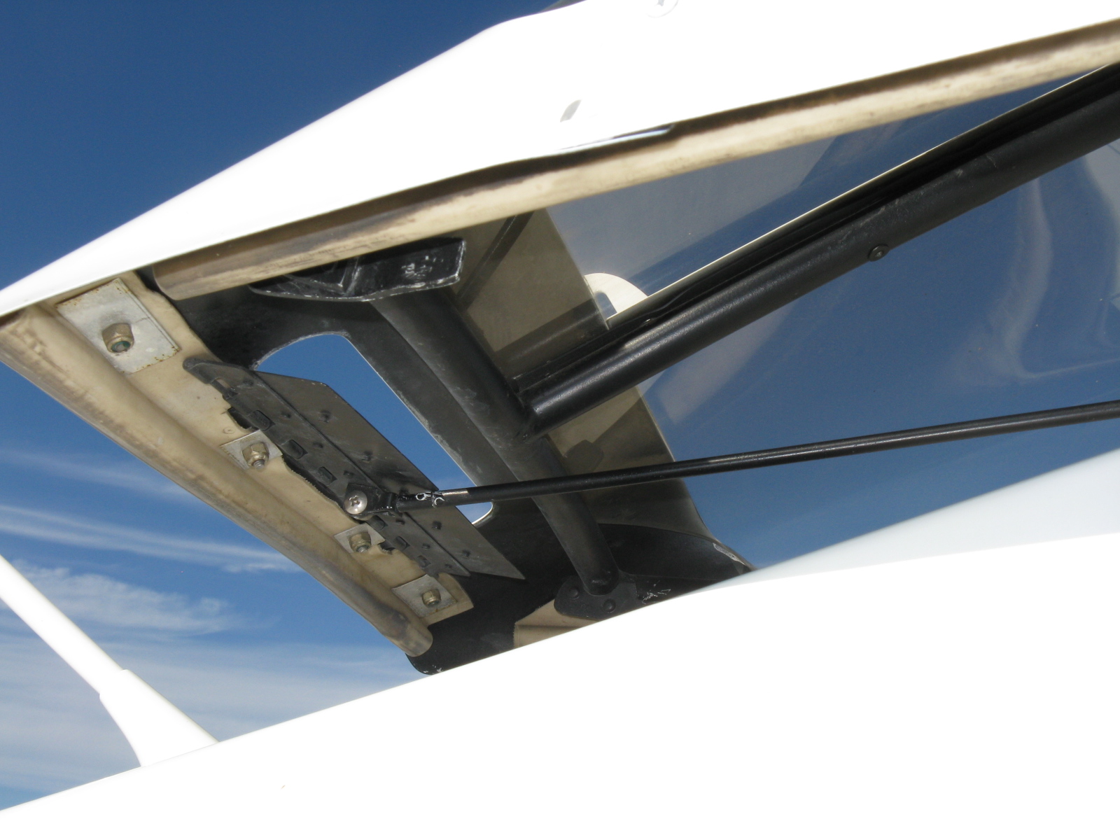

Mine is similar to Rich's except for the control. His control maybe easier to access.

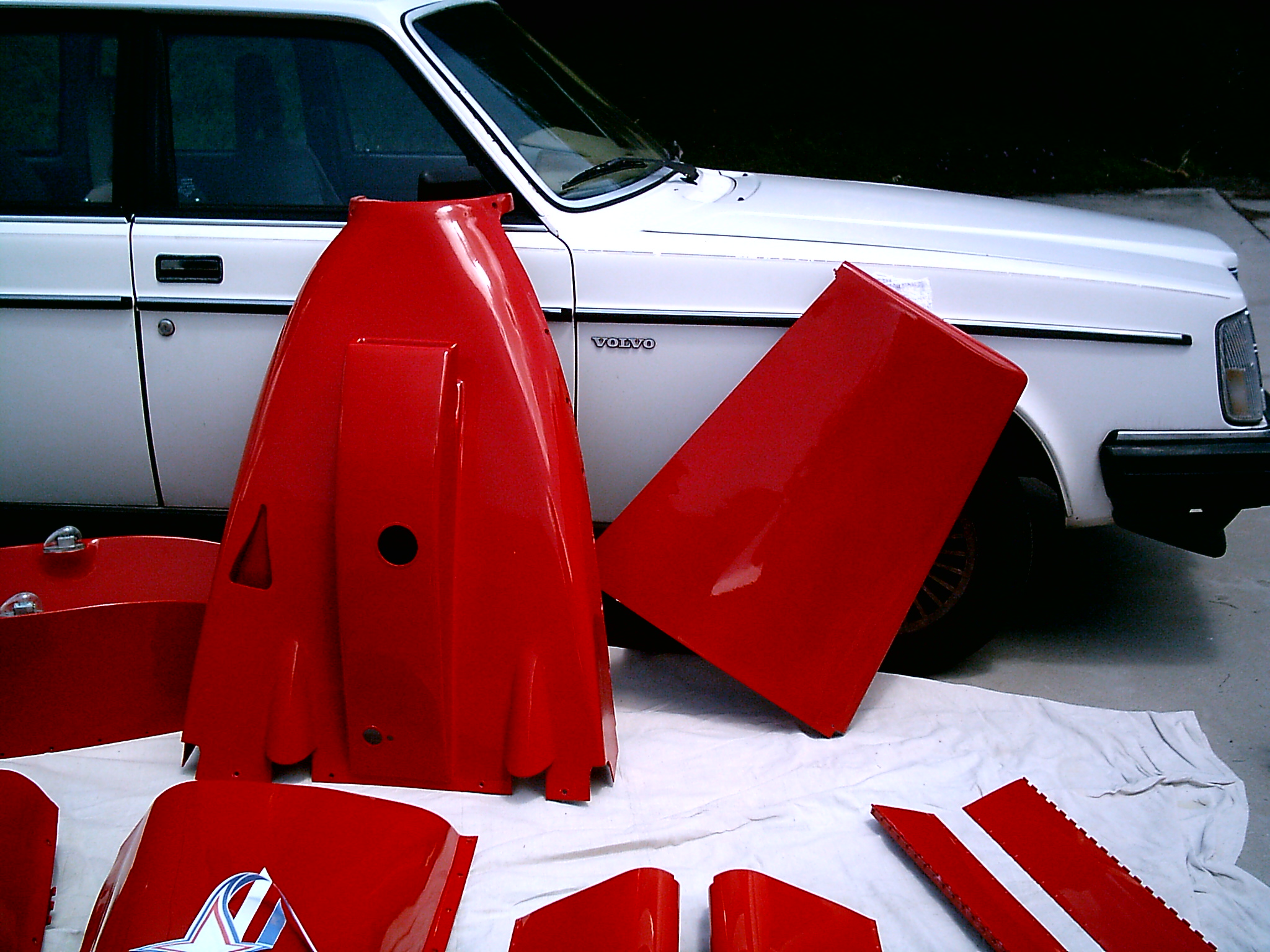

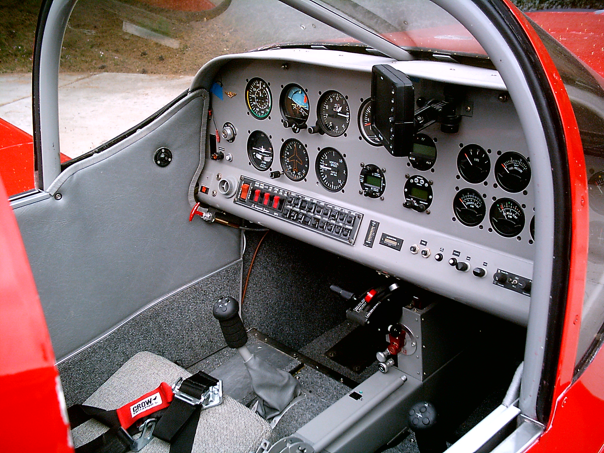

Two eyeball vents in lower dash , one is visible in lower left . NACA scoop on bottom of cowl . ??? No holes in canopy . Easy to adjust flow or direction . :P Blow air on face or up skirt ! BOOM !

Location: New Zealand
Nice looking bird there Rich! I have the eye balls as well and mine are on the engine side cowls (have updraft cooling so no heat exiting in standard place). Work perfectly well though our ave temps in summer are around 25 - 30 C.
Tony S 8) (can't do the affro thats your signature!)

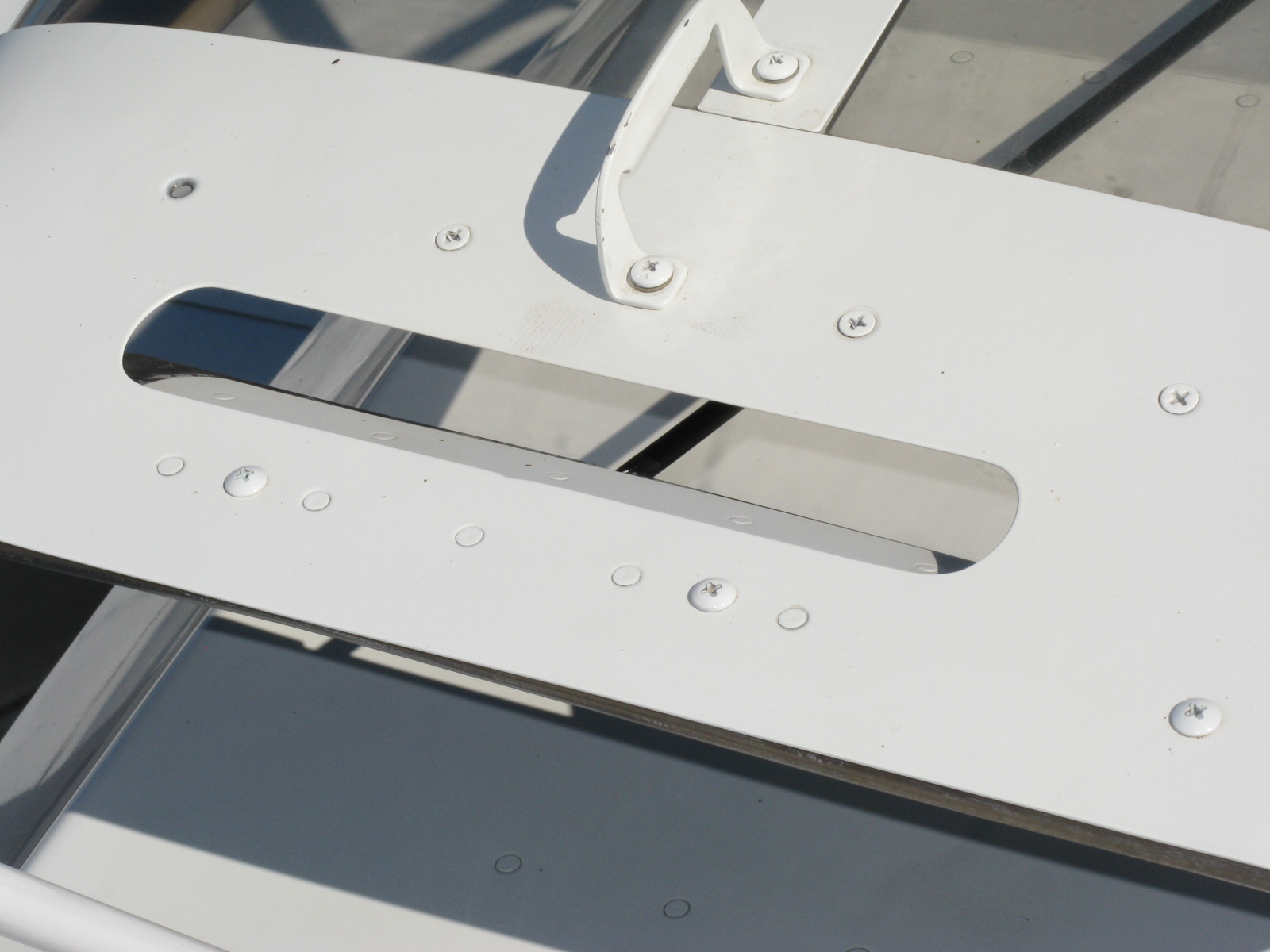

 Post subject: Re: canopy rear vent
PostPosted: Sun Nov 20, 2016 10:03 pm
Got my rear canopy vent installed. Took everybody's input stirred it all together and ended up with a 5" X 2" vent in the Plexiglas canopy. The reason I ended up with this is I have a canopy hold down for the rear of the canopy that will not allow the vent in the aluminum sheet. Some said start small so I did. I built a operating latch and lock out of billet aluminum, the only thing left is to fab a control rod to go between the two parts. Thank you all for your advise and help.
Phil
