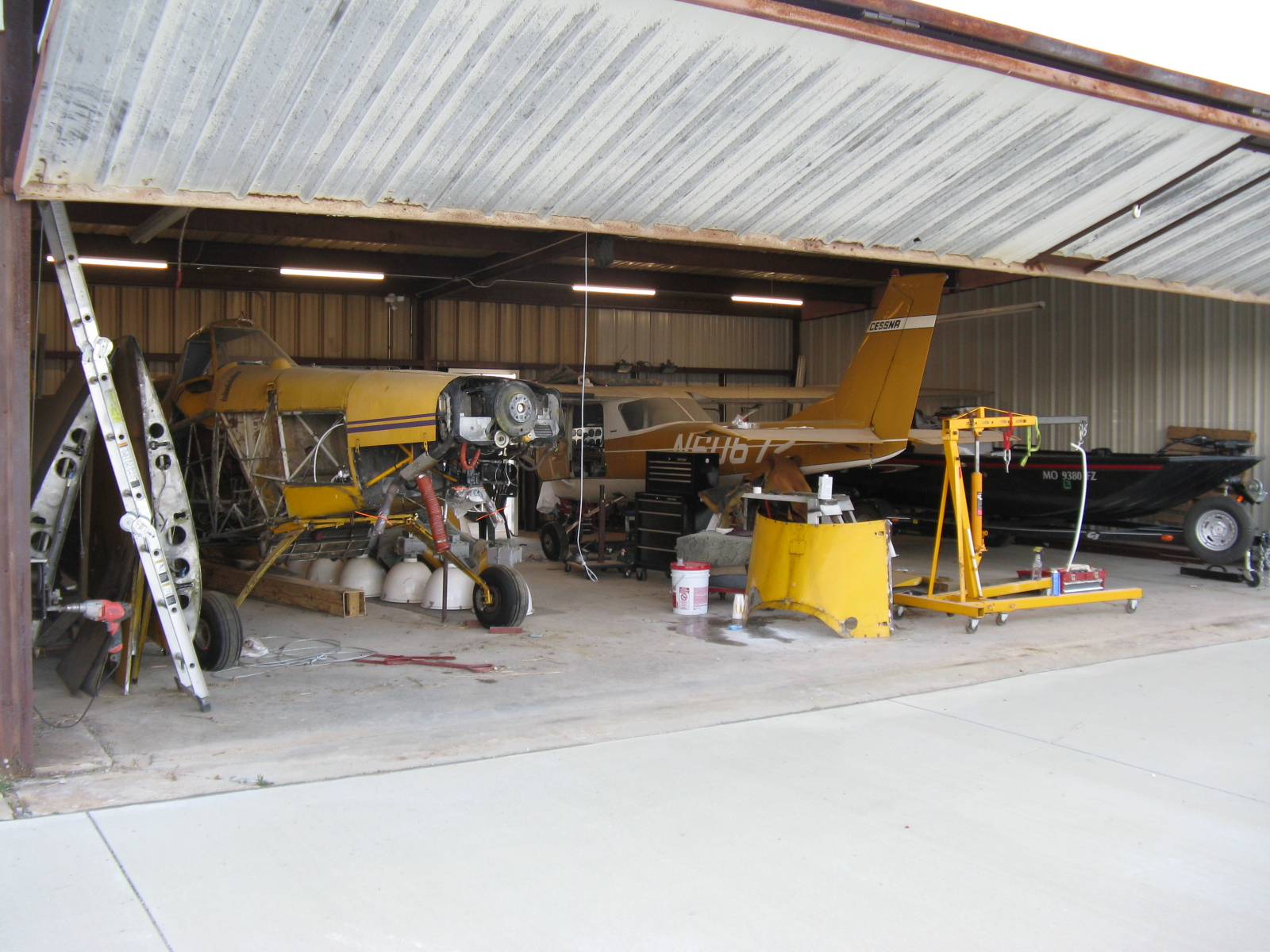

I was able to bring mine home today. My normal 9 hour drive was just a 2.5 hour flight today :D
File comment: Just had to figure out where to park it!

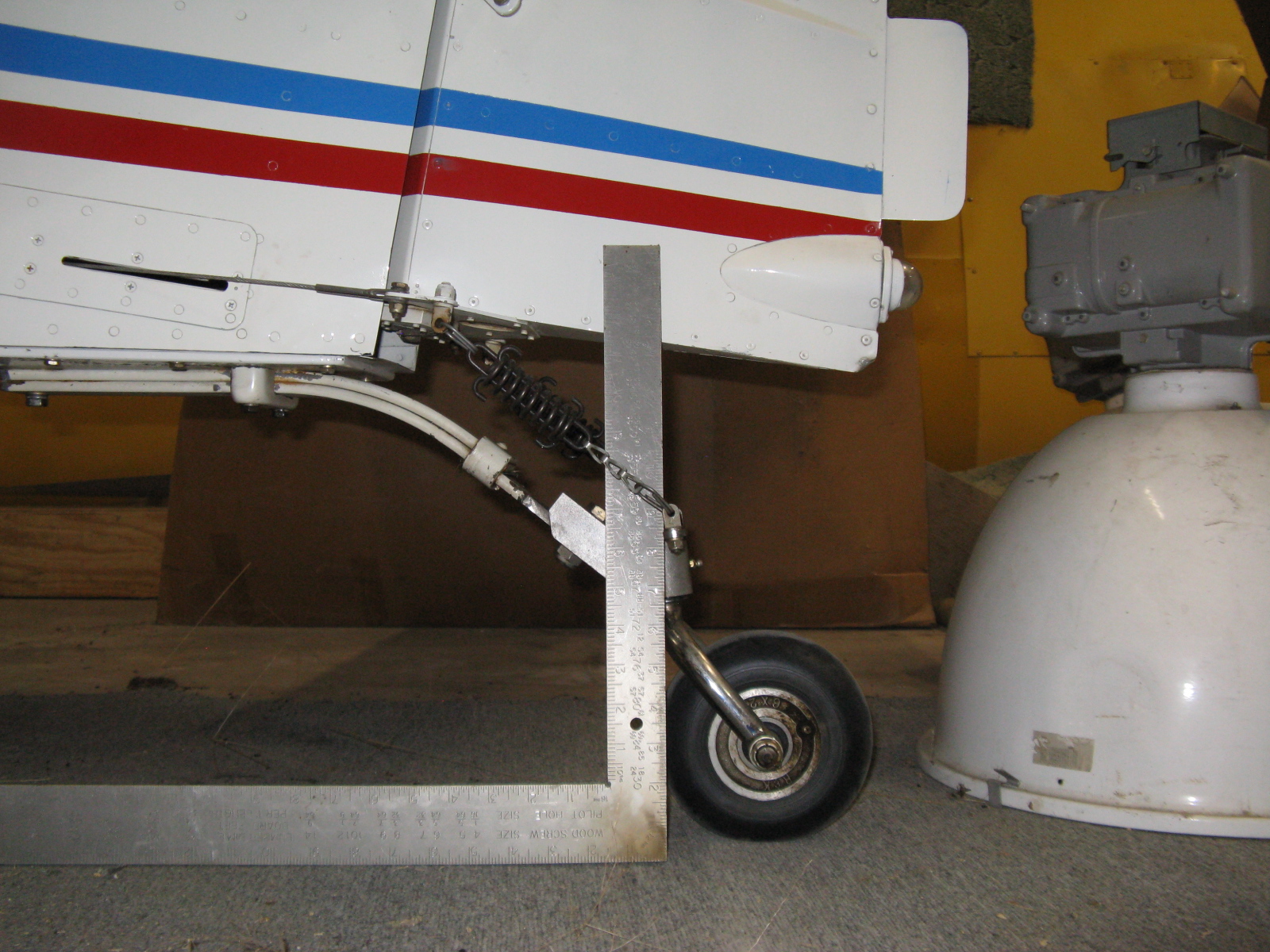

This is what got me asking questions. If the spring hasn't sprung then I expect I will be machining a shim to correct it.

Is this without pilot and passenger, luggage?
 Post subject: Re: 589 Tail Gear
PostPosted: Sat Nov 12, 2016 9:18 am
That is empty...maybe a half tank of fuel and 2 quarts of oil stashed under the seat! It should be vertical or even tipped the other direction a little. I am going to get another airport bum to climb on so I can see how it looks with some weight on it before I settle on a course of action but I like to know my options ahead of time. I will say I am not fond of the idea of switching to the tube spring. In addition to the CG question.... Spring+new TW assembly=$$$$$ I need for other things.

The trusty tube spring although longer is I believe lighter. So the change in CG is probably slight. But I guess that is the information you are looking to verify with real weights to prove it one way or the other.

Do you have a shimmy problem with the tailwheel as it current is?

That depends on your definition of "problem". It hasn't tried to shake me out of the aircraft or caused a loss of control yet but it shimmies. Some of that has to do with landing technique. I wheel land and generally keep the tailwheel off the ground as long as possible because it can't shimmy when it is off the ground. That habit came from flying aircraft with serious problems (ruin cables kind of problems).
The spring doesn't appear weak with a load...not that I would know how much flex is too much or too little but it seemed reasonable.
