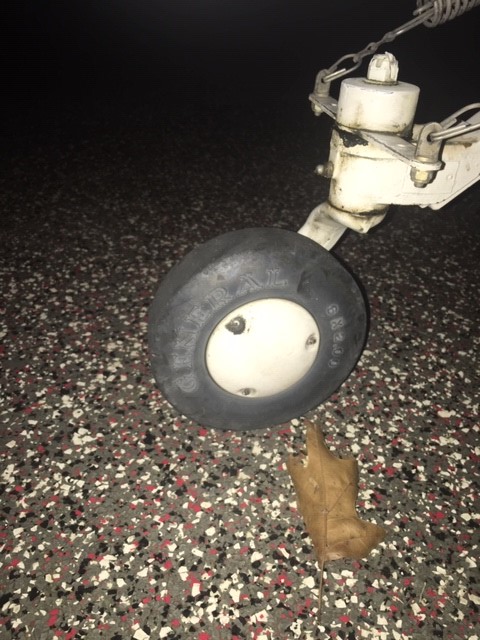

Anyone have a recommendation on tow bars for our planes?

That's my problem. I have an aircraft-tugs tow bar and it slips out turning when I pull it back into the hangar. Pushing it out is fine.

It depends ....... what tail wheel do you have on your aircraft.
That said, I have an Aviation Products 6" dual fork tail wheel. My hangar mate has a Citabria and a WagAero tow bar for his aircraft https://www.wagaero.com/ground-support/tow-bars/tailwheel-tow-bars/deluxe-tow-bar-using-a-scott-3000-series-tailwheel.html, said tow bar works for my aircraft, probably not the best my tail wheel axle is smaller than what is on the Citabria but it works.

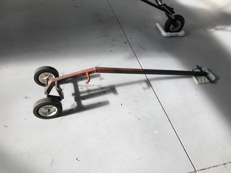

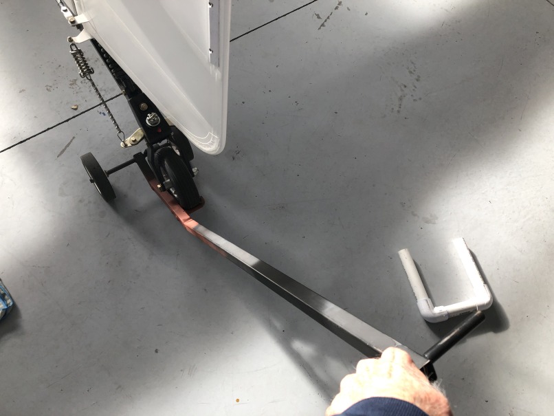

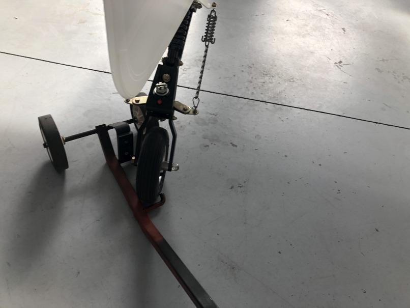

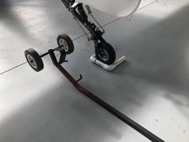

I made one out of 1" square tubing, 1/2" dia. steel rod, & a couple of cheap plastic/rubber wheels that worked super well with my T-18 (6" Scott , and then a 6" Aviation Products tailwheel). I modified it slightly for an 8" wheel and now use it with my Kitfox. Really inexpensive and easy to make. You slide it under the wheel as shown, then lift the wheel off the ground and move it around very easily.

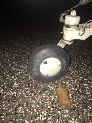

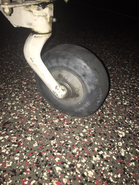

Thanks for the replies, I looked at bogert but they are $225 now, I don't mind paying but I want to make sure it will work.
