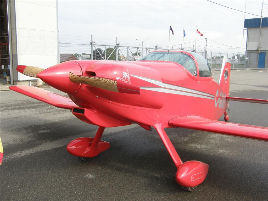

I was putting the wheel pants back on C-GABY (after 8 years of flying pantless) but realized that there is currently no way to get to the tire valve to check or add air with removing the pant.
What are you guys doing to deal with that?
Thanks...

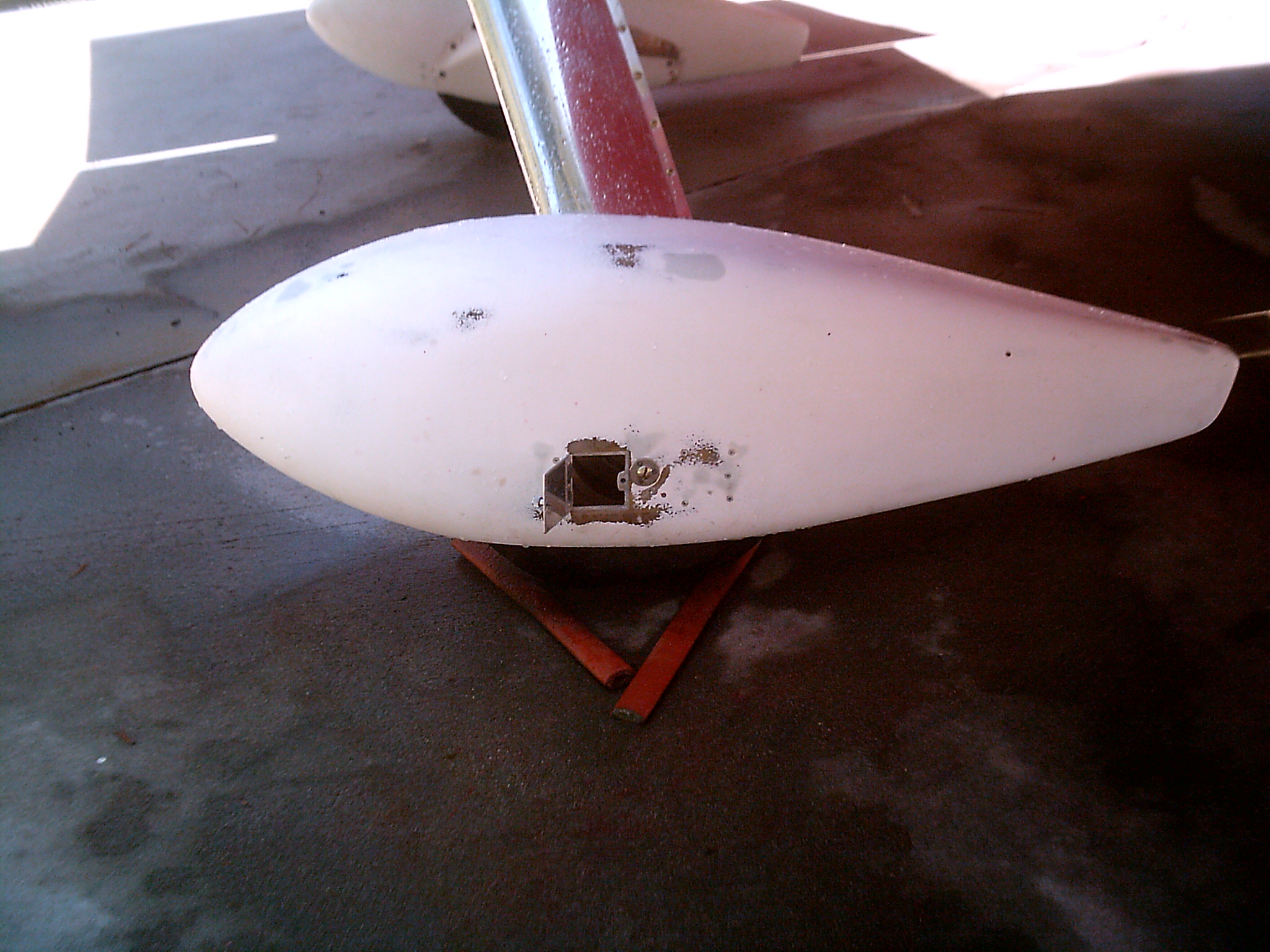

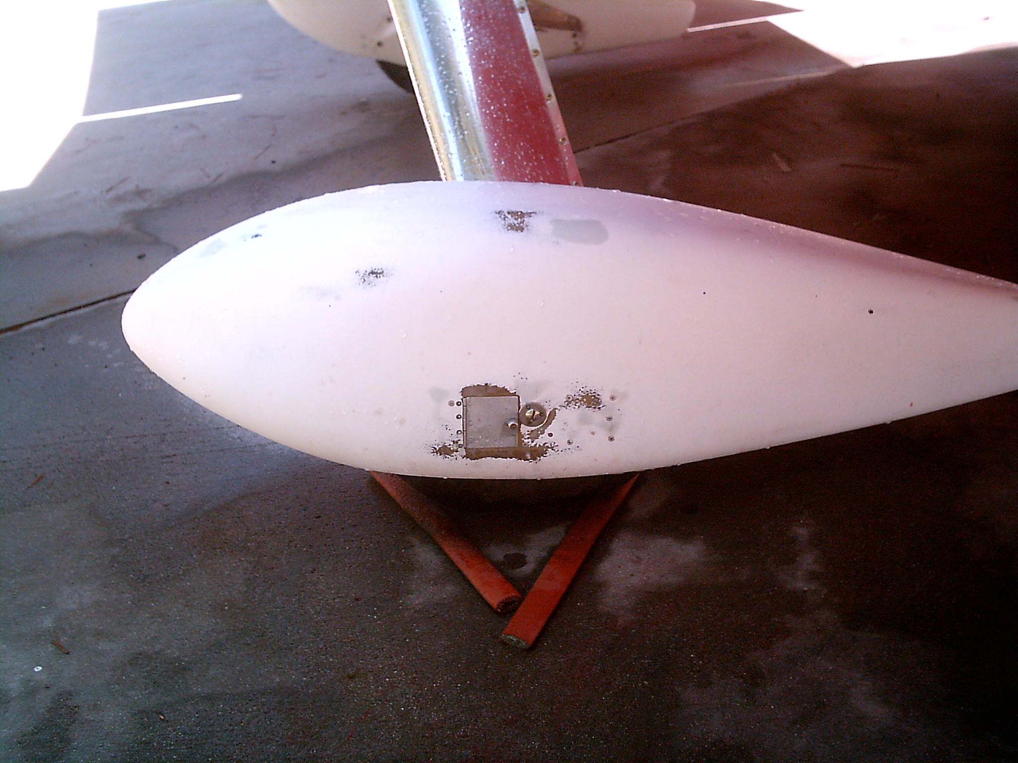

I put in a door . BOOM !
