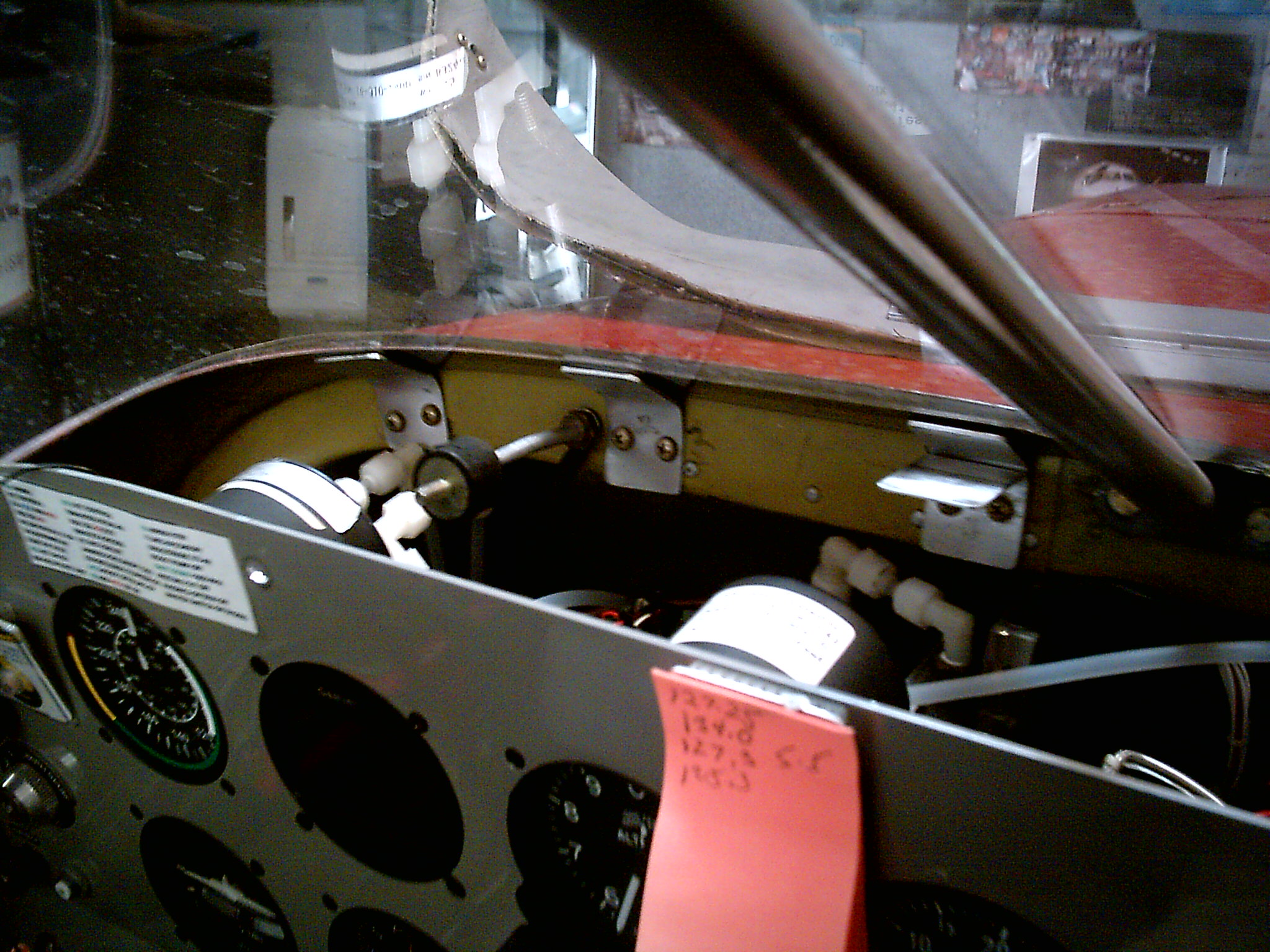

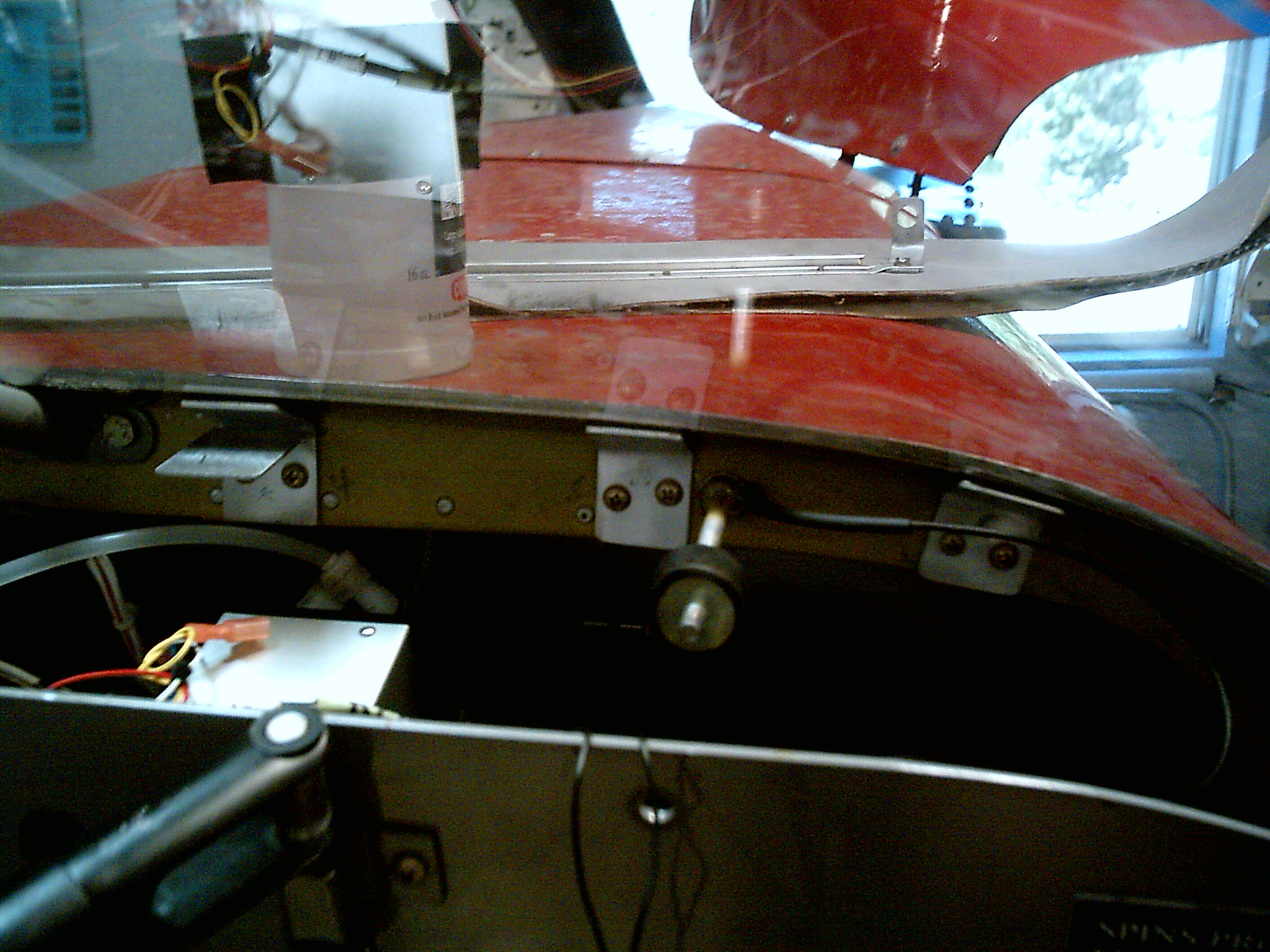

 Post subject: Re: nutserts
PostPosted: Mon Jul 06, 2015 3:38 pm
Posts: 3117
To hell with the nuts ! I stole this idea from Dan . Only four screws on each side of the fus. to hold the glass . The "clips" did a great job and along with the EPDM WX strip no leaks ! ??? In addition no need for the external trim strip on the lower edge of the wind screen . ;)
