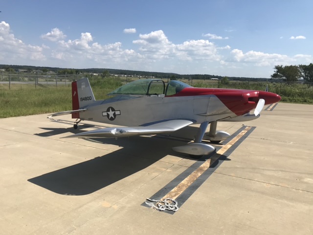

Is this one considered a cheek cowl? download/file.php?id=2477&mode=view
If it is then I stand corrected. It is the only style I have seen in person (4 airplanes- I had forgotten about the one based at Vinita).
That looks like a Ratray cowl. They were relatively popular, but heavy compared to the original, & (I believe) most popular cowl design seen on T-18s. You can call it a “cheek” cowl if you want to, I suppose, but the original cowl designed by John Thorp, is a 4-piece cowl. The “cheeks” are easily removed individually for pre-flight inspections, etc.
