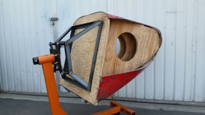

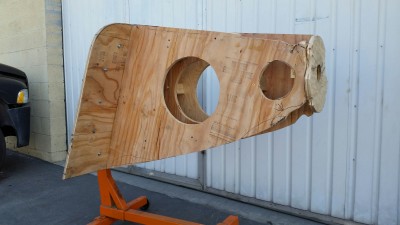

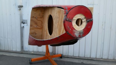

I've been working on building a buck for aluminum cowlings. Somebody asked me to post this, so here's step one: The Buck
Next step is making patterns.
Here's some pics:
