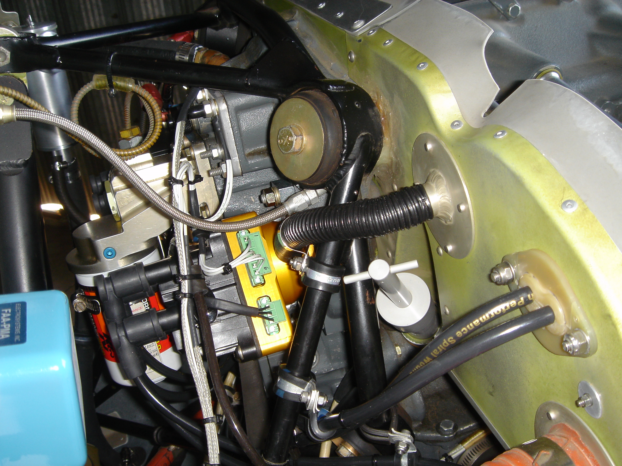

I had a similar problem, & machined a new tube out of 2024-T3. Then I also made a new dipstick assembly with an extended handle to make it easy to grab & use. Then I chromic acid anodized both in my own home-made anodizing tank. I used an o-ring on the dipstick & cut my own silicone rubber gasket for the engine to tube joint, which has worked well for 23 years. This picture was taken when I had "P-Mags". I've since reverted back to conventional mags.
PostPosted: Thu May 16, 2013 7:00 am
that's a pretty elegant solution, john. I especially like the extended handle because the short tube makes it difficult to reach.
PostPosted: Thu May 16, 2013 7:58 am
Good Grief John!!, that thing looks like it was built in a sterilized surgery room with purified air abounding,a team of polish and shine folks fast at work, dust collectors running full blast and the floor continuously being mopped with anti bacterial solution so as not to get the Lyc dirty. Ive seen some clean engines before mostly at car shows, you need to go on tour and show em how its done this thing puts to shame the best of em in a heartbeat, don't you guys have dirt and dust in Colorado!! Dan
PostPosted: Thu May 16, 2013 5:07 pm
Dirt and dust is not allowed in Colorado ! :o John lands at an airport prior to his scheduled arrival and has the engine detailed ! BOOM !
