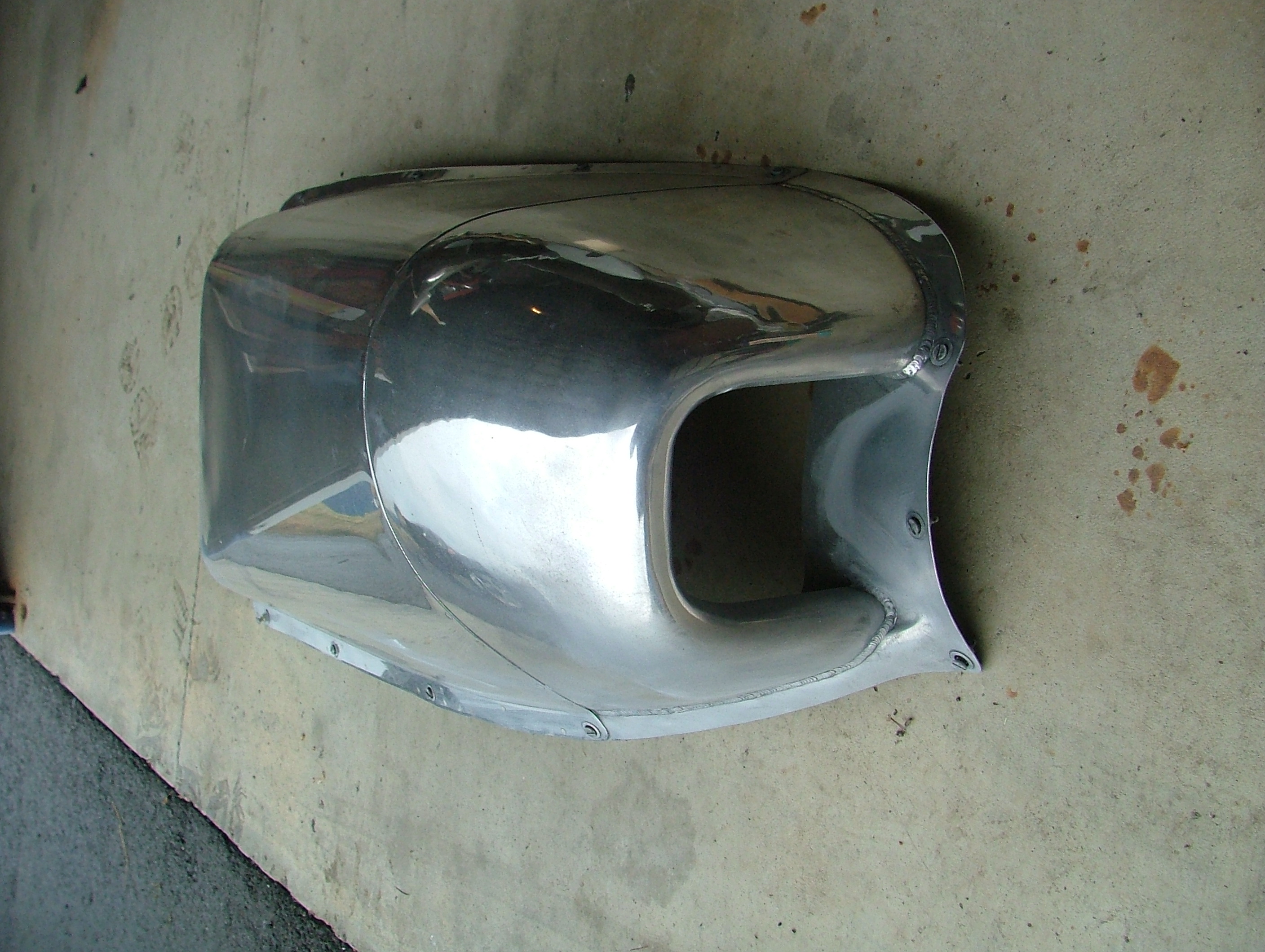

Have read much about the efficiency and beauty of the original metal cowling built by John Thorp. Have searched this and the prior site but haven't yet been able to find any pictures. If someone has a pic or two can you share?

This is Bob's and I just after we completed making the metal cowls on our Thorps. We found that the temperatures dropped 50 plus degrees as opposed to the fiberglas cowls

Bob and I made our "buck" using the old fiberglass cowl, never really took a measurement though. If you look at a Thorp cowl the intakes are slanted back a few degrees at the bottom. This yields a bigger opening in climb and closes down slightly in cruise from the tail high attitude in flight. For the cooler temperatures, I believe this is a result of aluminum transferring the heat better than glass, remember they use glass as an insulator on exhaust.

I'll dig the buck out of the back of the hanger and post a picture. The front "bowl" is three pieces. We made the complete front bowl, and cut it in two after it was welded. As a side note, the top, bottom and cheeks are a flat wrap. There is some forming around the spinner area and lower cowl panels. Considerable annealing was done to form the parts from 6061 and 5052 aluminum. We used a 1" wide magic marker to paint the metal and using a torch burned it off. It will go back hard in a day or two.
