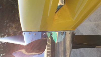

I have the Aircraft Spruce MC-4 nose bowl with the MC-5 bottom pan. The spinner is a BN-3 from Spruce also. The cowl was slightly larger than spinner trailing edge, so did some work on cowl to make it match spinner. The cooling air inlets were closed up a bit and the bottom pan was modified with the exhaust outlets and ram air intake.

One of the nicest T-18's I've seen !
