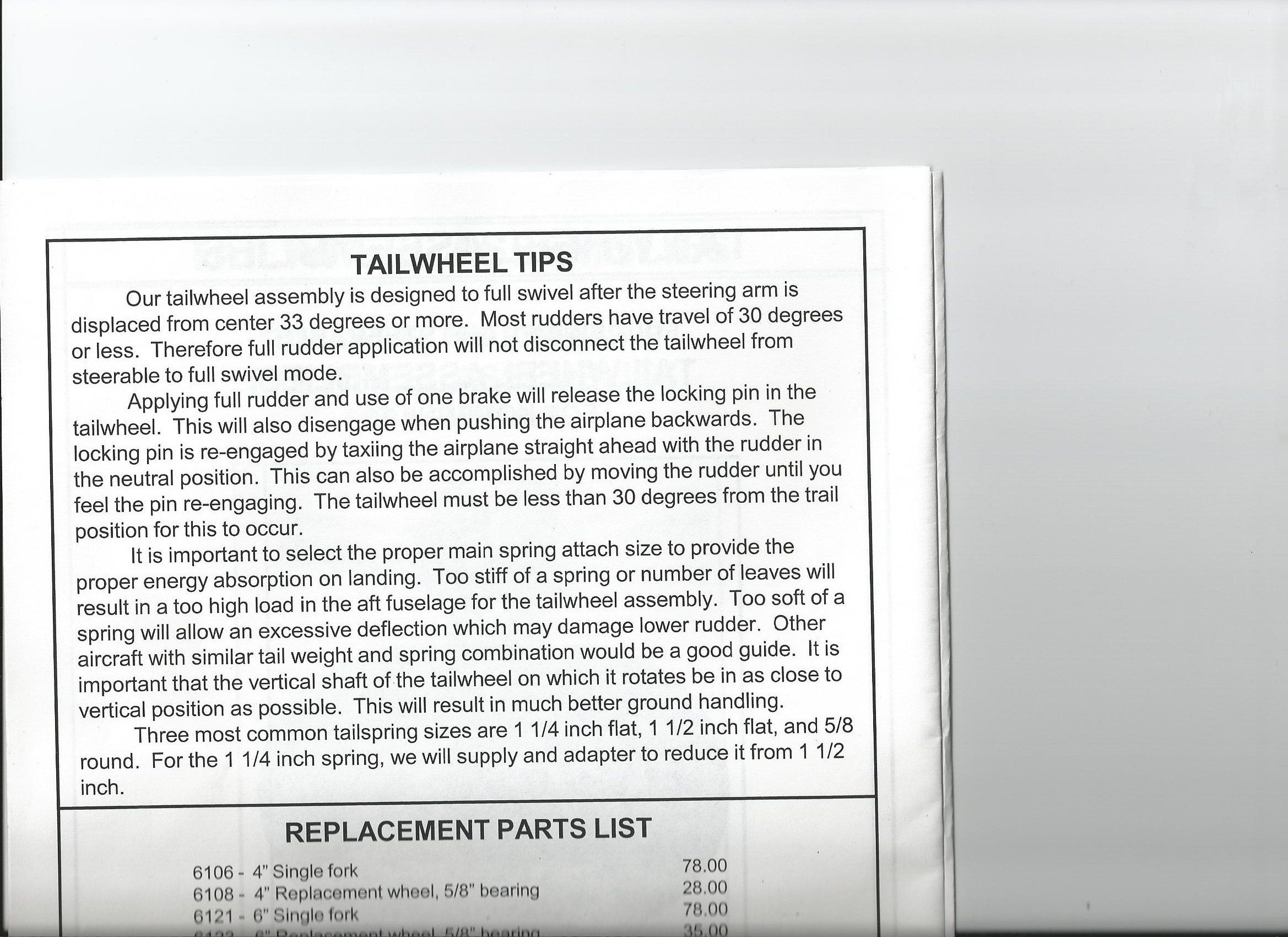

Rich, does the ap tail wheel have the detent on it?

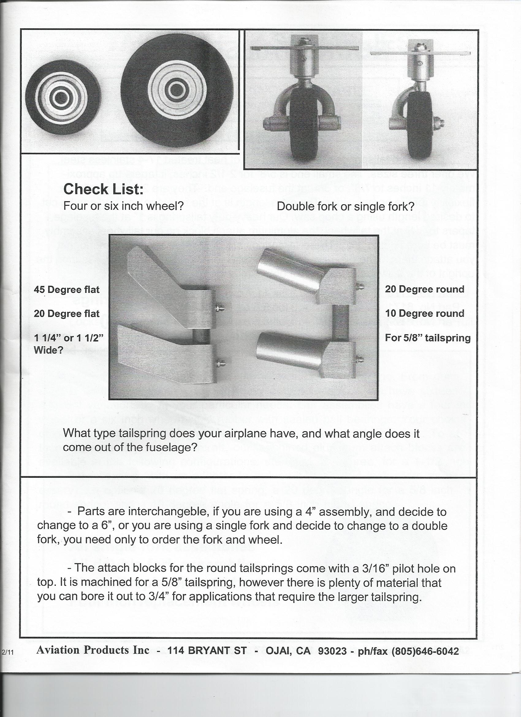

Not sure what you mean by detent ? Attached is a write up about the AP tail wheel from AP . You can order the wheel directly from AP . I think 99% of us replace the "standard" AP wheel bearings with up graded bearings .
