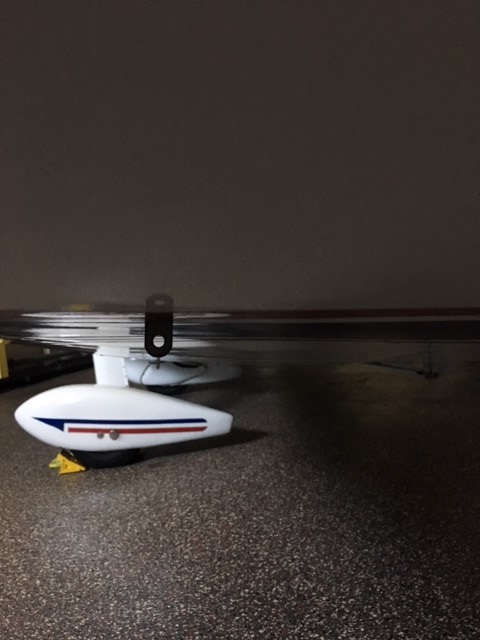

What do you all use for your tie downs, assuming they are small like mine. The normal ropes and chains at most airports won't fit in the little hole, my thought was to use some sort of carabiner?

Good idea but my holes are very small - maybe 1/4"

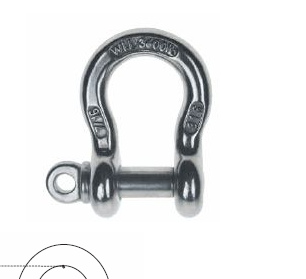

Good info - thinking of something like this:

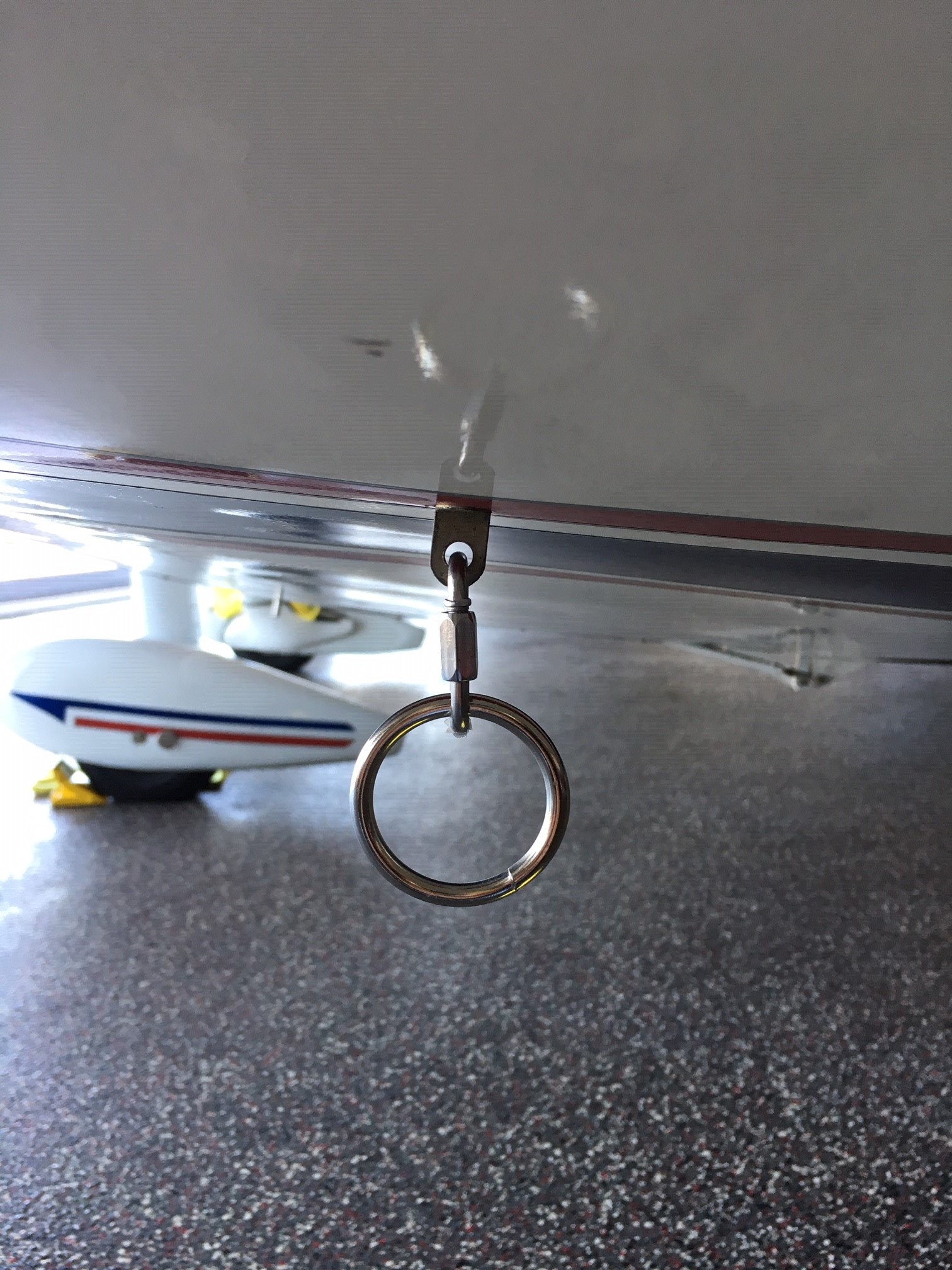

Ended up doing this - 1/8" 480lb SS quick link with a 200lb ring. Had to drill the hole out to 7/32 as it was only 3/16
