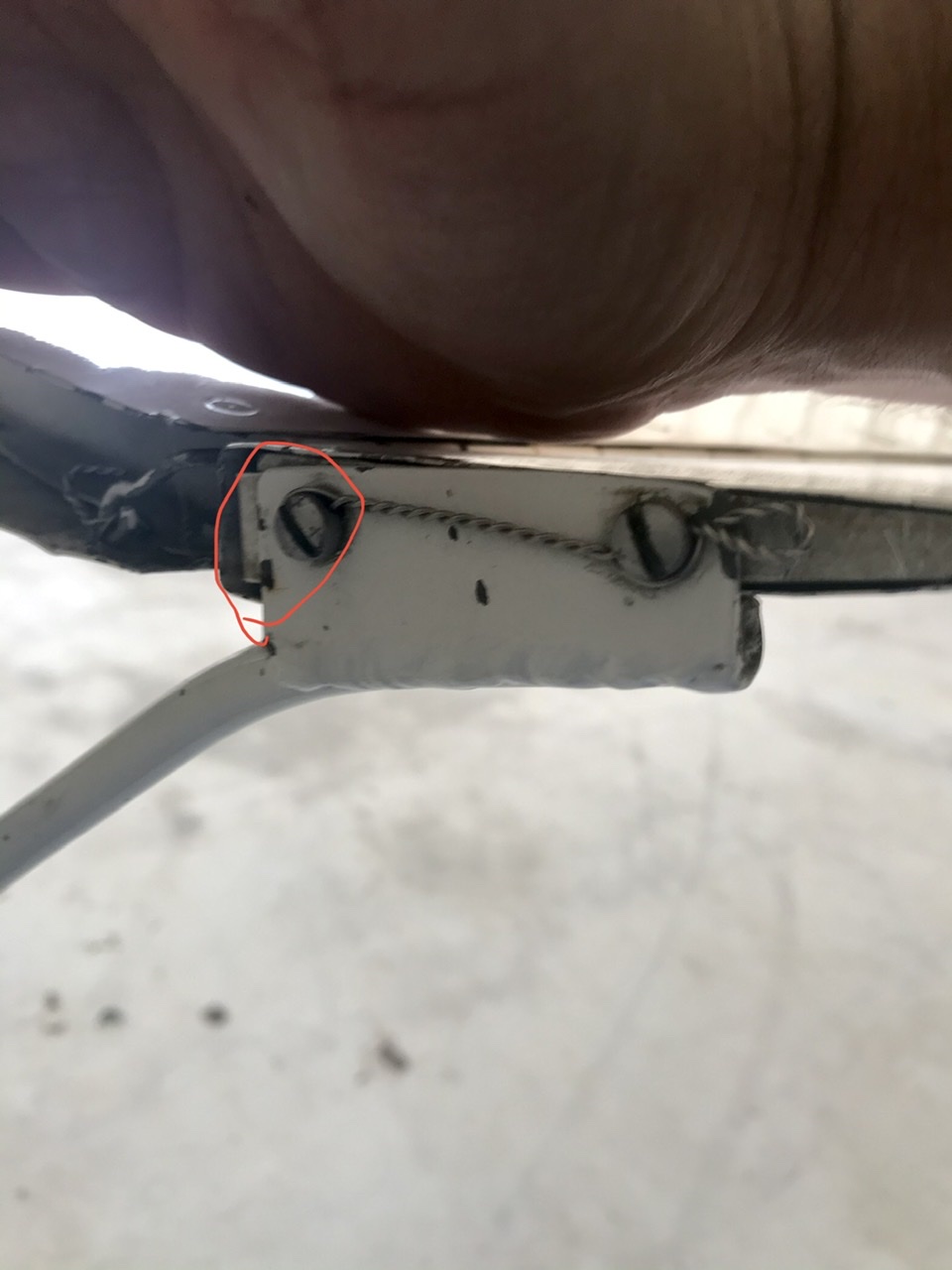

Couple of questions...actually a question and a request:
Lee, do I have anything to worry about with my airplane?
And, if someone would be kind enough to post a few photos of where to look for what, I would be eternally grateful.
Philip Mandel
N118BC
S/N 957
Beaverton OR

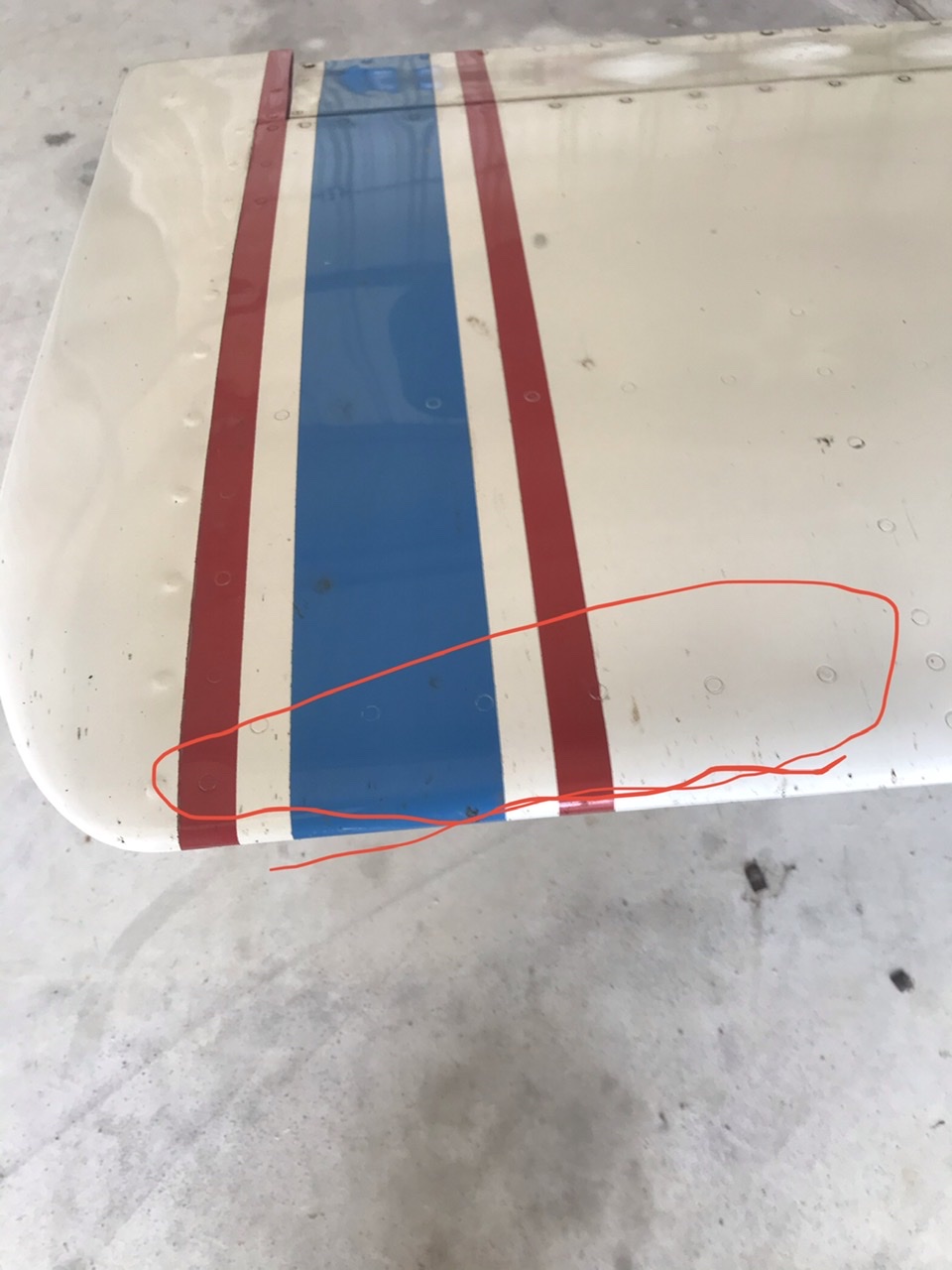

PostPosted: Sun Sep 20, 2020 3:09 pm
The first picture shows the bend in the stainless steel strap where it turns and tucks behind the tab’s leading edge. It is sandwiched between the tab and the tab arm. It also has 2 rivets shared with the hinge along the front.
The second picture shows a row of rivets associated with having weights inside the leading edge. Mine has rivets visible on both the top and bottom.
