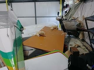

Back in August of 2018, my faithful old T-18C, N58K, was damaged in a crazy accident. A Bonanza owner down the taxiway from me started his airplane at full throttle and for some reason couldn't reduce power or hold it with the brakes, so it hit the side of my hangar going about 30-40 mph(according to an eyewitness). The propeller chewed through the hangar wall, and the corner column stopped the airplane just in time to prevent complete destruction of my Thorp. The prop got the right wingtip, but not the wing structure. However, when it hit the column, it spun the Bonanza to the right and the left wing slapped the side of the hangar. On the inside of the wall where the wing hit were shelves holding some heavy Drake ham radios, and also leaning against this wall were 2 4x8 sheets of 3/4 plywood that went flying across the right wing of the Thorp, doing some minor damage and then hitting the right fuselage side, putting two dents in it. The worst damage was to the stabilator. One of the Drake radios (which weighs about 15 lbs.) landed on the right stabilator tip, and then poked a hole in the right trim tab. The stabilator itself doesn't have a mark on it, but a laser says the right side is bent down about 3/16 inch at the tip rib. A smart level shows about .3 degrees bend.

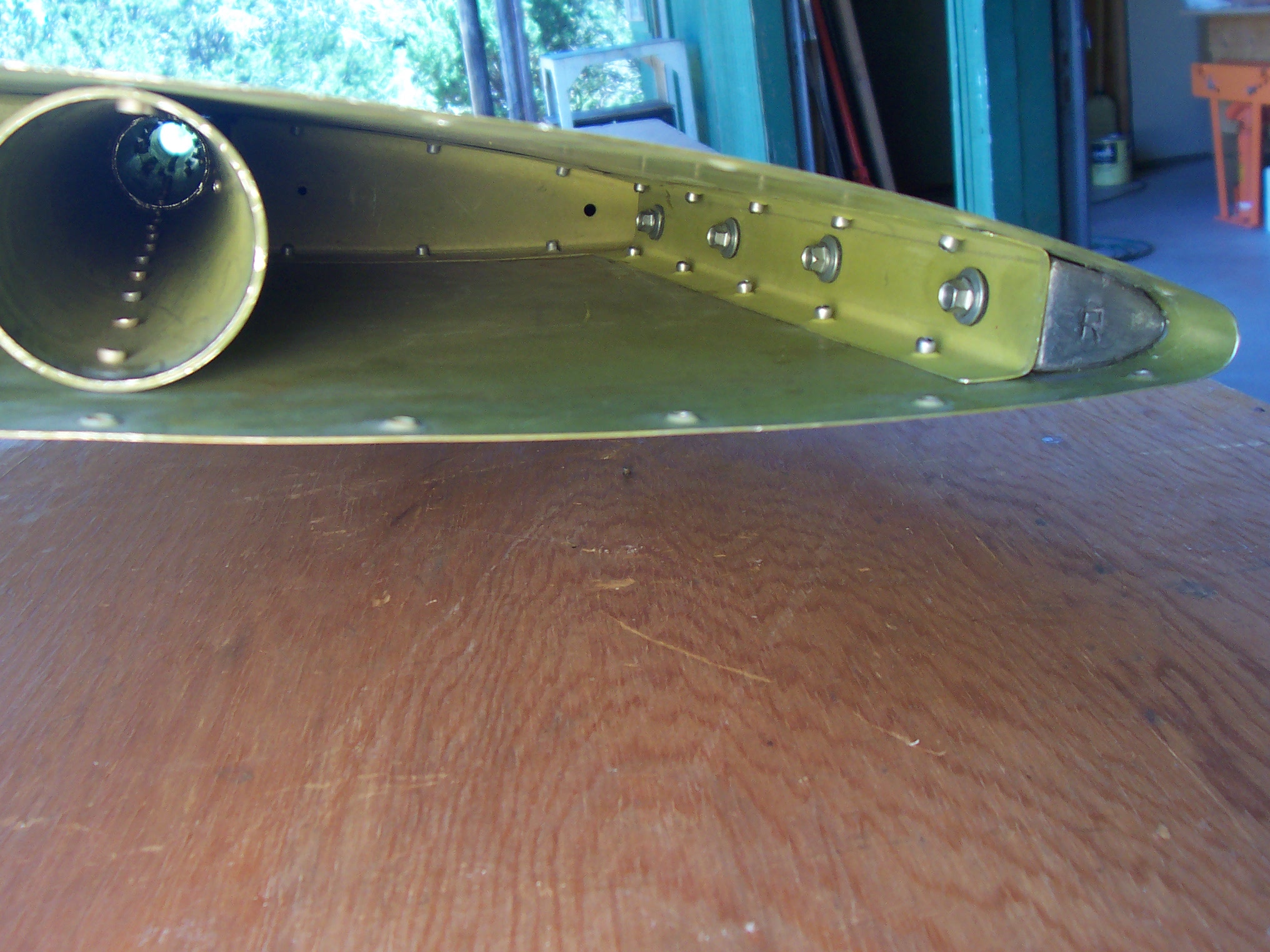

Wow, what a freak accident. To reply, I'd like to say that the stabilator isn't a hard thing to build. The only challenge is bucking rivets for the extra stiffener tube that goes inside the stabilator spar tube. It's a required safety item, but skins are also attached here too. For that, I used a long solid heavy round bar with a flat filed at top, along its length. It should extend beyond the stabilator on both ends. Support it and the whole 'clecoed' assembly between two saw horses, certain that there's no twist in the skins. Start with innermost rivets and work outward. Form and inspect the 'shop' head on each rivet with a small mirror and flashlight before going to the next. You'll have to pull the bar out and reinsert it quite often. Leading-edge weights are also installed for completion. As you've certainly read, stabilator installation and proper adjustment of trim tabs is important, but you'll see it's not difficult.
