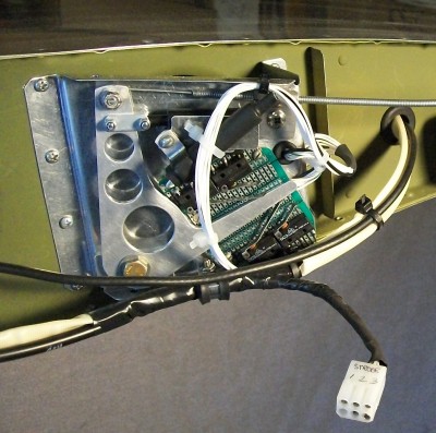

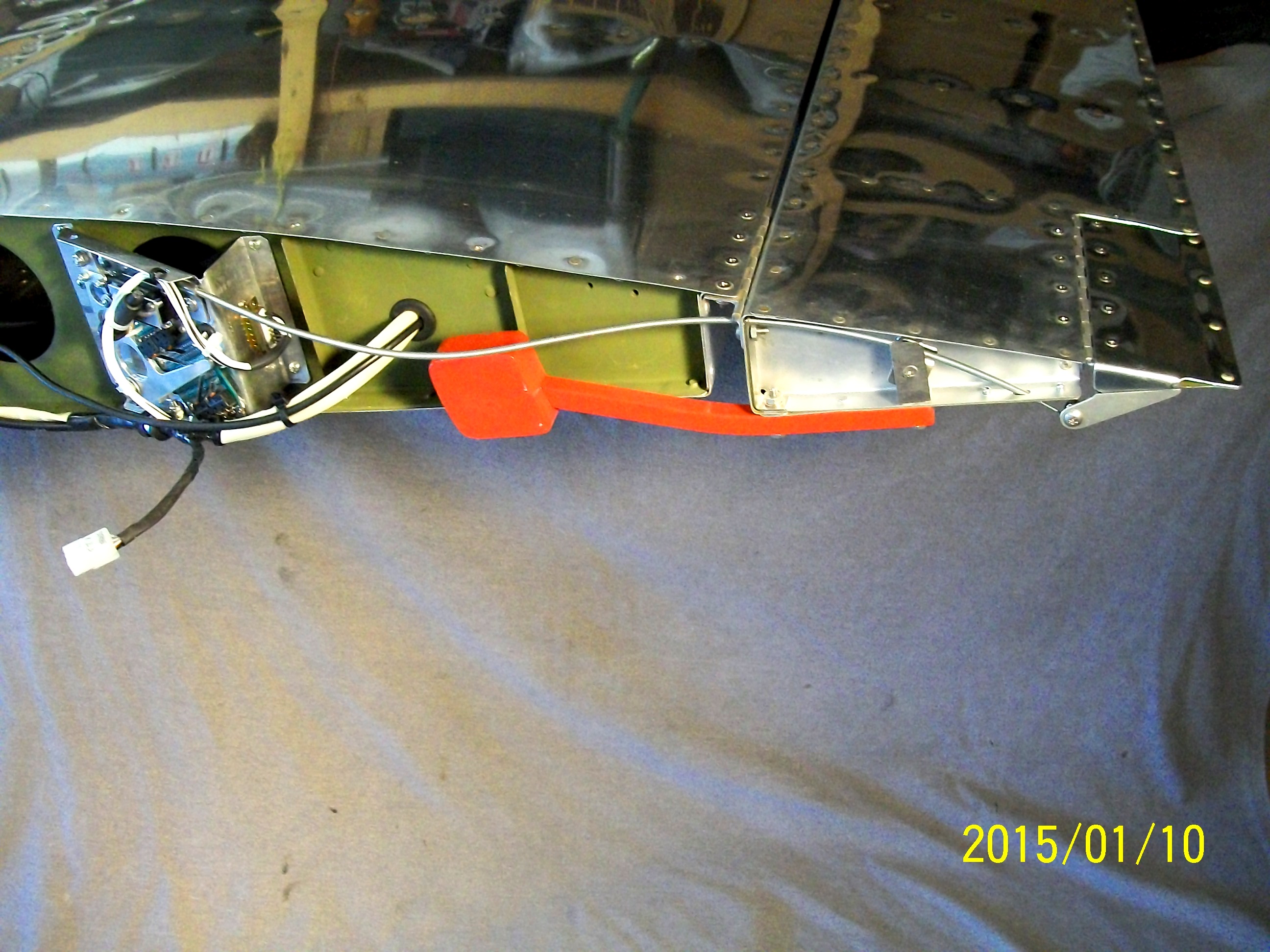

Roll trim complete: I love this whiz bang mechanical gizmo stuff - maybe others do too. I think that's why this topic is popular. Gear motor is Frigelli P/N PQ12-100-12-P, good speed with 100:1 Ratio. Cable passes through hinge line and anchored on aileron side. Motor bracke on angle creates clearance in cable for moving balance weight. No wires to bend, no extra weight on aileron, no bending moment.
Les Krumel,
Albuquerque
