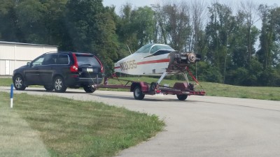

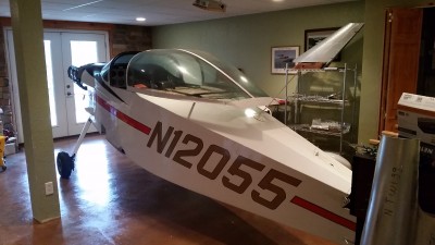

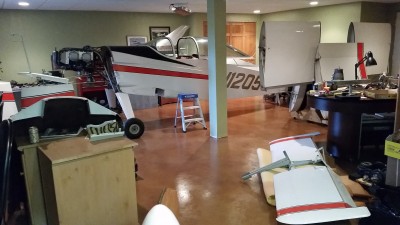

I saw N12055 at my EAA Chapter 45 picnic. Saw it on a Sunday and bought it the next day. It hadn't flown in approximately 12 years. Always hanger-kept. There is only one small dent on the aircraft after 50 years. It has 193 hours on the tach with an O-290D on the front. We bore-scoped the cylinders and they were in amazing condition. Don't know about the cam yet. I am changing the oil this weekend and send it off for analysis. I plan on starting the engine in January.
My EAA buddies helped me tear it down and drag it home. Since it's arrival, I've been replacing rubber things and finding out that little things that should move - like a fuel selector valve - didn't move at all. So the replacement process began.

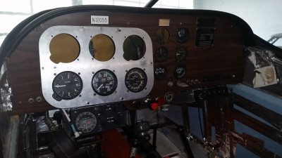

More detail: N12055 has, as best I can tell, a standard wing. It is set up for day VFR with no landing light or instrument lights. Basic instrumentation is used and I will keep the steam gauges for now until I get some experience flying a tailwheel aircraft and this one in particular. After that, I'll convert N12055 to EFIS over another winter.
File comment: The panel at the time of purchase

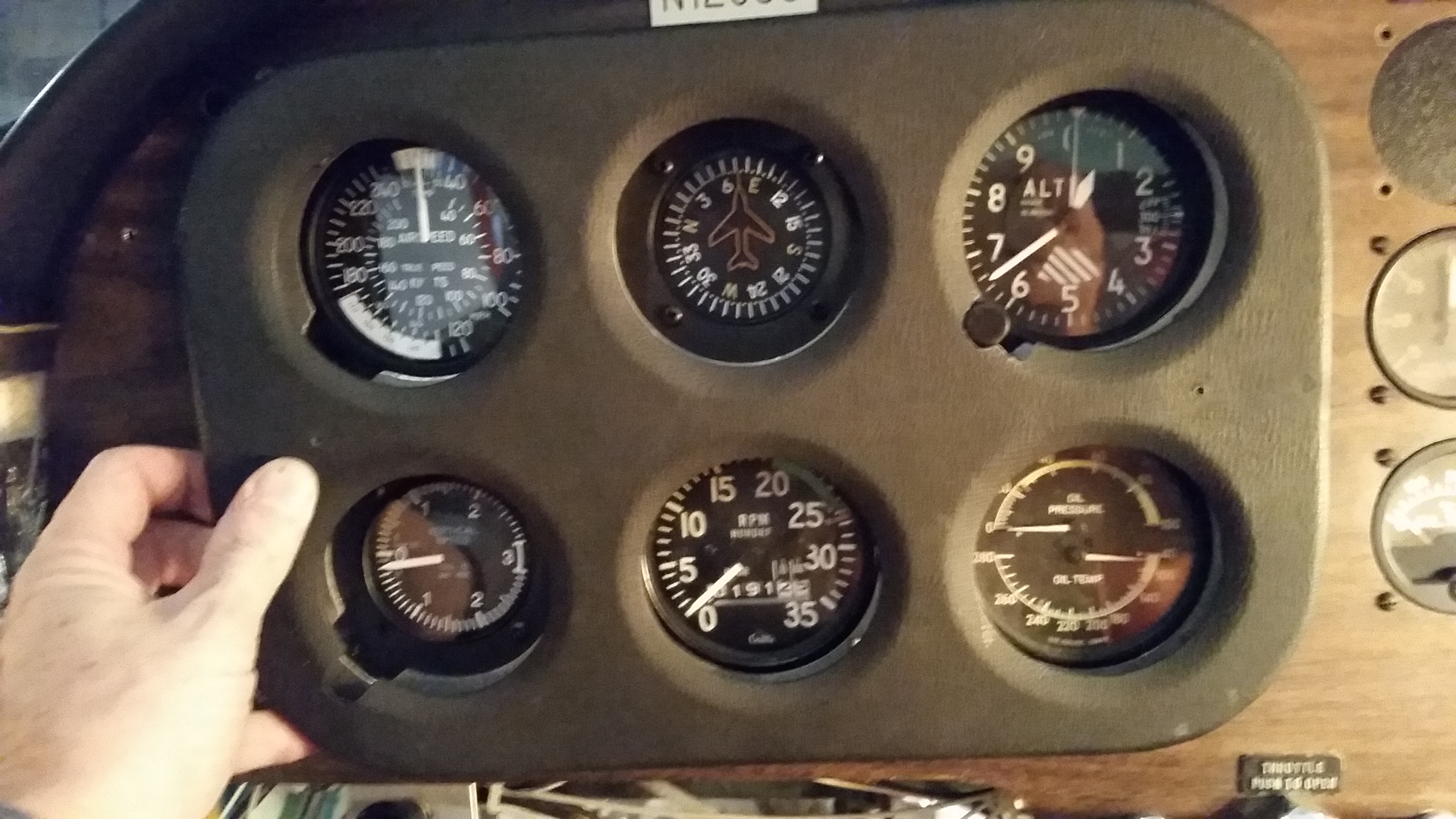

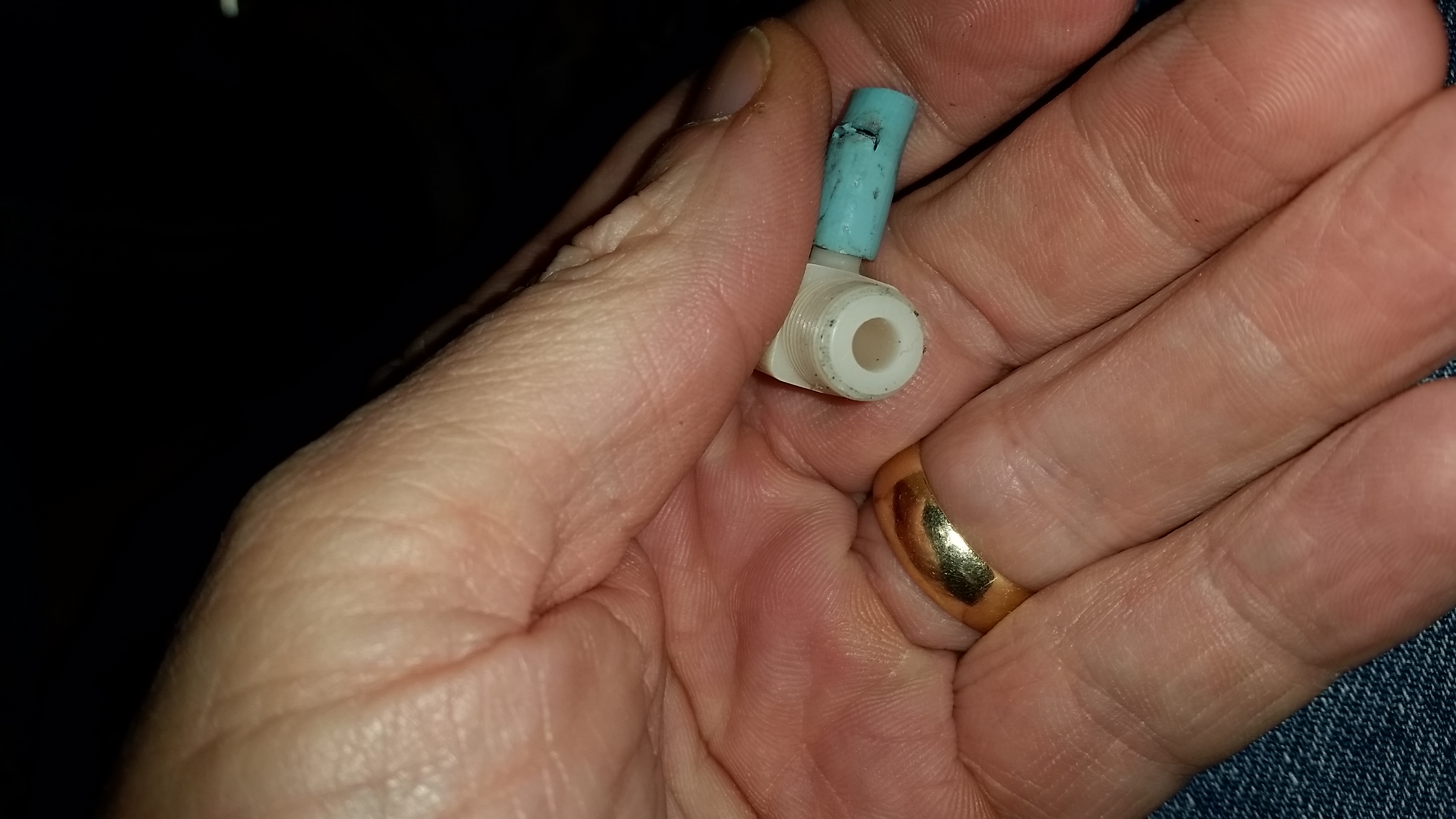

I've begun to change out what is there to newer instruments that I had hanging around. For newbies, I found out that all tubing needs inspected and that you can't assume it's flight worthy. For example, there was a damaged pitot line (very flexible and rubbery) that I couldn't see until I removed the old instrument.
