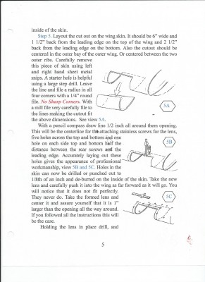

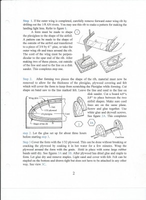

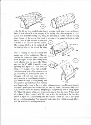

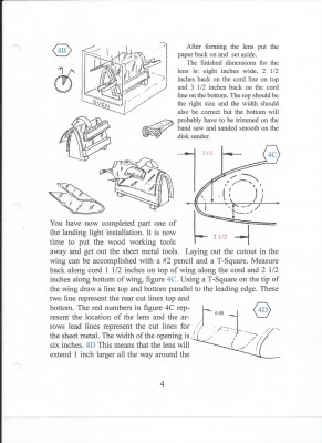

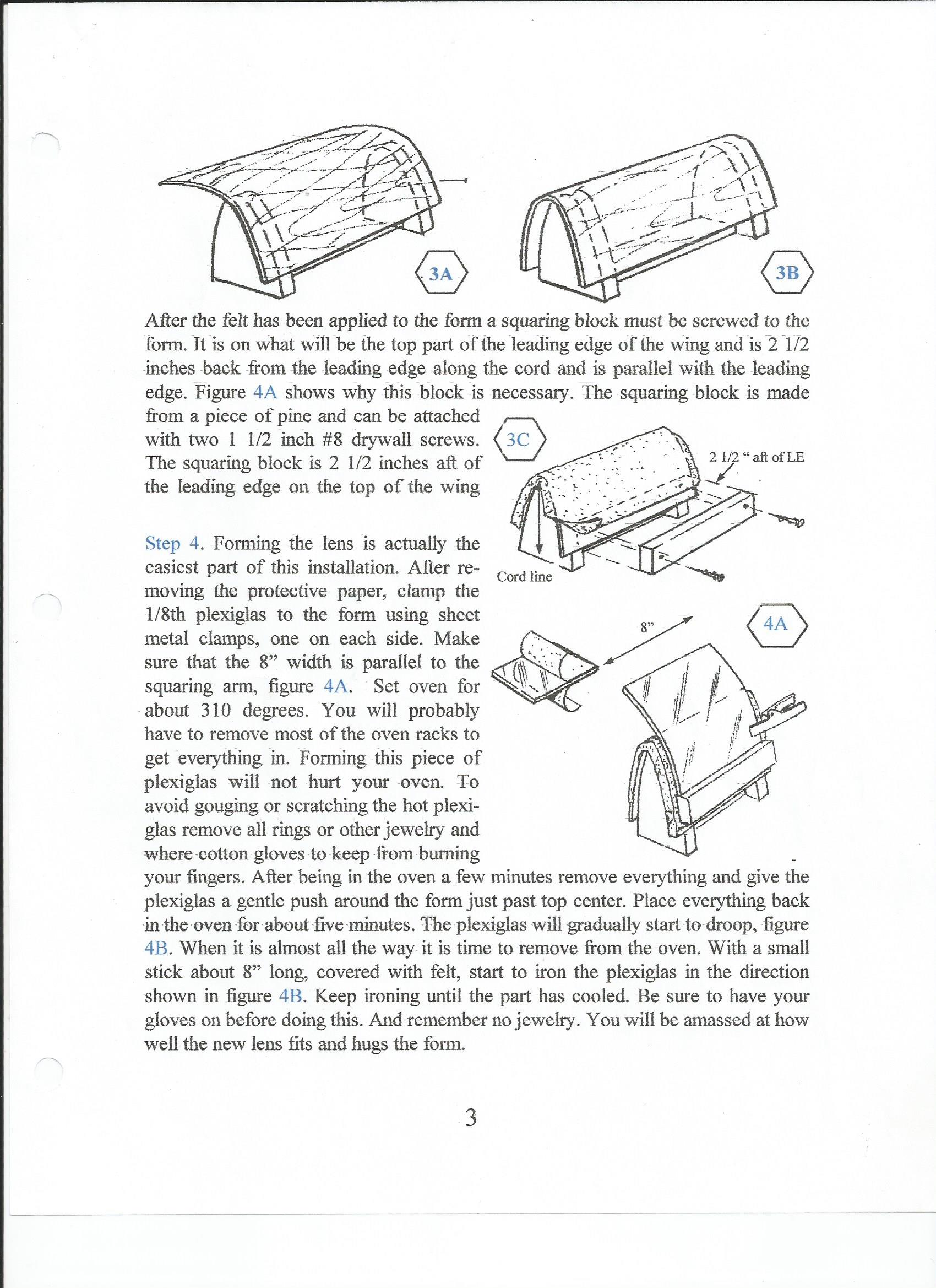

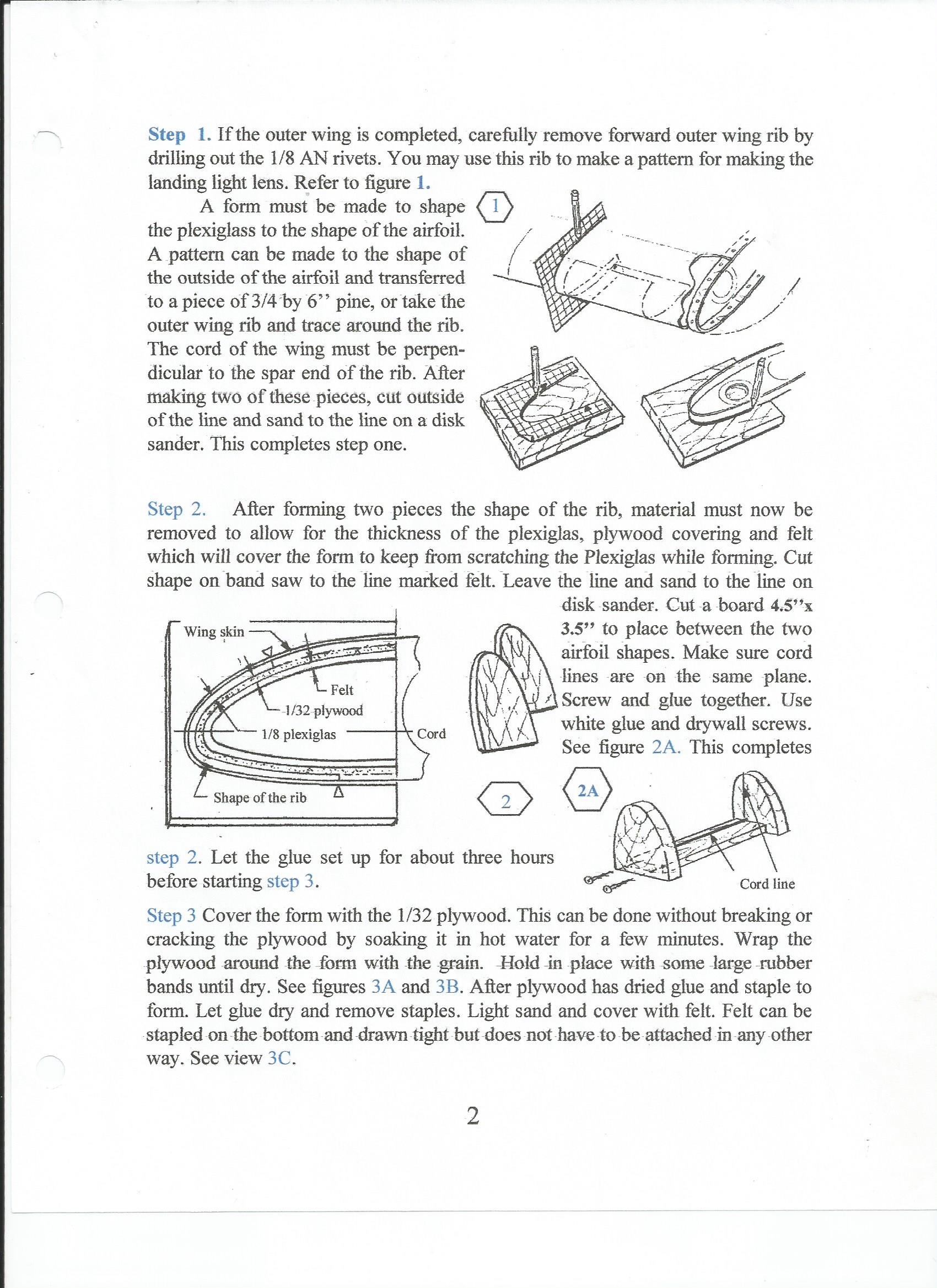

PostPosted: Fri Apr 05, 2019 8:31 pm

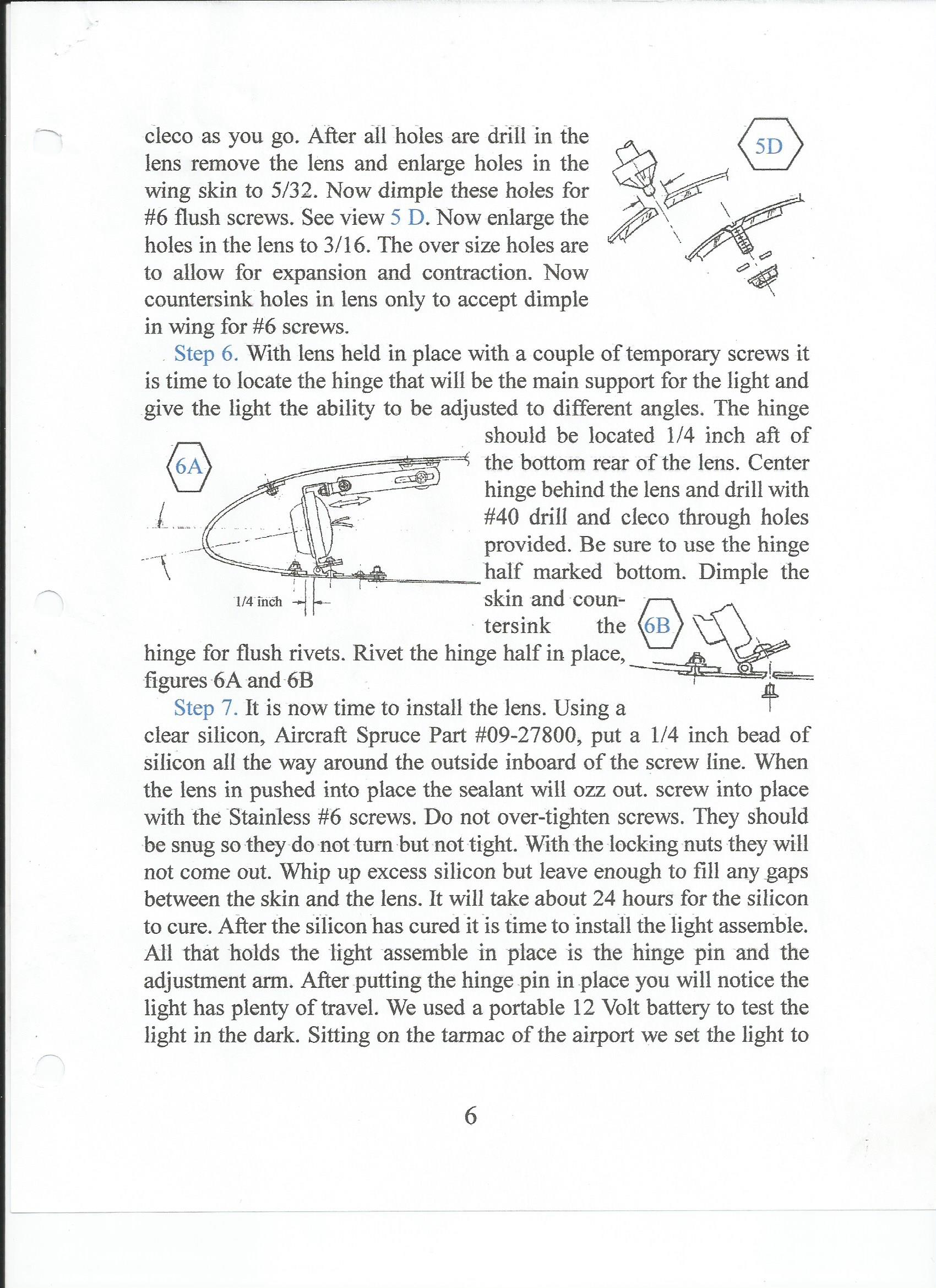

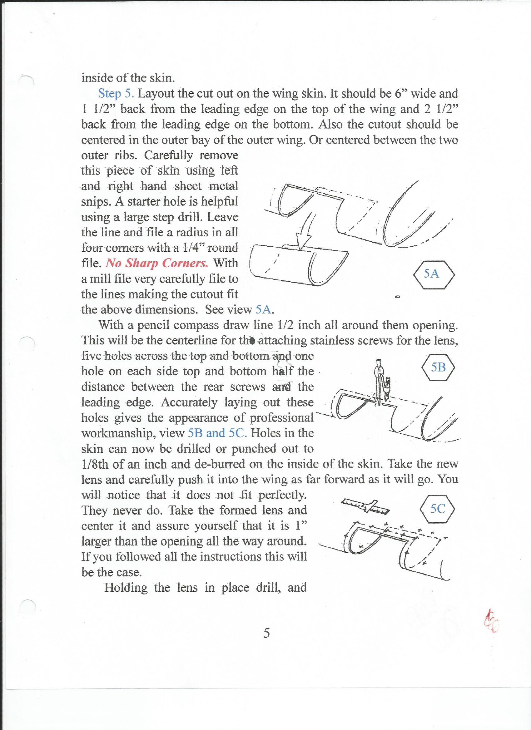

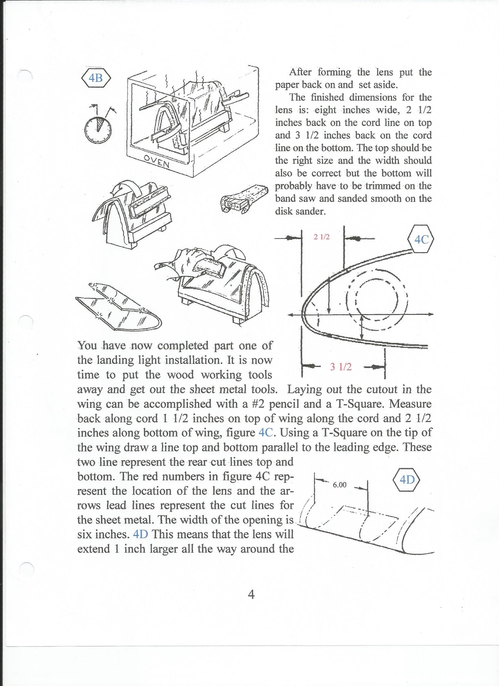

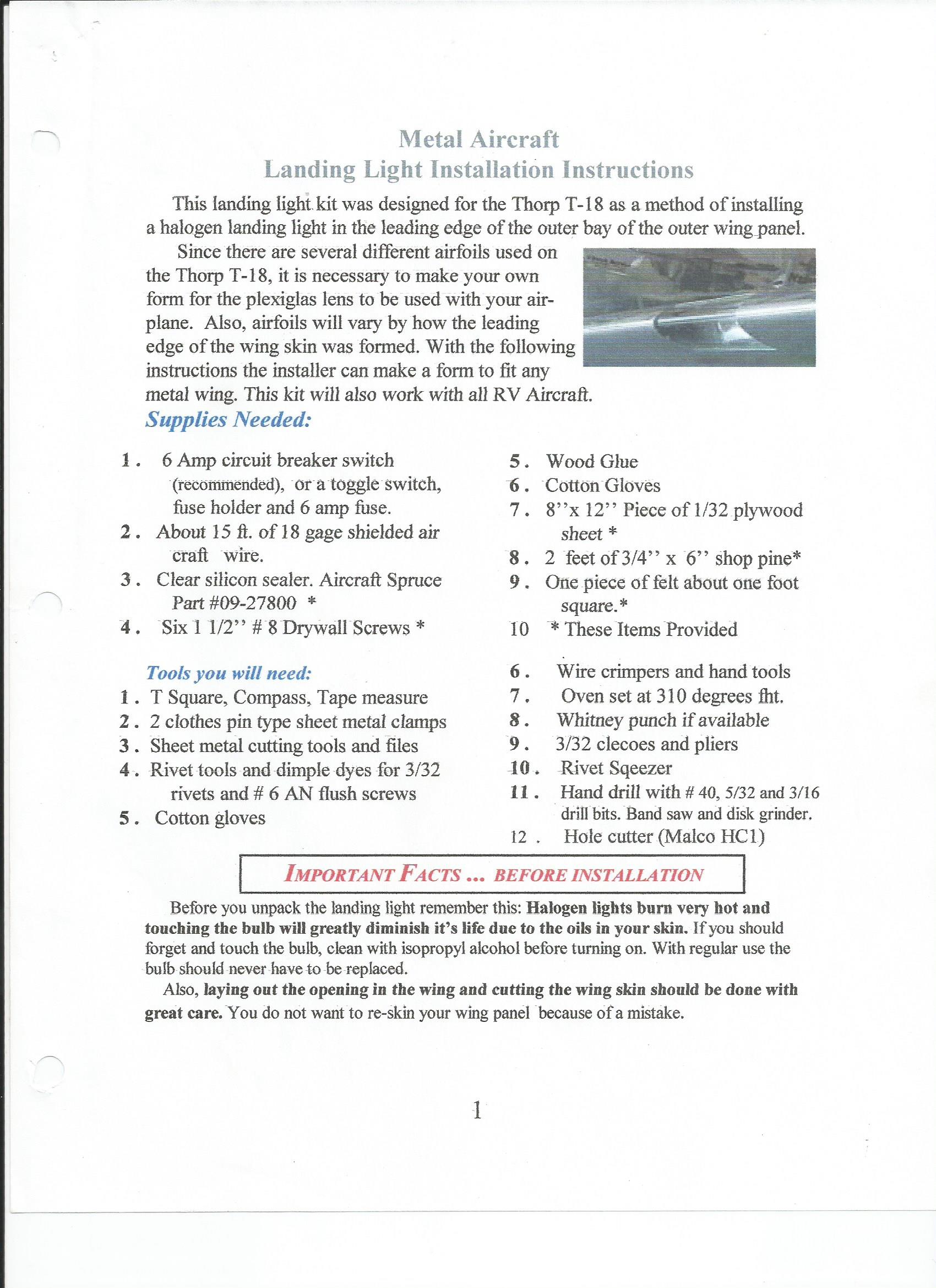

I used this format to make my lens . The rest was modified slightly to fit my LED lite . Not as difficult as it looks !
