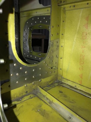

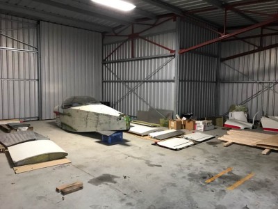

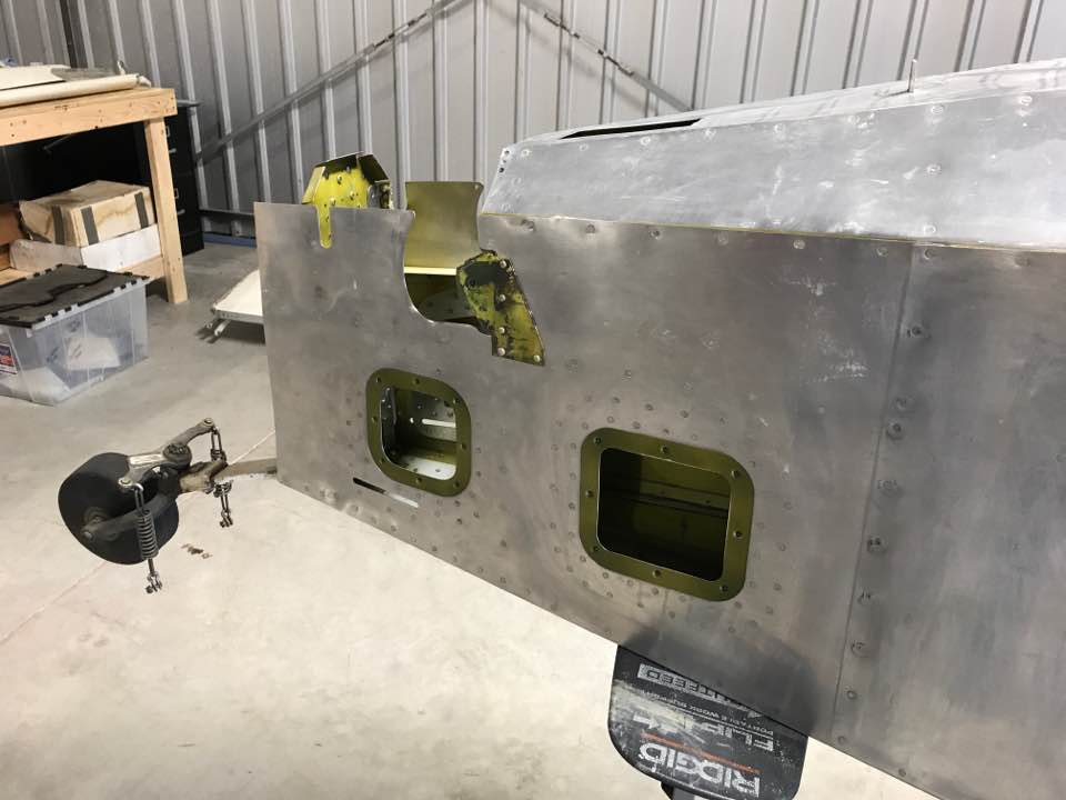

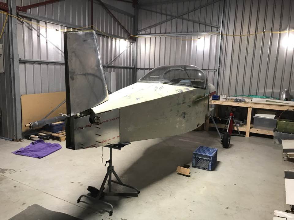

In March, I flew out to CA to pick up the airplane and trucked it back to Ohio. Cubes was a big help getting me some parts I needed to get the main gear on as well as a few other bits and pieces. I had a lot of work to do on the aft fuselage, but I think that's all behind me now (hehehe). I've been meaning to post some pictures for a while, and am finally getting around to it.
File comment: Replacement skin installed.

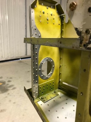

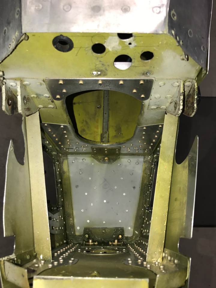

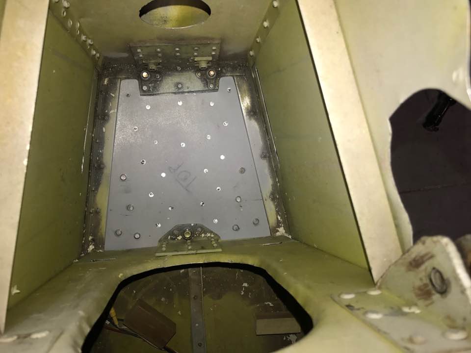

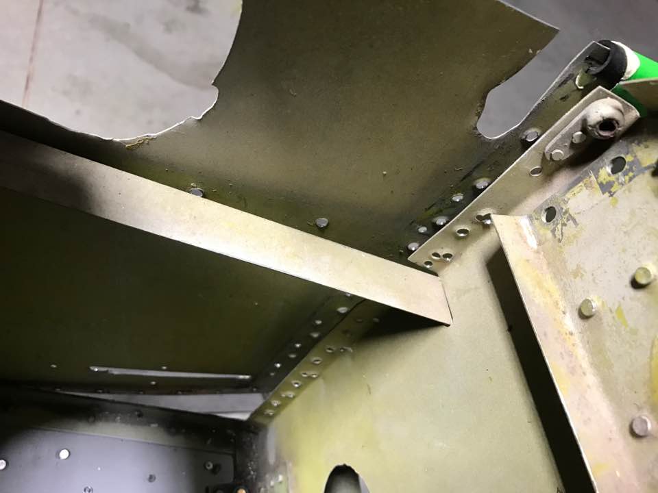

File comment: Found some cracks in the upper and lower flared flange. None went beyond the flange itself, but I'm betting they were caused by the lack of a bolster. I stopped drilled them and installed doublers.

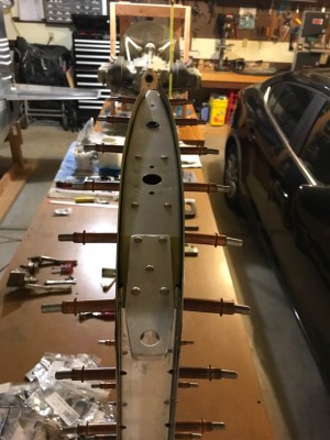

File comment: Test fit on the air frame.

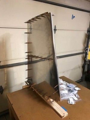

File comment: Made a new vertical fin with a fitting for a NAV antenna.

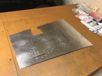

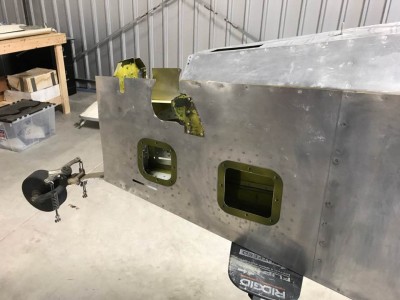

File comment: Made a new skin with access panels.

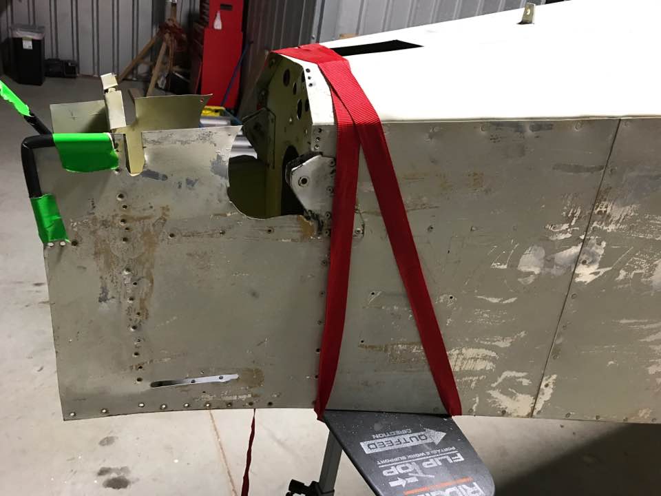

File comment: I cut the flange off and made repairs.
File comment: Now, this was a problem ...

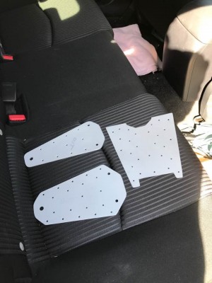

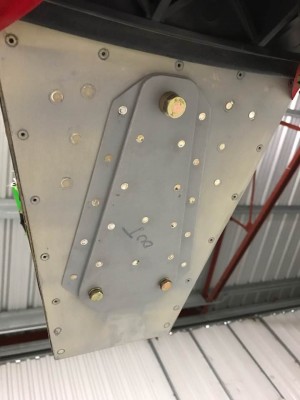

File comment: Customized the bolster support. The stock part would not fit, and I wanted to distribute the load a little more evenly between the BHs.
File comment: Main Gear On

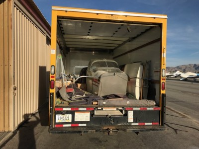

File comment: Back in Ohio

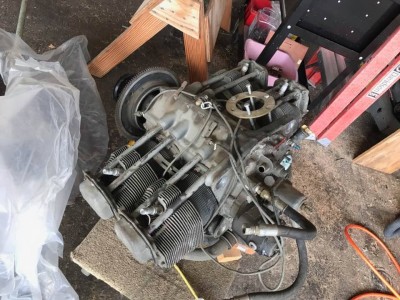

File comment: Loading up the truck

Rich Brazell wrote:
Nice looking metal work ! ;)
Thanks! I've been getting lots of practice over the last 5 years working on a Midget Mustang Project.
