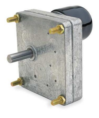

I am considering installing a 4.5 rpm elevator trim motor in my project. Would anyone think 4.5rpm is too slow for elevator trim? I currently have the same gear motor in my flying Thorp, but it is a 17rpm motor, and sometimes I feel like I am hunting for my trim sweet spot.
Here is the one I am considering:
https://www.zoro.com/dayton-dc-gearmoto ... /G3445111/
PostPosted: Tue Dec 06, 2016 10:39 pm
Others who have electric trim can answer better than I, but I suspect that it will be just fine. Better a little slow than too fast, for trim, in my opinion. It looks like a good motor, and that price is a few bucks cheaper than you can buy it direct from the supplier, W. W. Grainger (unless you have a business account at Grainger, & get a discount).
PostPosted: Tue Dec 06, 2016 11:17 pm
When you say hunting for your "sweet spot" , do you mean you overshoot that magic spot ? :P It doesn't take much travel of that tab to "trim it out ." I find I just "bump" my coolie hat and it is more than enough to level things out . I have flow a lot of AC with electric trim and I find that is the case for all of them . So I would say yes...slower is better . ::) It may mean you hold the trim switch a 1/10 of a second longer , but probably less likely to overshoot . ???

Mine turns about 11 rpm and is a little slower than I like, but is acceptable. I would think 15 to 18 would be about perfect.

Yep, I feel like I am overshooting that magic trim spot with the 17rpm trim motor, but based on Jim's post, I may just stick with it for the project too.
