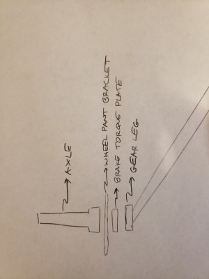

Just to save myself some possible aggravation later, I wanted to ask if this is the proper order of installation for attaching the axle/wheel pant bracket/brake torque plate to the landing gear. I attached a photo showing what I think is the correct order of installation.
