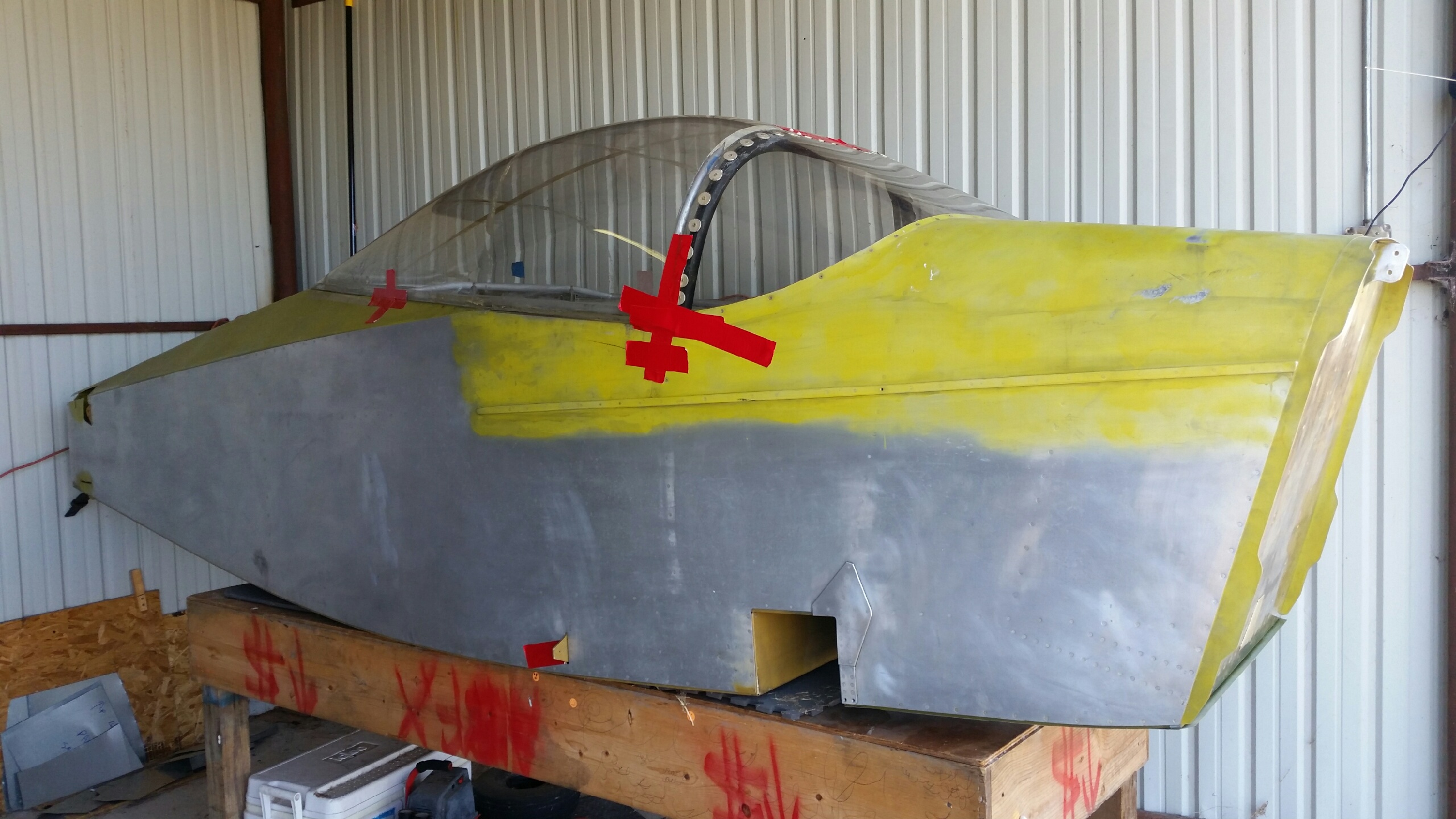

well, here she is. Now I want to mate the empennage and wings, and go make airplane noises...

Looking good Billy Ray ! One thing you might want to do is remove the "red" tape , especially if it is the really sticky stucco type tape . If you leave it on too long a lot of the adhesive will remain on the AC when it comes time to remove the tape . Then its a lot of goo be gone (water based only !) to get the funky stuff off . ??? Go ahead , ask me how I know . Go ahead ask me !! ::)

Bruce : My knowledge of the "Red Tape" came to me in a vision while moving the controls behind the curtain ! :P Actually from using the stuff for many years around the house , especially when using it to put up plastic sheeting to protect the house when pouring concrete . It was the only stuff that would stick to the stucco siding of the house and then the name..."Stucco Tape" was born ! 8) Yes , it is actually called stucco tape . ::) The holding power was so good I used it for other projects and when I left it on too long...well you know the rest of the story . You can find it at Home Depot in isle 7 , bin #11 . :o

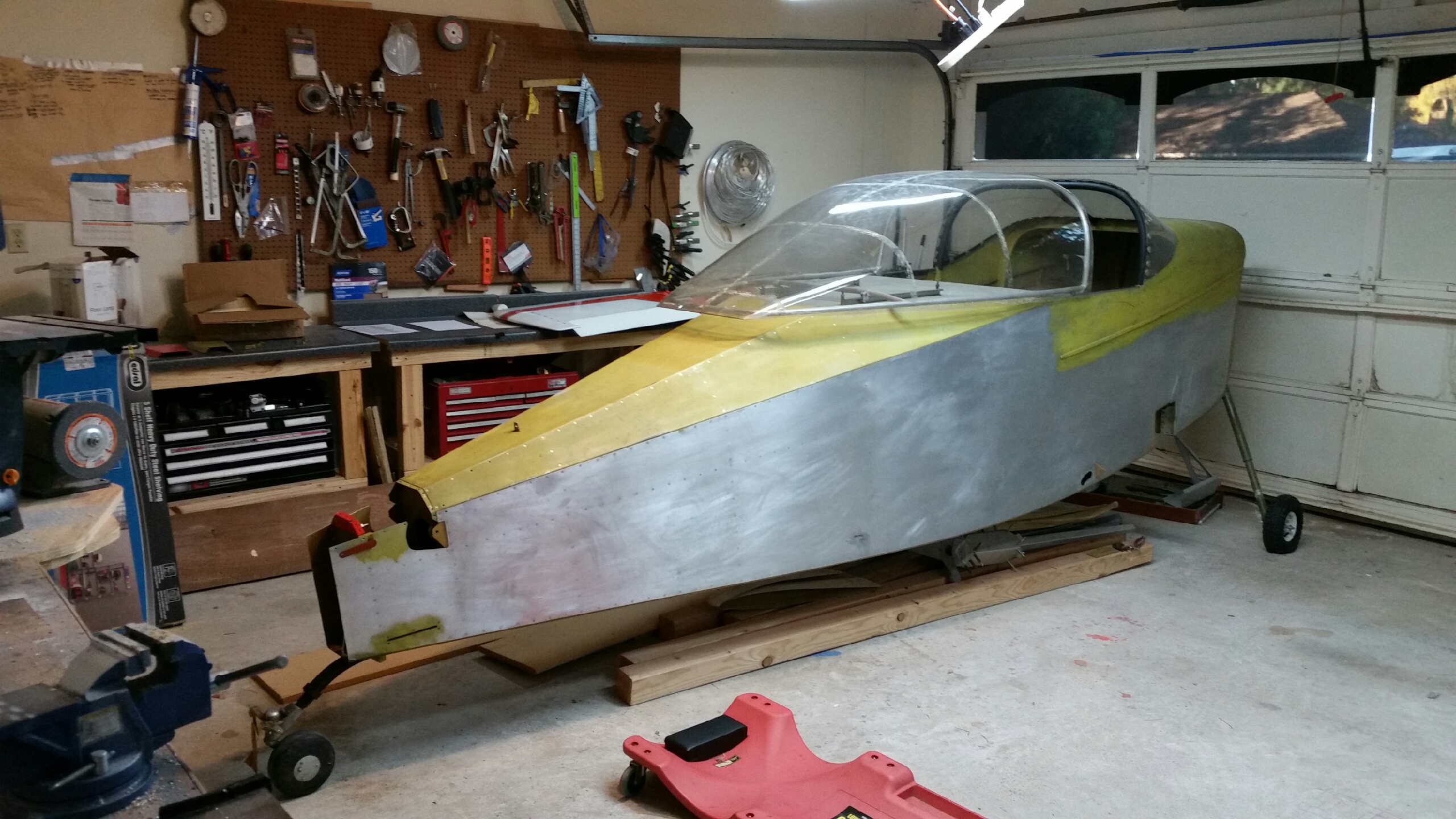

Got her home and on the gear (tailwheel is temporary). Happy Turkey Legs!

Looks good looking forward to progress pictures of your project

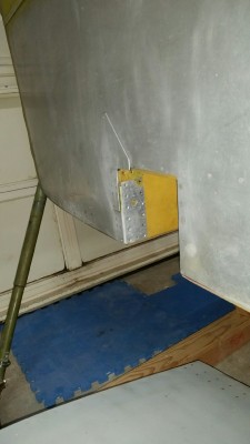

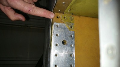

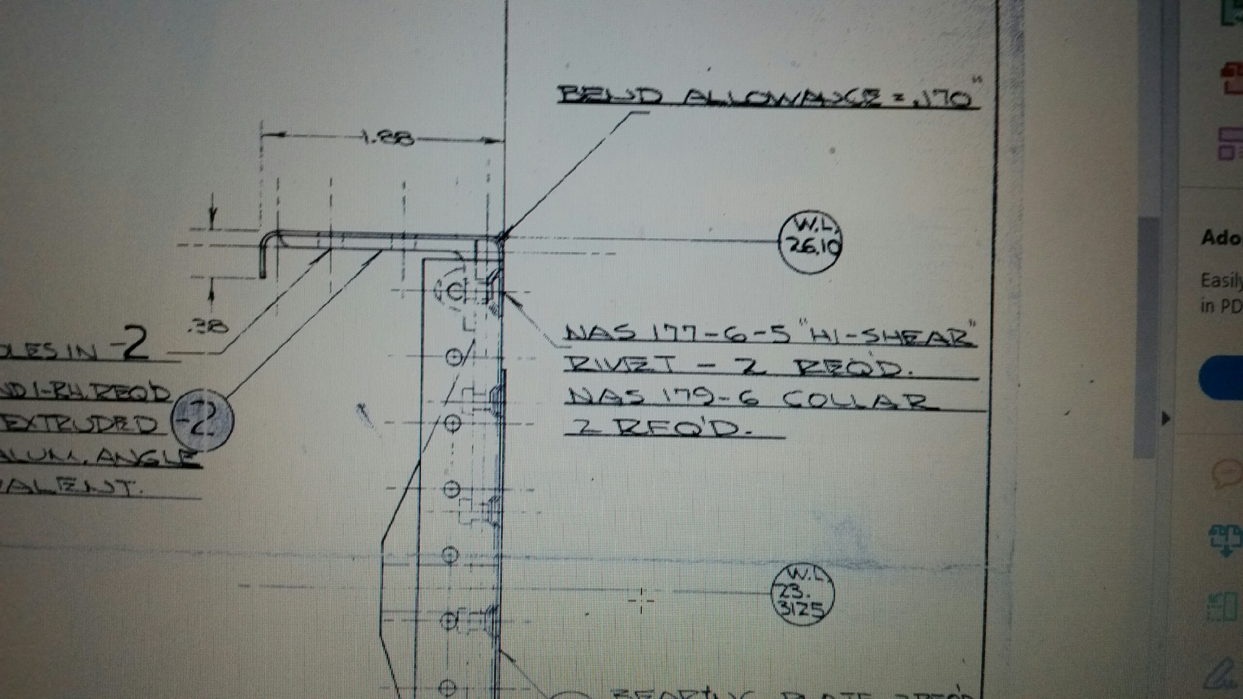

I am trying to install the 602 Fittings that attaches to the fuselage at the 601 bulkhead (where the front main wings attach to the fuselage). The plans call for a NAS 177-6-5 Hi-Shear Rivet with a NAS 179-6 Collar to be installed in the top corner. Is there a suitable substitute everyone has been using here in place of the hi-shear rivet and collar? I have attached some pictures to (hopefully) make it clear what area I am discussing. In the second photo I am pointing to the rivet in question.
