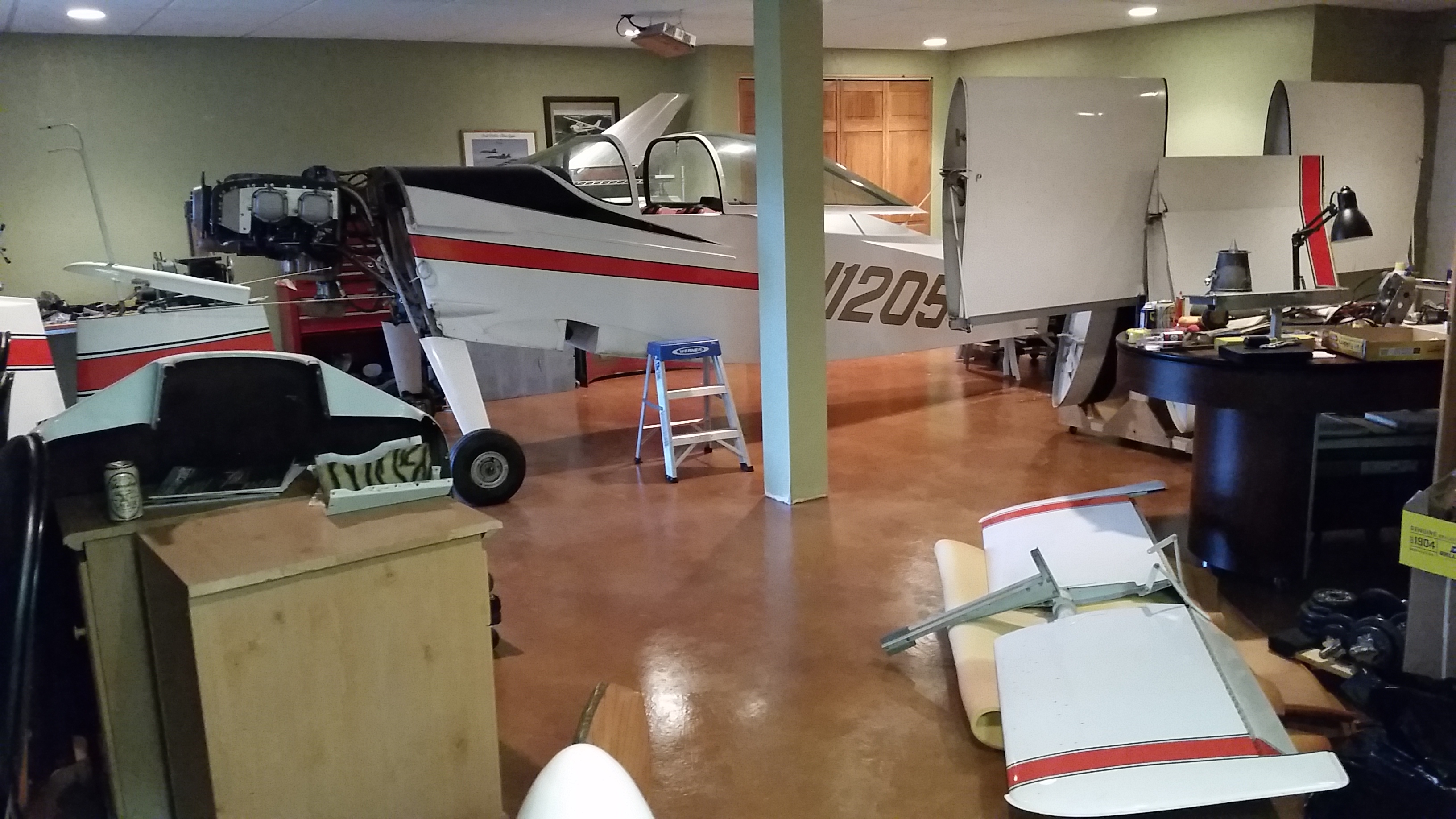

File comment: The basement turned into a workshop

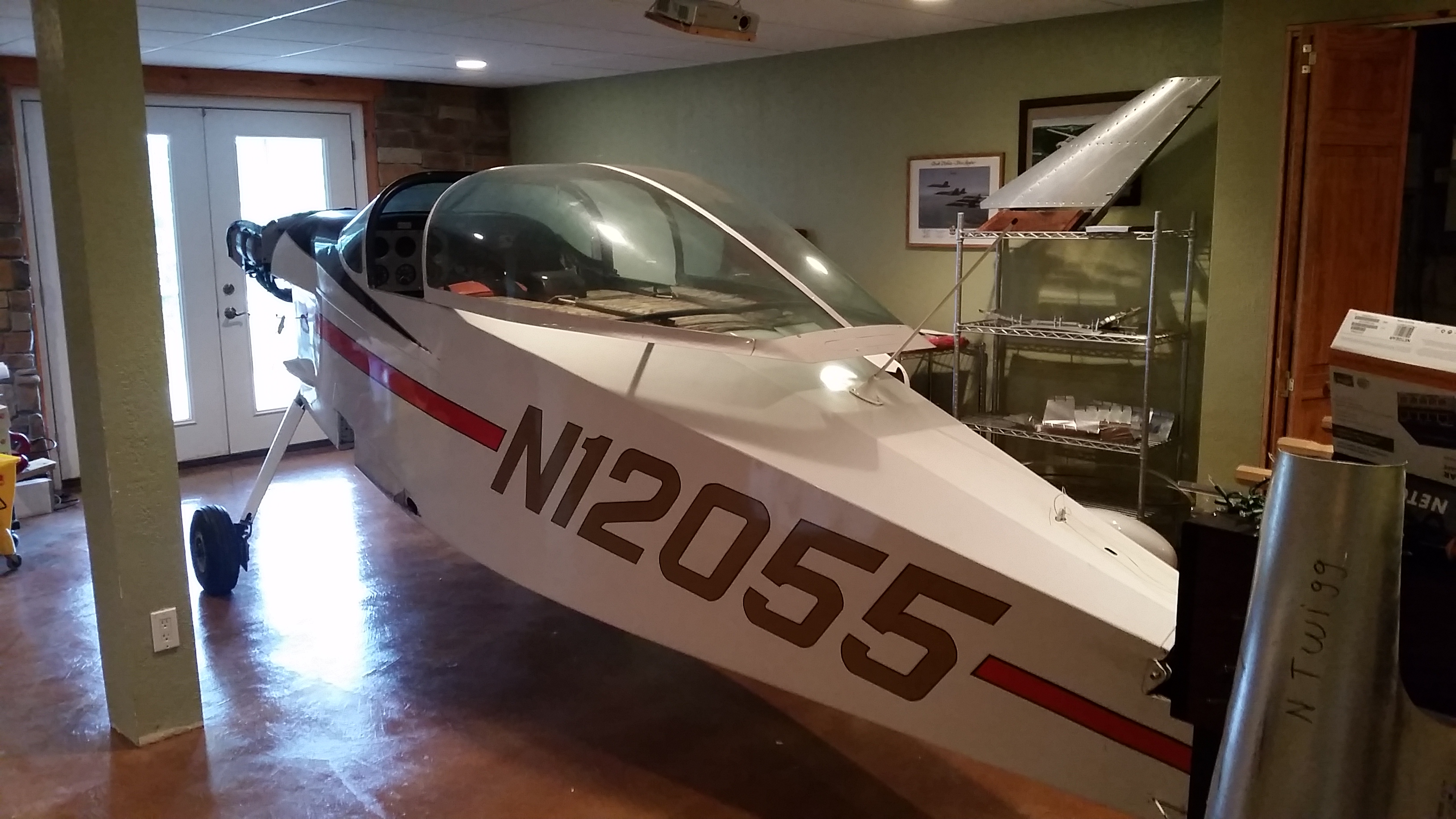

File comment: Safe at home for the winter

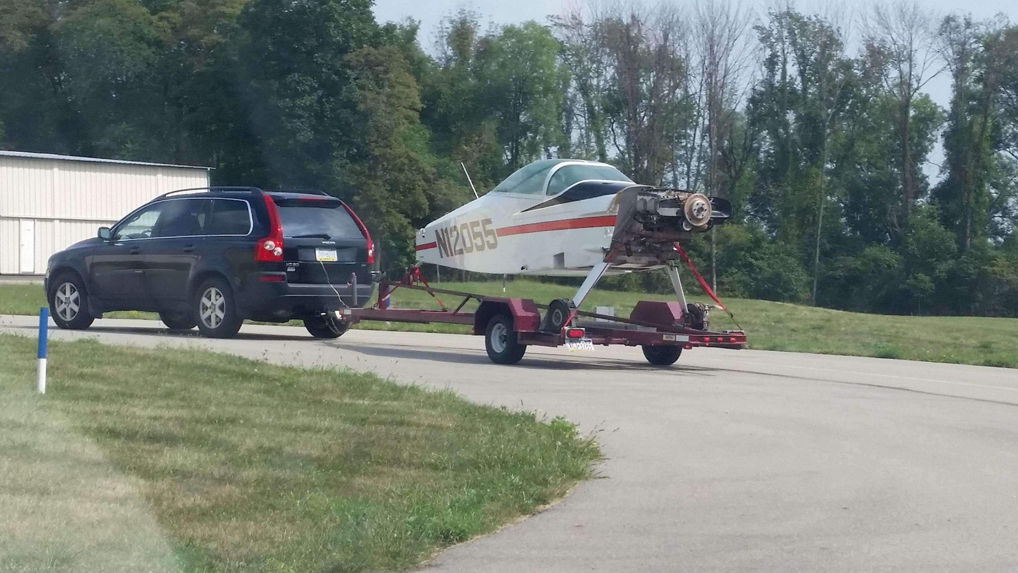

File comment: Dragging 12055 home from the airport

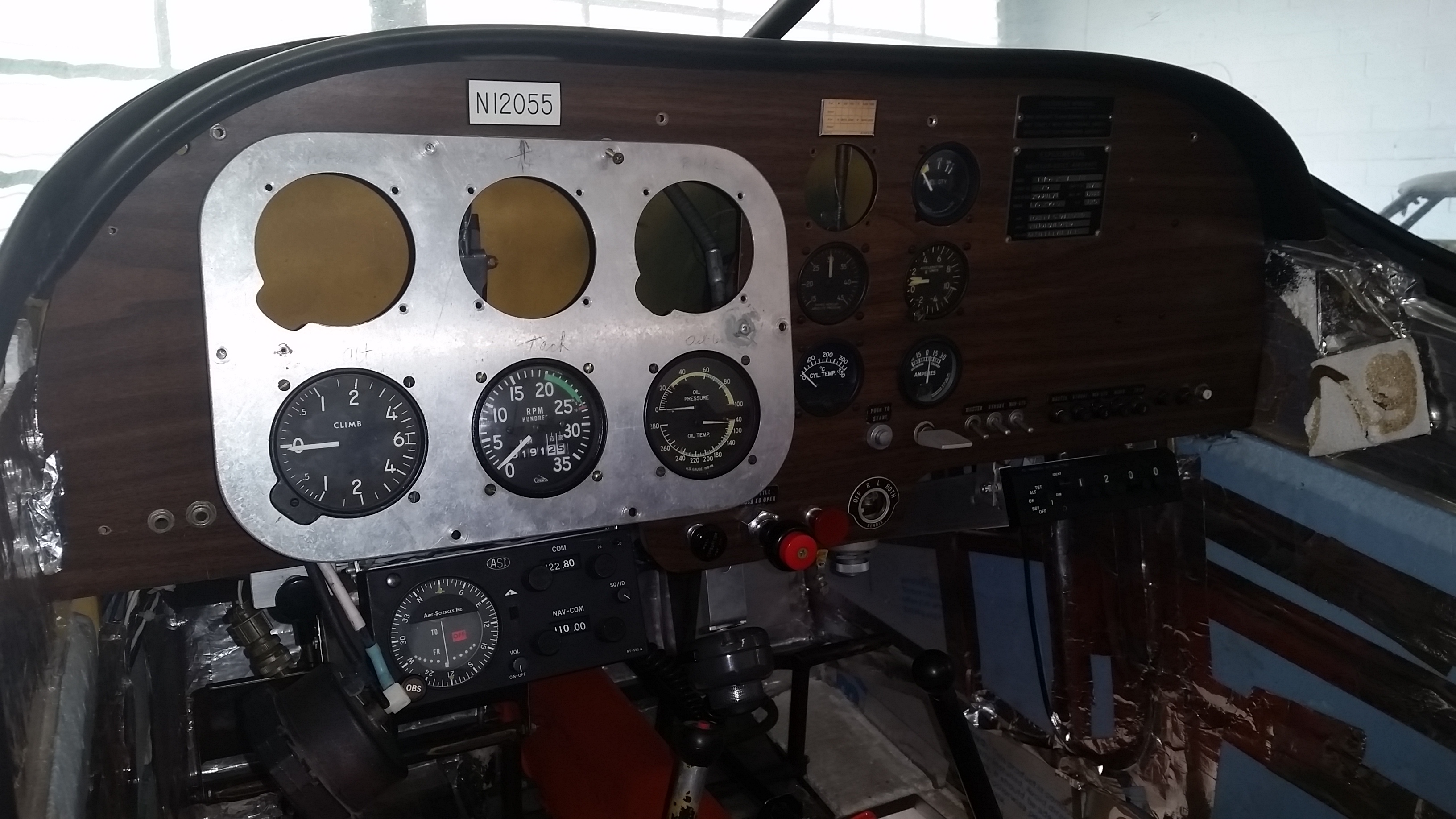

More detail: N12055 has, as best I can tell, a standard wing. It is set up for day VFR with no landing light or instrument lights. Basic instrumentation is used and I will keep the steam gauges for now until I get some experience flying a tailwheel aircraft and this one in particular. After that, I'll convert N12055 to EFIS over another winter.
File comment: The panel at the time of purchase
