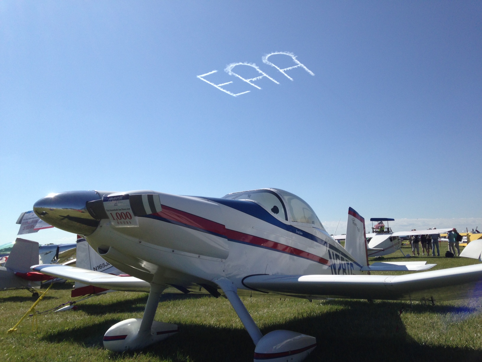

“The Ellison is an elegant solution to the problem, but I don't know how well they work in practice. I believe this style of carb was used in race car engines for decades (before fuel injection took over). The M-S is, of course, very well proven.”
FYI – I have had an Ellison EFS-4 on my 180hp O-320E2D for approximately 16 years and 700 hrs of flight time. It has provided excellent performance and I am very happy with the unit and the customer support. It was my solution for obtaining less drag in the lower cowling caused by an M-S hanging from the bottom of the oil sump. I directed the ram air in and into a plenum that fed into a rear mount oil sump. I have never experienced a “sticking” slide plate or any other anomaly. I did send it in two years ago for an upgrade and had all wear-parts replaced (Teflon slide plates, etc). I’m happy enough with it that I found another one with 20 hours on it and will put it on the Pitts S-1C that’s somewhere down on the To-Do list.

I looked over the notes on my old computer and find I am guilty of guilt by association. I thought I recalled reading of a sticking Ellison slide, but I can find no note of this. Some part of my (aging) brain had lumped them in with all the crummy slide carbs on the market. My apologies to Ellison!
David Read's T-18 has a non-standard carb installation which cleaned things up nicely.
A quick look around the web with google suggests an Ellison installation takes more trial and error than with a carb, but the people who get it right like their Ellisons.
