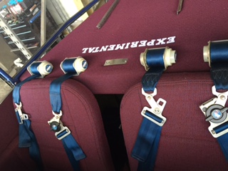

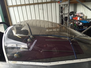

does anyone have a weight and balance worksheet for the T-18? I have searched the site but not having much luck. thanks. Also finished my interior today!!!!

Scott, very nice job on the Cockpit upholstery, that is clean and neat......Dan
