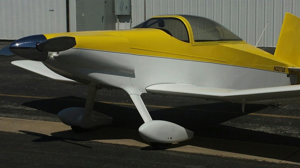

Thanks for all the well wishes and congrats. We've flown about 4 hours. Here's a picture with wheel pants on.
PostPosted: Sat Aug 09, 2014 6:19 pm
Great looking bird!! KB would be proud! Thanks for putting that one in the fleet!

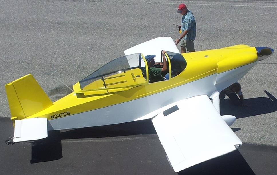

Hope all is well in Thorpdom. We are flying off our 40 hours. My Brother Chris is doing most of the flying work. He said the 180HP, injected Thorp with constant speed is a goin machine. He has had it up to 2,600 rpm and in smooth cool morning area is doing 220 mph or so. He has been running mostly around 24 to 25 squared. Cylinder temps are in the 380's with about 1 degree of difference in some of the cylinders. Much better than what our 0-290 carburated Thorp does. We are changing out the mineral oil tomorrow. What do you guys think if the Phillips 20/50XC all the RV guys are running. They seem to sware by it. Well, talk to you soon and check out our picture of last Saturday. Me, Brent, doing ground control and my Brother Chris in the cockpit at Corona, CA.
Talk to you soon,
Brent
File comment: Second flight of N327SB
PostPosted: Fri Aug 15, 2014 9:30 pm
Umm red line is 210mph guys!
PostPosted: Fri Aug 15, 2014 9:38 pm
DOH ! I use Phillips 20-50XC , but not over 210 mph ! :o
