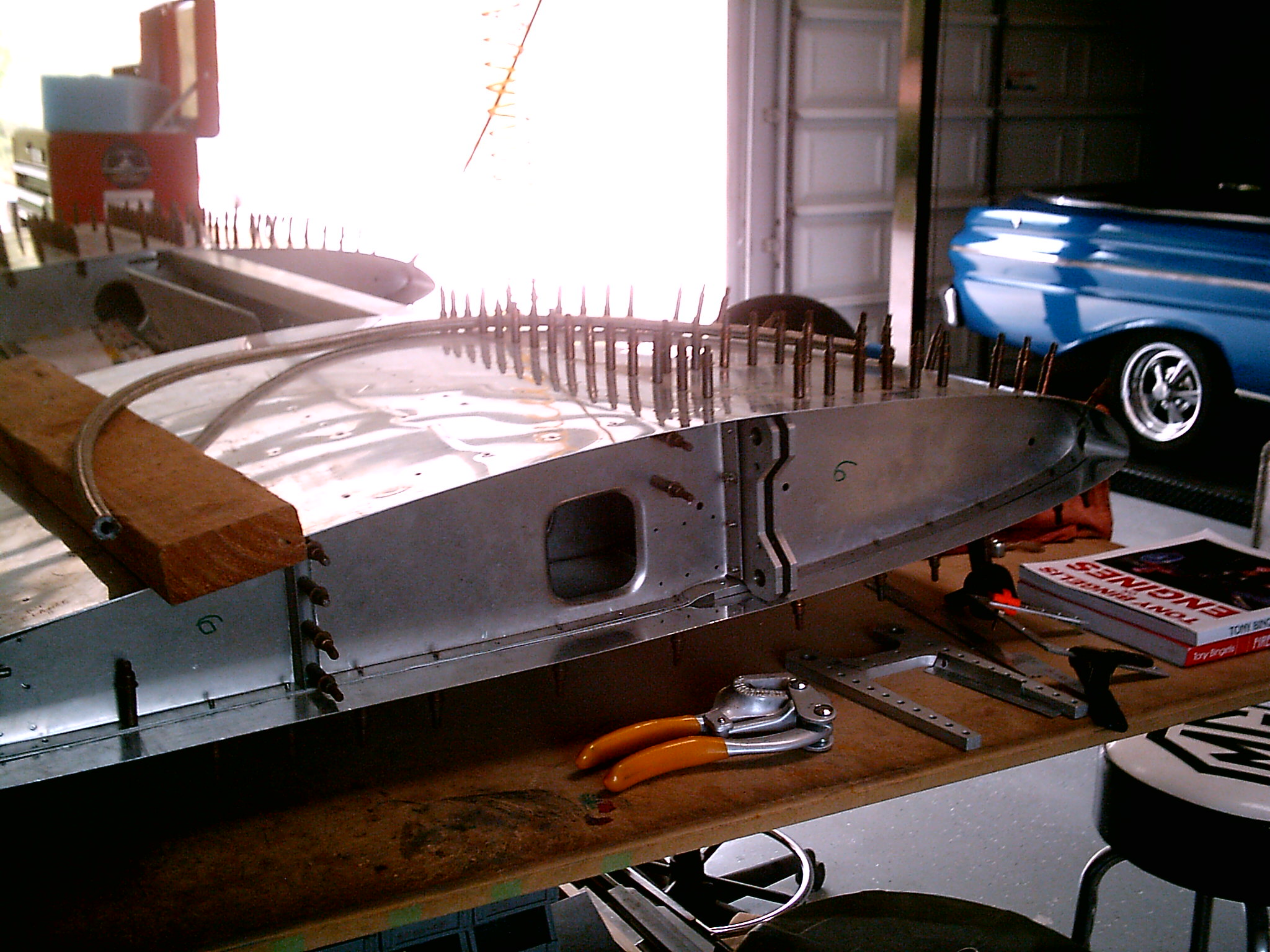

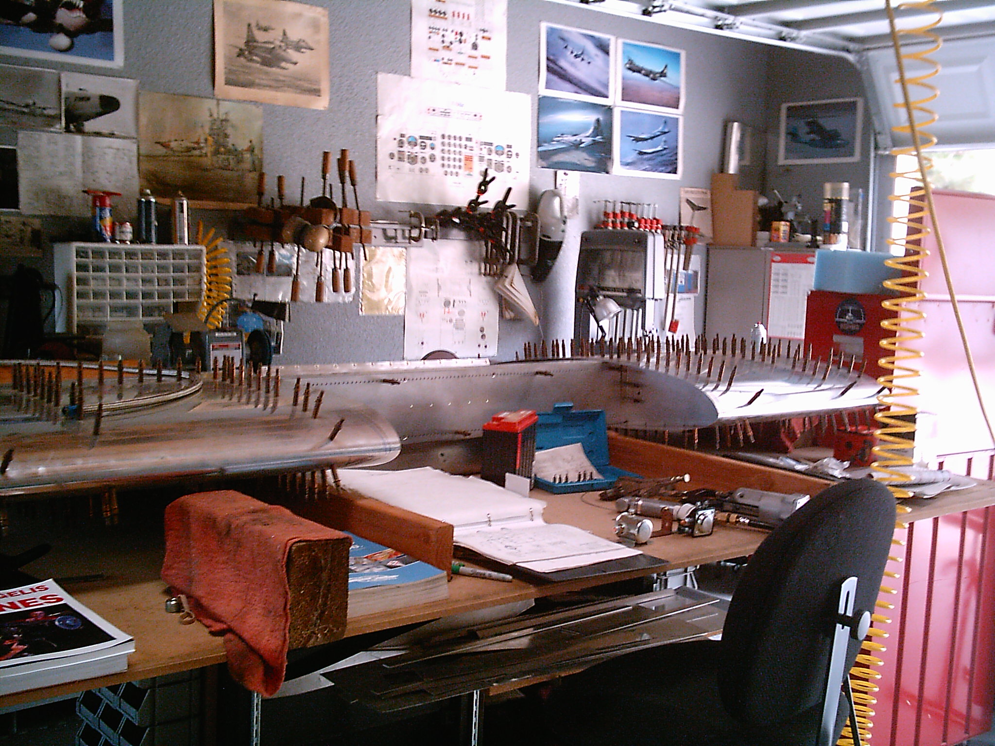

I used a 4 x 8 foot sheet of 3/4 inch MDF board . Easy to route a smooth rounded edge on ( tuff to do with plywood) and plenty big enough to assemble the center wing section or one outer wing section on an S-18 . I choose the MDF as it is a smoother board on the surface than plywood . I placed the MDF on top of a mobile cabinet to move around as needed . It also provided extra storage space for AC parts . It was slightly higher than waist high so you are not reaching up or down to work on your mistakes . ??? It held up for many, many years until the AC was complete and then I think it ended up in the fireplace ? :P Pretty sure MDF and plywood are close in price . BADA BING , BADA BOOM !!

I made a 4' x 8' table using 2" x 3/16" angle for the legs and frame and 2 x 4's and 3/4" plywood for the top. Laying out the wings are critical and require that the wing does not have a twist in it. Used two 4" aluminum "I" beams , they need to be parallel and level on the table top(24") width. Laying the wing on these rails will assure the the wing is straight . Use furniture straps to hold the wing in place. The important thing is the table and parallel beams need to be level

Yep...3/4" MDF works very well . The MDF is much smoother than the plywood . 4 x 8...plenty big enough for center section or one outer S-18 wing . I put it on top of a roller cabinet so it could be moved around , if needed . Waist high worked for me .
