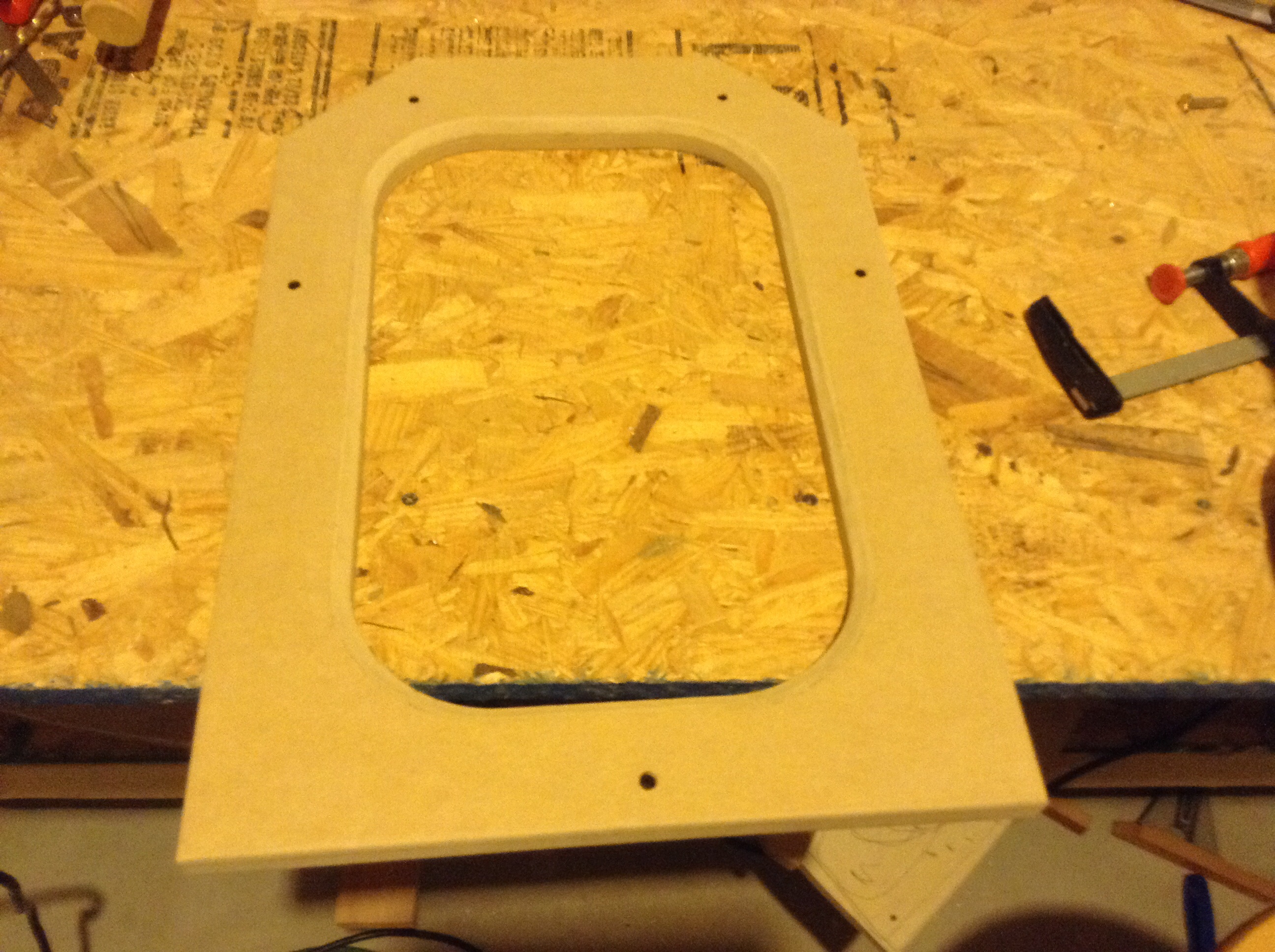

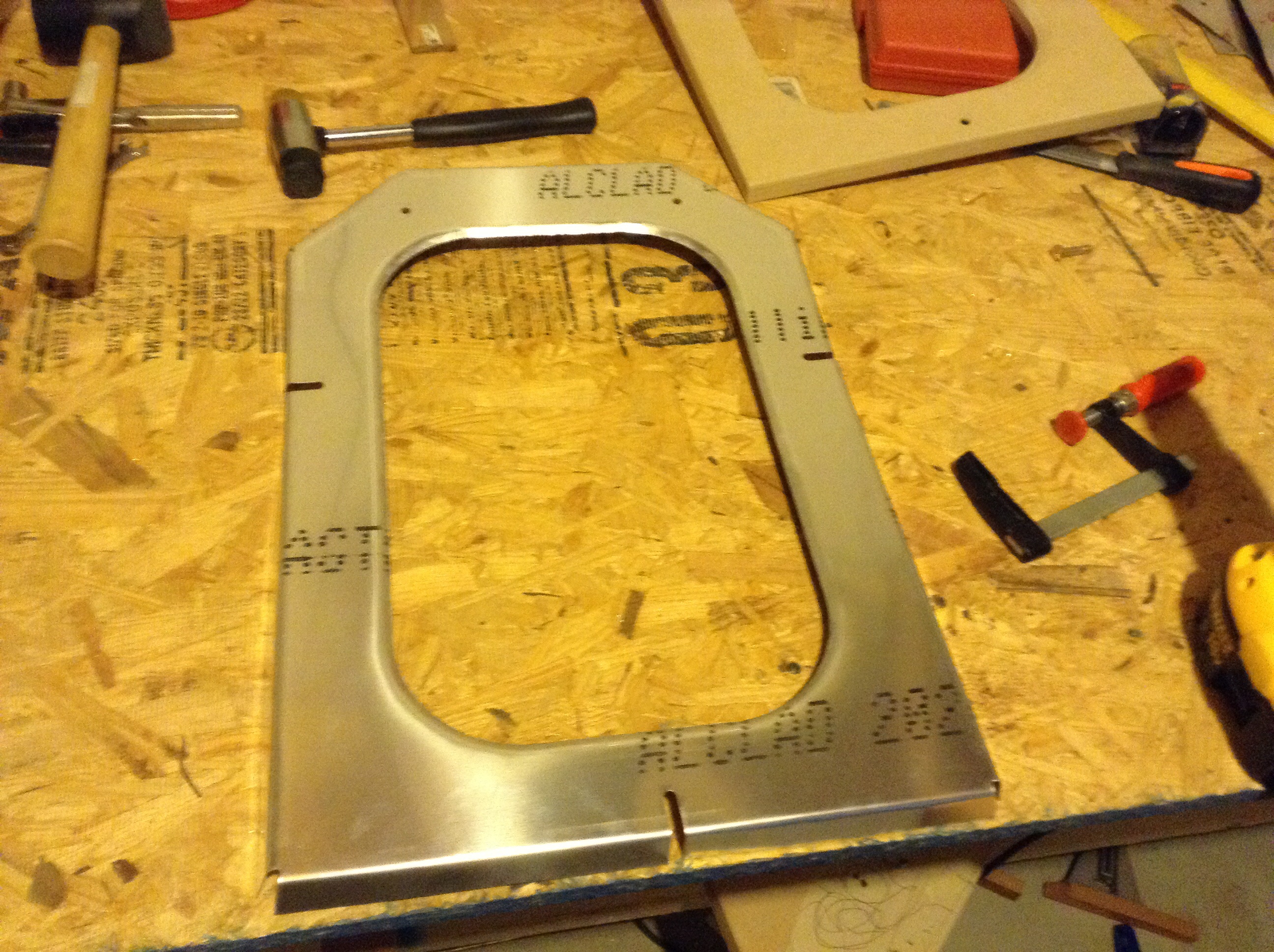

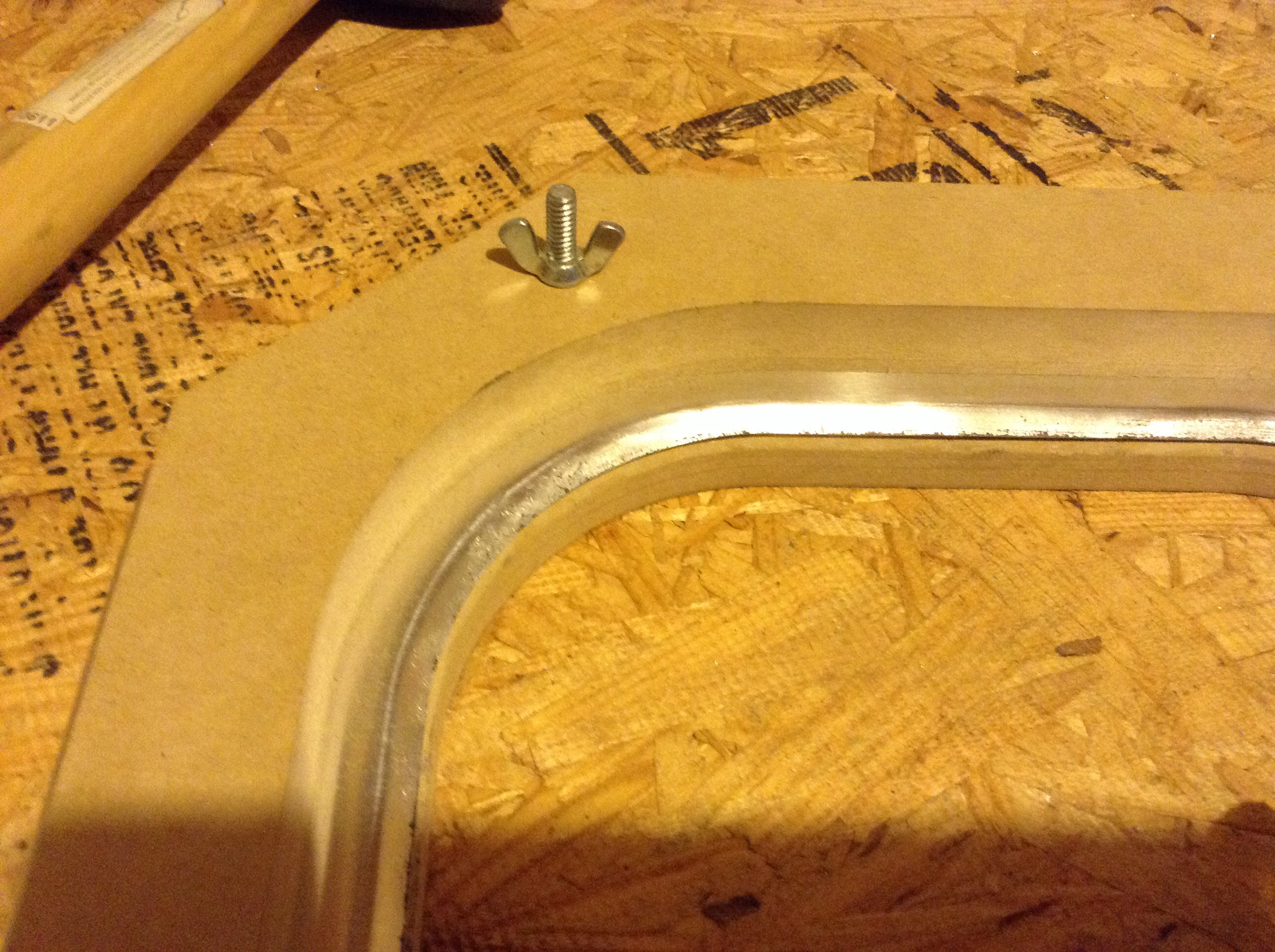

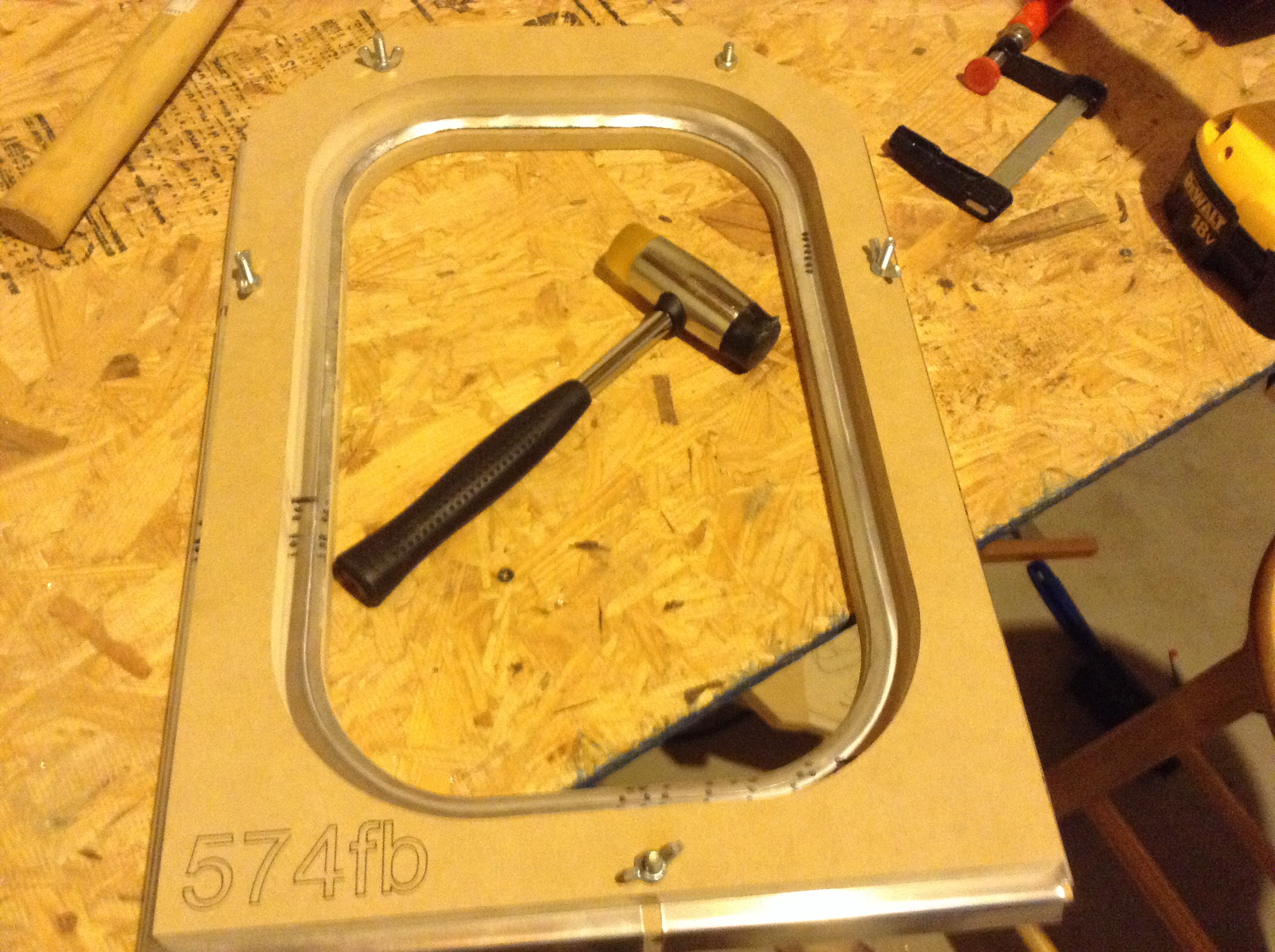

After reading this topic I was motivated to give it a try myself. I used the 2 form block method with the bulkhead sandwiched in between. I cut a 45 degree chamfer on the inside flange of the form with a router and used a hard rubber mallet to form the inside flange, starting in the corners and then the straight sections, forming a few degrees at a time. After a few passes it was forms all the way down against the chamfer minus a few degrees for spring back. When I removed it from the form it was nice and straight, no warping or waviness at all. I credit it to the helpful tips here or just dumb luck, but I couldn't be happier with the results. The only problem I see is that it's not quite 45 degrees per the drawings do to the spring back.

PostPosted: Sun Jul 27, 2014 9:31 pm
Nice job! Remember to make the 45 degree flange on the bagage compartment bulkhead bend to the rear instead of forward. This will make installing the luggage compartment rear panel so much easier.
