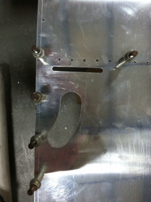

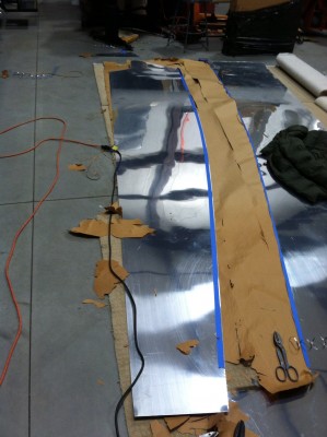

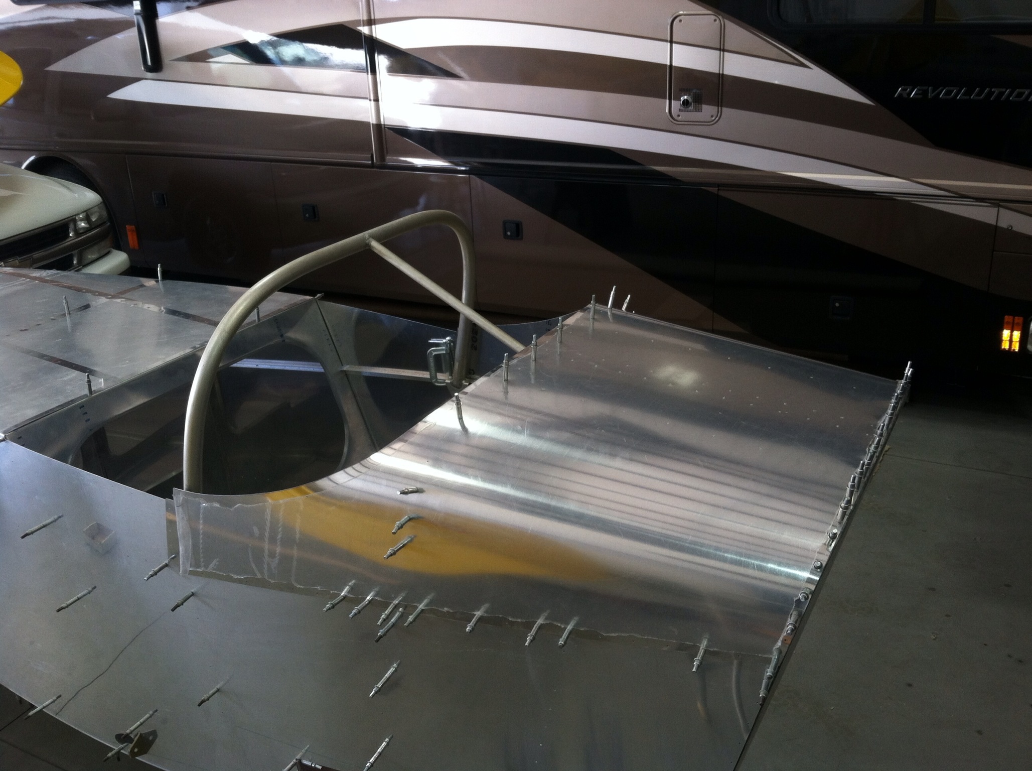

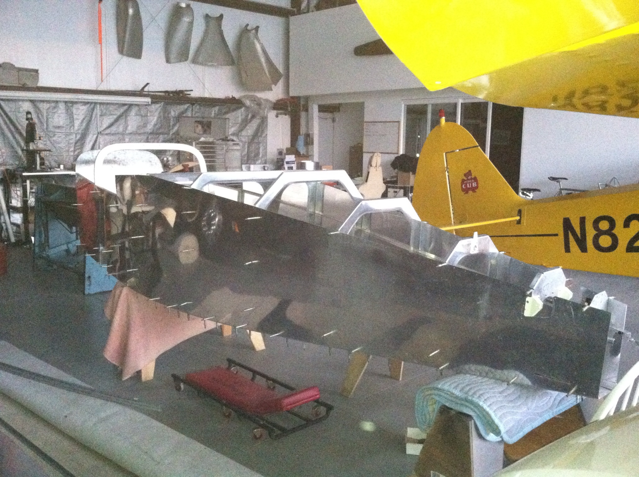

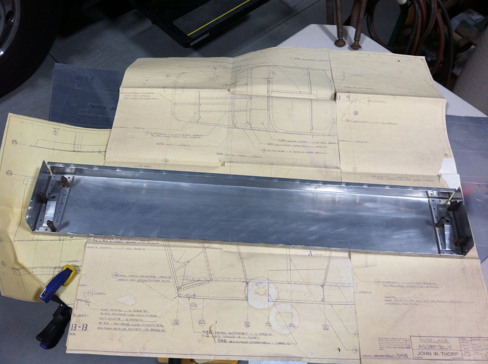

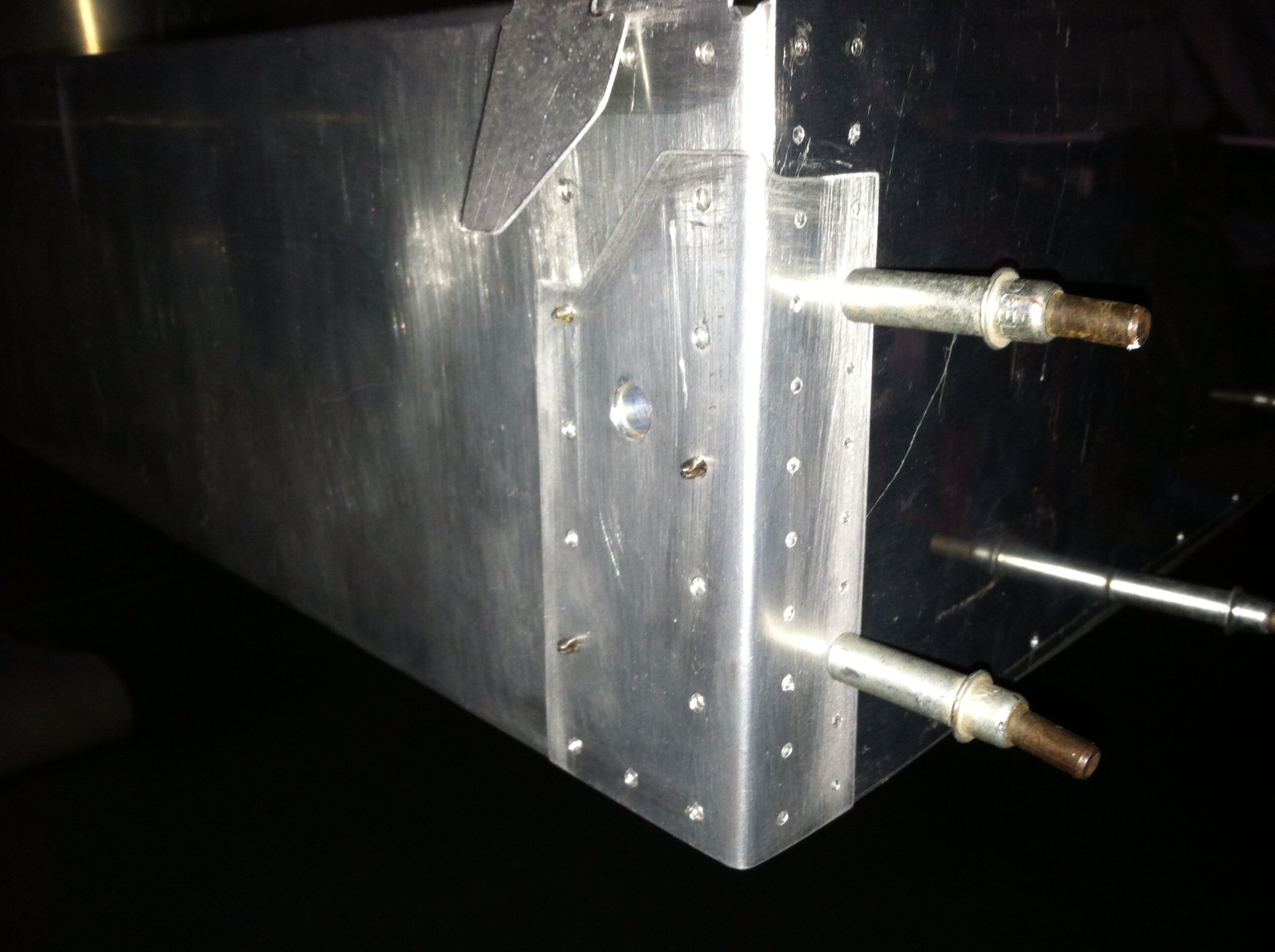

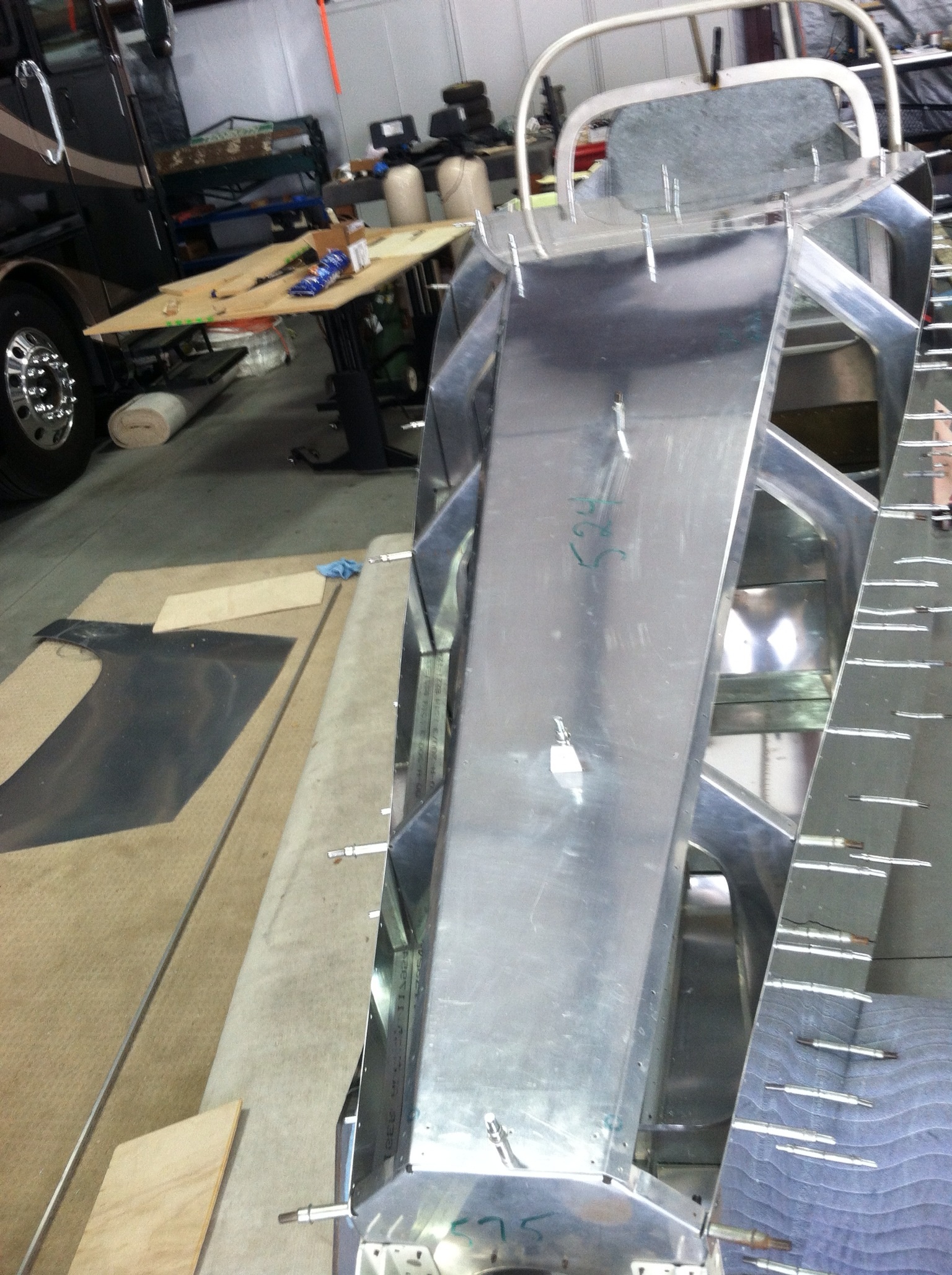

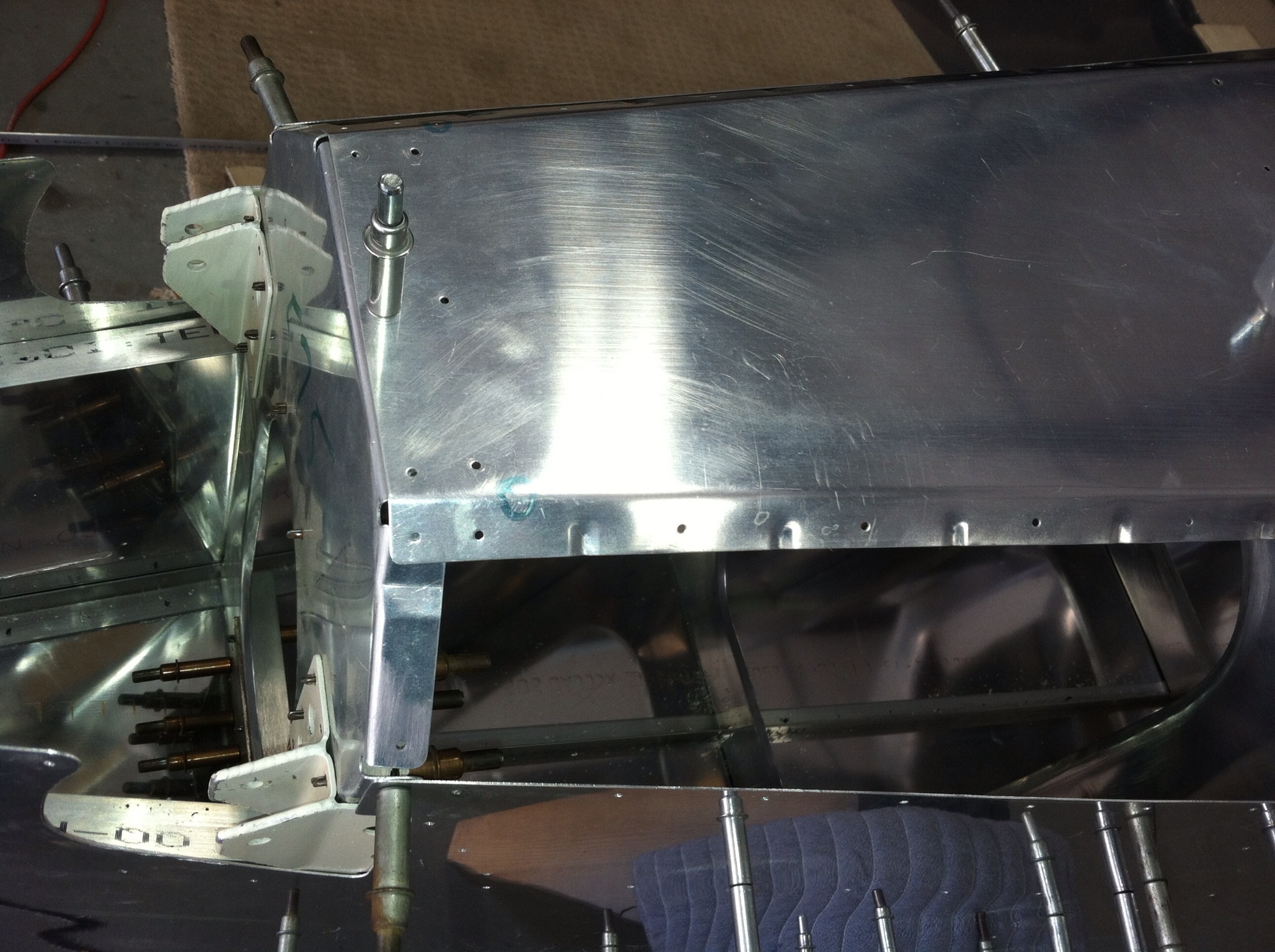

Here's my progress

Bruce, are you using the "transfer strip" method of locating holes? I'd really like to see some pictures devoted to showing how the transfer strip method works, if you have any.

Hi dick,
I've been fortunate to have one side skin pre punched from Phil Tucker.
I then transferred that to the other side, the cut them out.
I've made templates from the plans and also just measured for other locations.
Bruce

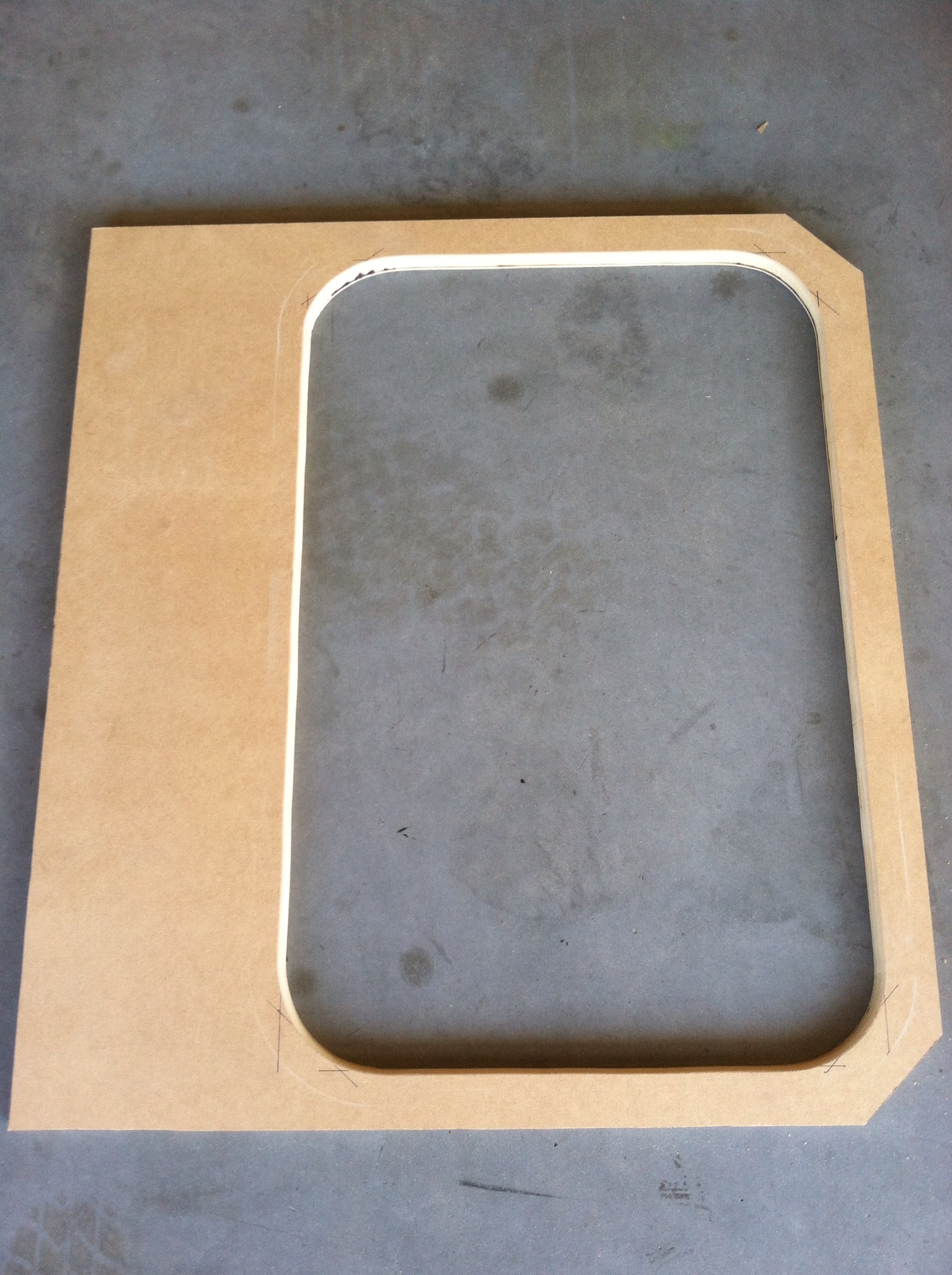

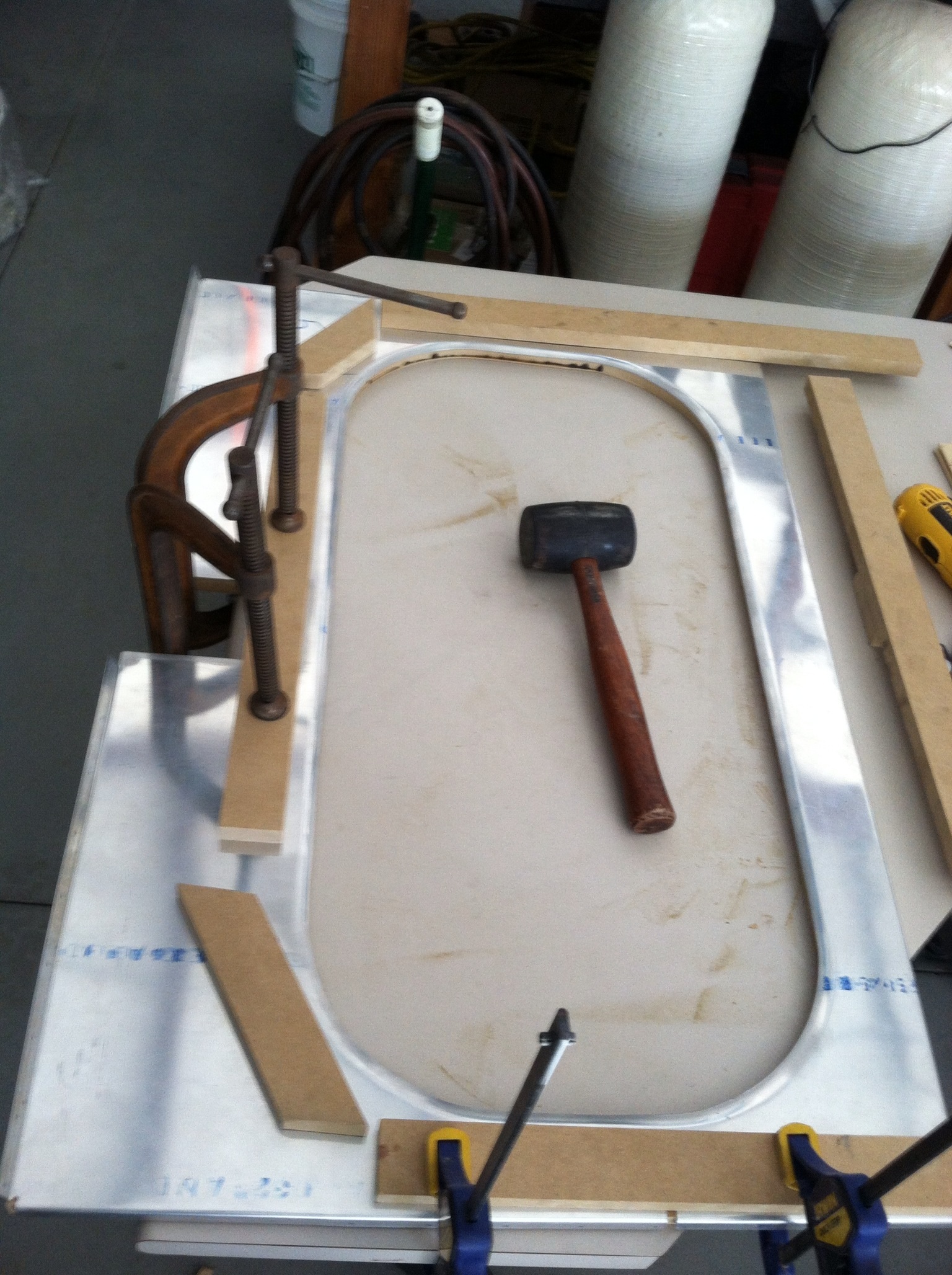

Bruce,
did you beat out those radii with the rubber mallet? Whats the trick? I have tried to make a couple of bulkheads with the rubber mallet and all mine come out wavy and end up in the trash bin.

Hi Ryan
Well, with some advice from those who have done this before, the best tip was to go slowly.
I made good form block out of MDF and gave it a nice smooth radius. Then start on the straight sections and just get a little bend going before moving to the corners. Glancing blows in the direction of the bend. Remember to be happy with a little at a time. I also kept my flange length a little shorter in the curved sections. Hope that helps!
Bruce
Oh, by the way, I was very diligent to clamp supporting strips of scrap MDF where I was working. Lots of repositioning and re clamping.

I wish I would have kept a good build log with respect to time, but I'll have to guess.
I think I have about 75 hrs. so far on the fuselage.
I have other components that were started some time ago.
The center wing is ready to rivet.
Thanks for the comments.
Bruce
