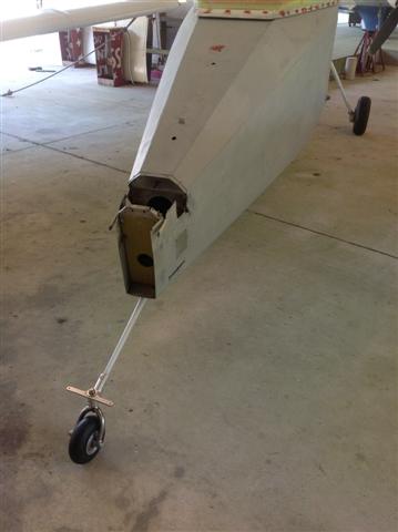

File comment: Tail Spring Installed

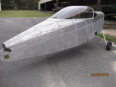

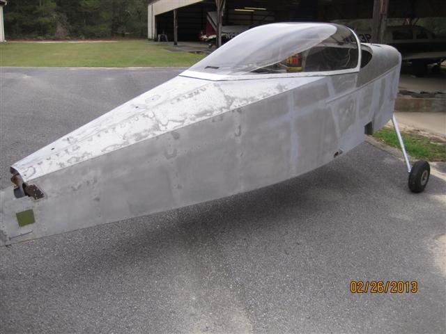

File comment: side view of 66WT with canopy on

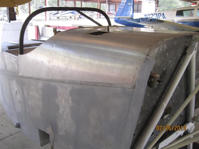

File comment: Replaced the Boot Cowl

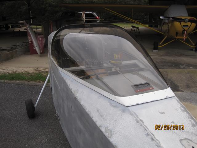

File comment: Test fit of canopy after reattaching the canopy rails

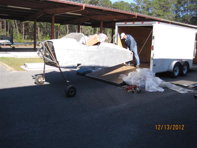

File comment: 66WT arrives at FL17

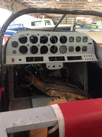

PostPosted: Thu May 16, 2013 10:14 pm
Instrument panel to include a standard gyro package, overhauled RCA turn coordinator, Tempest Vacuum pump, Electronics Int'l Tach and EGT/CHT. Grimes post lights installed in the panel for night/dusk flying. I'll be using Ztron labs LED navigation lights and LED landing lights in the wingtips with Wig Wag built in.
File comment: Instrument panel - Std gyro package with Kx125 and Kt96a

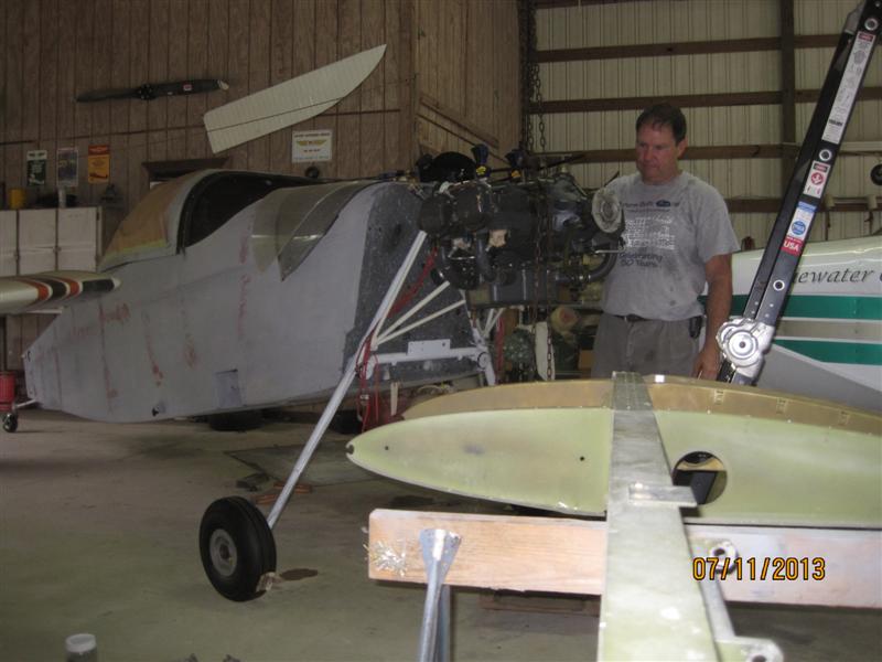

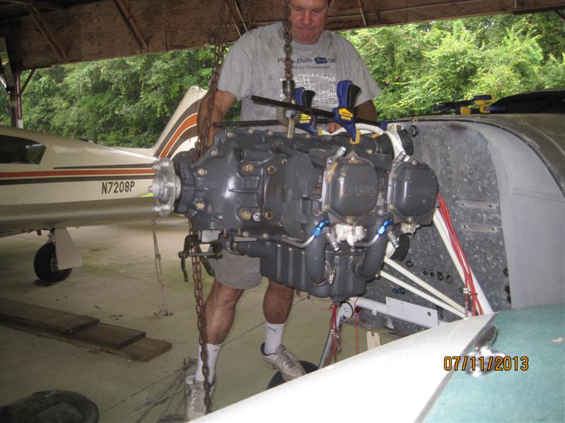

This stretch of days off was productive. I inserted all the rivnuts in the canopy frame. Next week I'll probably get motivated to get the windshield installed. I also got the right outboard wing stipped of paint. Then since today was a little cooler, I hung the engine. I was also able to get the Electronics International CHT probes installed as well at attach the Carb. Now with all this on the front of the engine I can plan exactly which wires will have to run where. Earlier in the week I was able to run the brake lines and get them tightened to the through fuselage fittings. The Brake master cylinders are in place but not secure. Additionally, the rudder pedals are laying next to the brakes so that I can check the fit and determine the length of flexible lines I'll need from the brake master cyl. to the fuselage fittings.
It's coming along....
File comment: View from the other side

File comment: Today was a nice rainy day and perfect for hanging the 0-320
