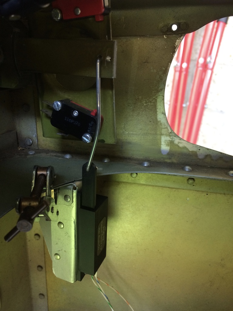

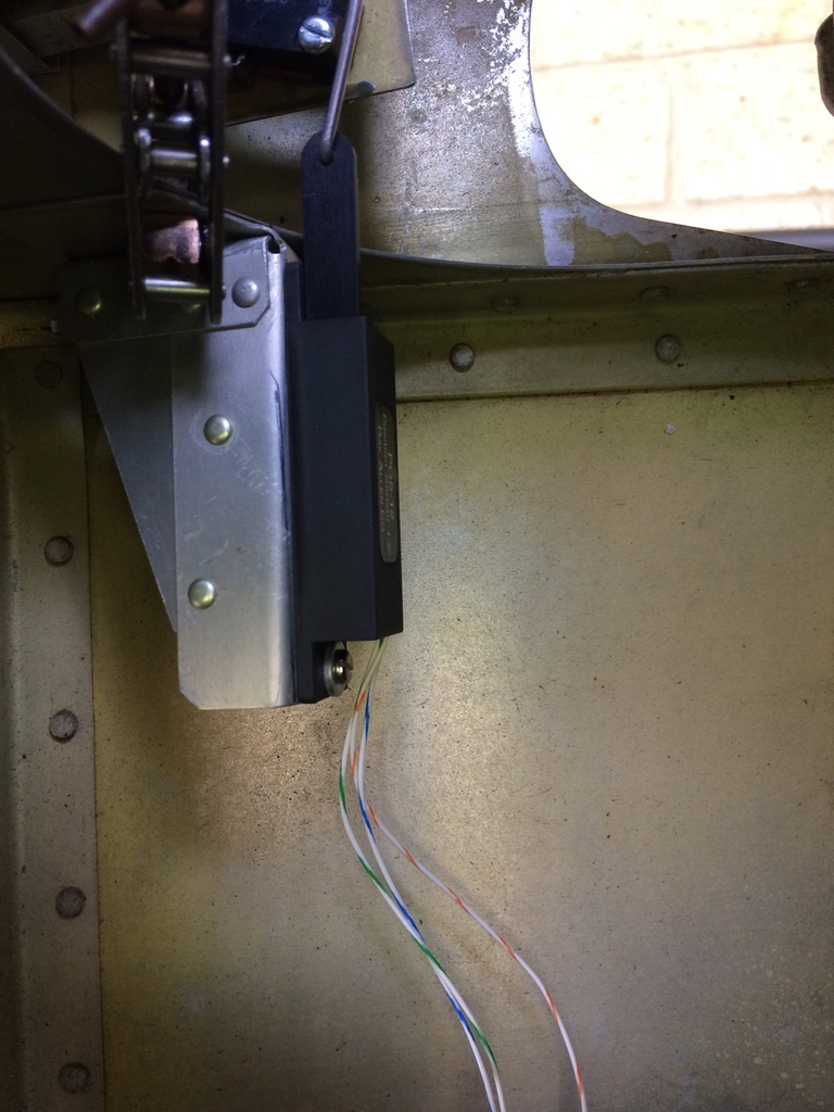

This is the ray allen position sensor mounted on trim arm. It travels the full movement of the sensor for the display.
