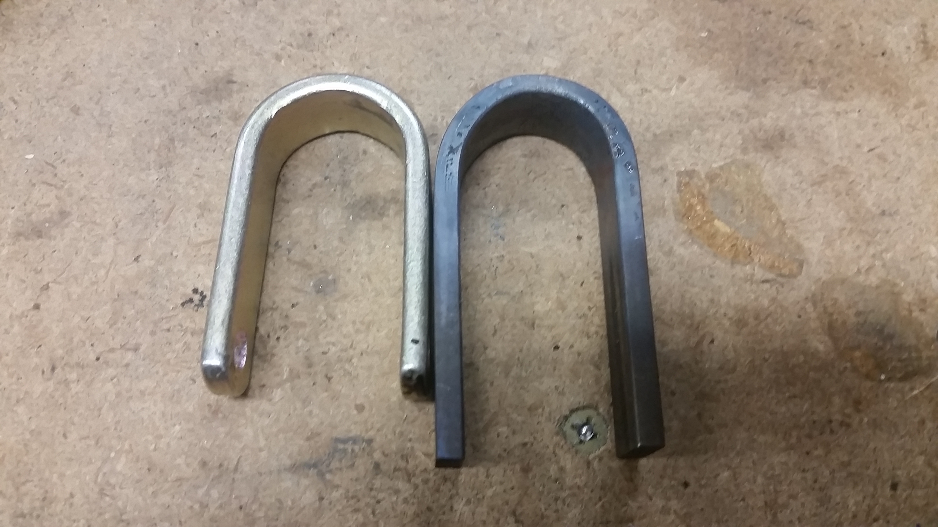

* Had a great time Monday night making engine lift rings at Rostraver airport with some EAA (Experimental Aircraft Association) Chapter 45 buddies.
* I removed the prop and flywheel to clean them up.

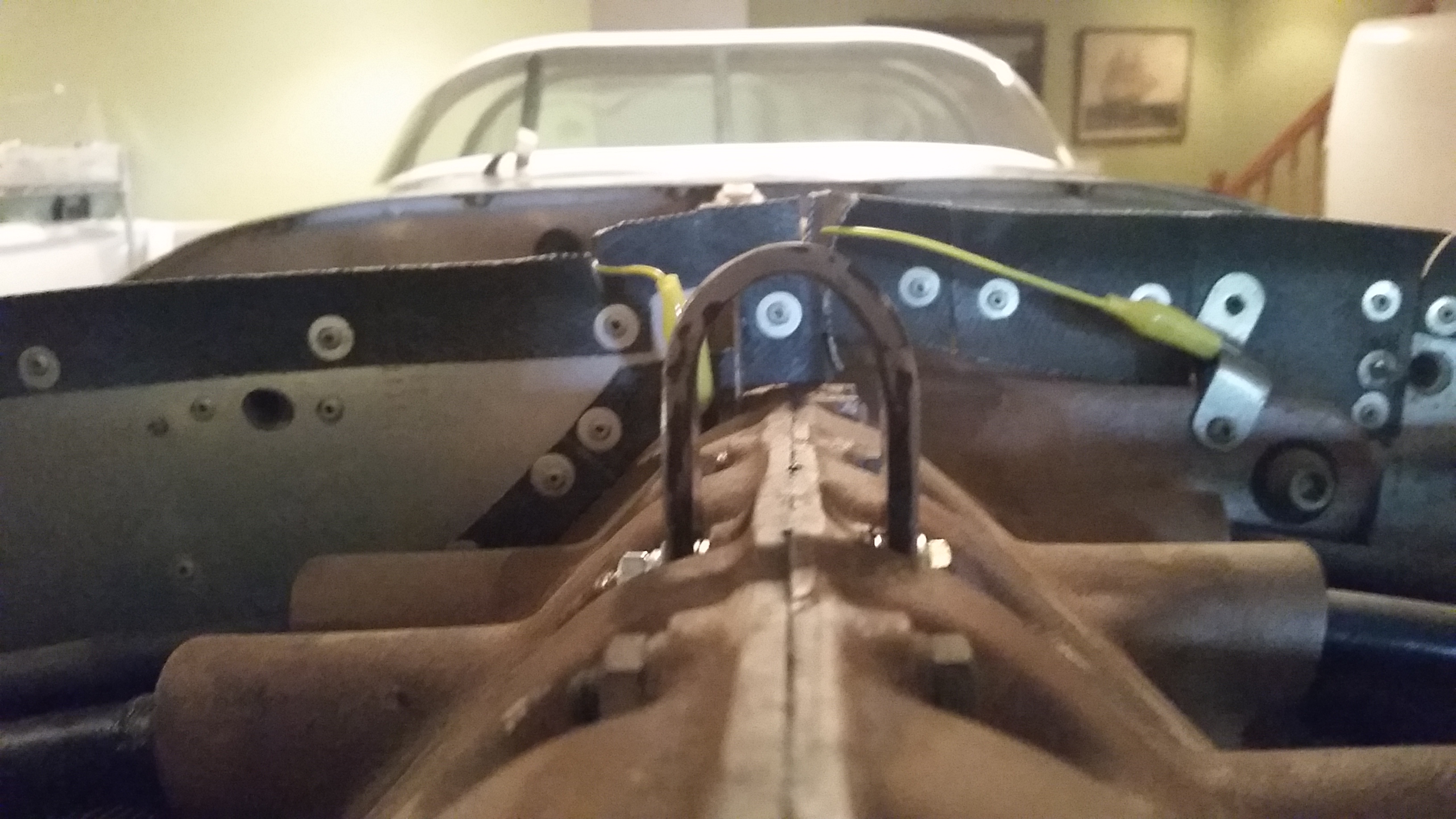

* Installed the lift ring onto the engine.
* I want to replace all the engine mount bolts so I made a list of what's needed from the plans. Both my plane and the plans use AN365 fiber stop nuts. On my list, I changed them to AN363's and ordered those instead due to heat in the engine compartment. Is this the proper substitute? I did the same nut replacement at the top of the main gear A-frame.

File comment: Home-brew lift ring installed
File comment: One of our copies is shown (below the original) before trimming the ends, drilling the holes, rounding the edges, and making it look pretty.

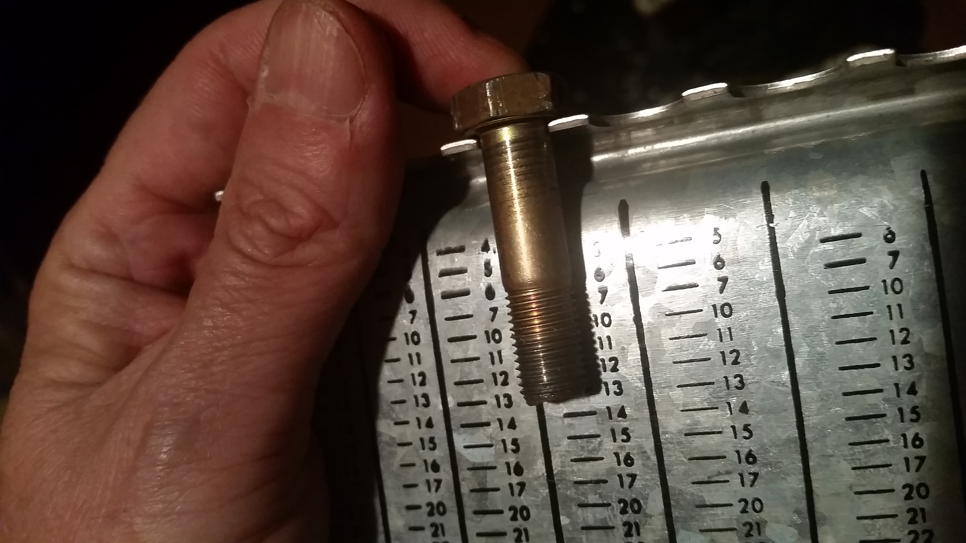

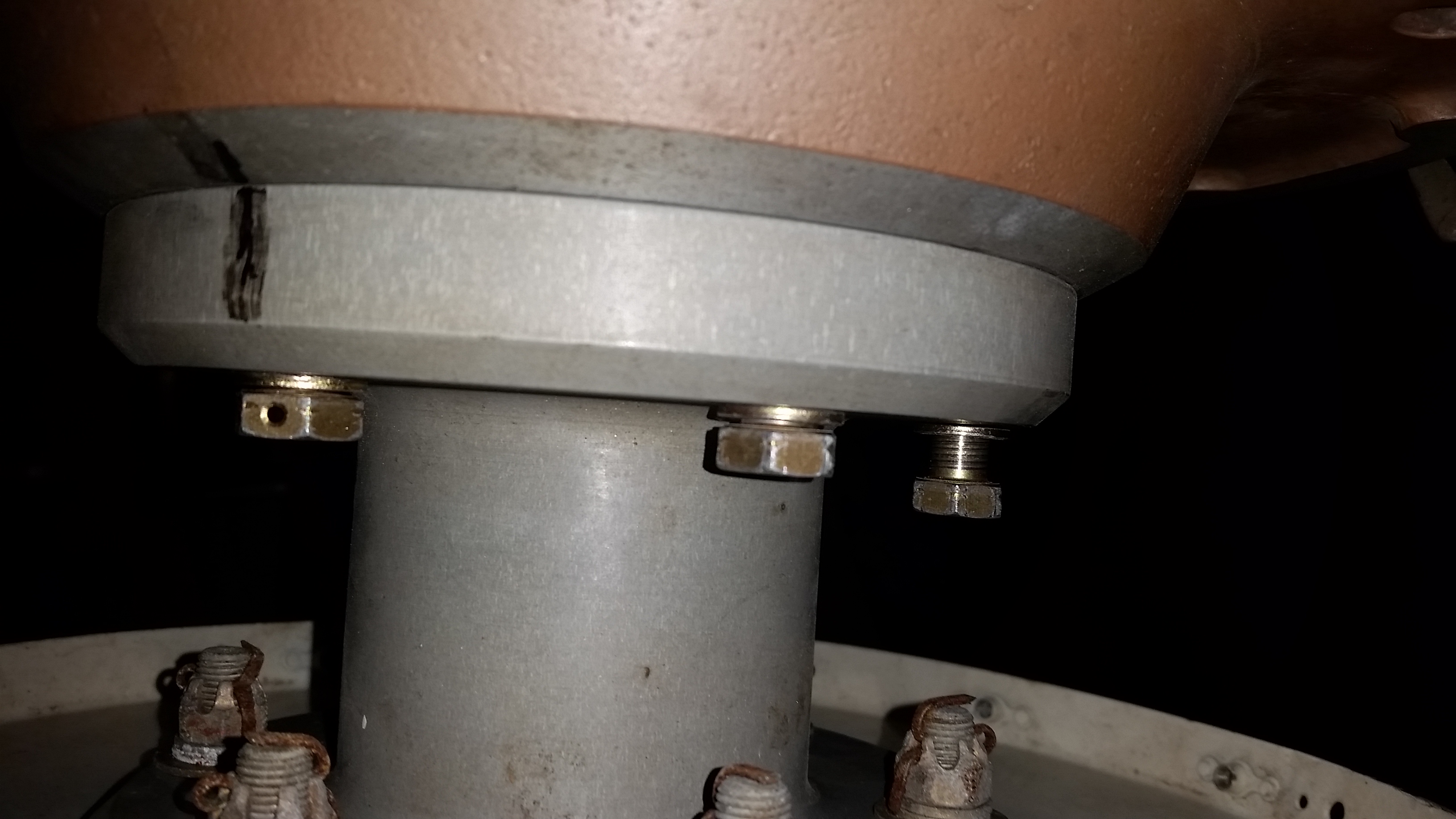

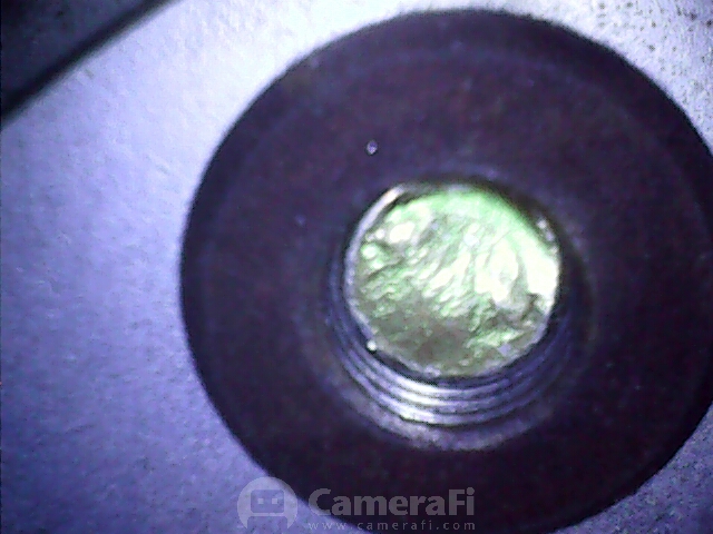

This past week I also found a safety issue with the length of the bolts that mount the prop extension to the engine flange. When I bought the plane, the prop and extension had been removed from the plane and a AN6H-13A bolt was with them that we thought was the proper bolt. However, I used an endoscope last week to check how far the bolt went into the flange lugs and was surprised that it didn't go in far enough. Lesson learned - don't assume that a bolt is proper even if it is provided with the assembly. I purchased longer bolts this week to try.
I purchased both AN6H-14A and AN6H-15A to see which works best. What have you all found is the best length where you engage the most lug threads without the shank contacting the threads?
File comment: The endoscope inspection revealed that there were not enough threads engaged with the AN6H-13A bolts.
File comment: You can see here by the discoloration how far the AN6H-13A bolt threads engaged the threads in the flange lug. I need to order 1 or 2 lengths longer. I ended up buying both to see which fits better.
File comment: As a double-check, I decided to see at what point the threads became engaged when removing the prop extension and prop. See the bottom bolt.

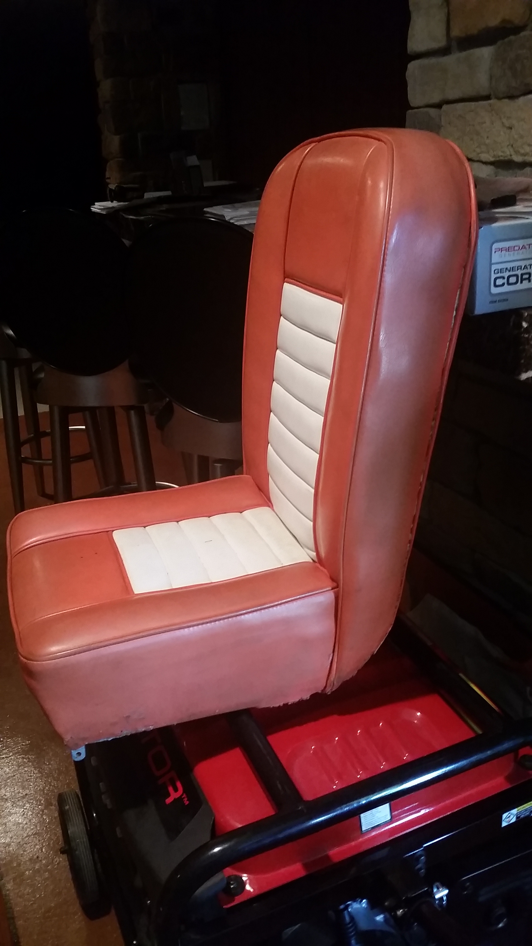

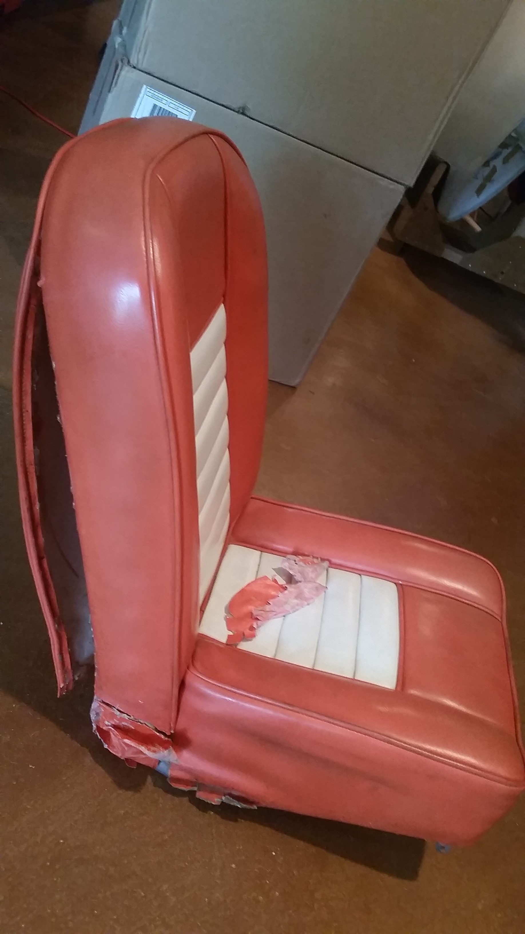

I sent the co-pilot seat out to get the vinyl covering re-glued and cleaned up a couple weeks ago. Got it back this week and am very happy with how it turned out. Sent the pilot seat out to get done the same way this week. I'm keeping the same, original vinyl so I can get it back flying sooner. I'd like to have headrests, but they'll have to wait.
I asked the guy what is best to use on vinyl to clean the white area. He said to use "Bleach White Whitewall Cleaner". If I have to restore any of the orange vinyl he told me to use "SEM" vinyl dye.
File comment: The pilot seat before being sent out to be re-done. Note the "spare parts".
File comment: The co-pilot seat after being re-done. It was in bad shape when I sent it out.

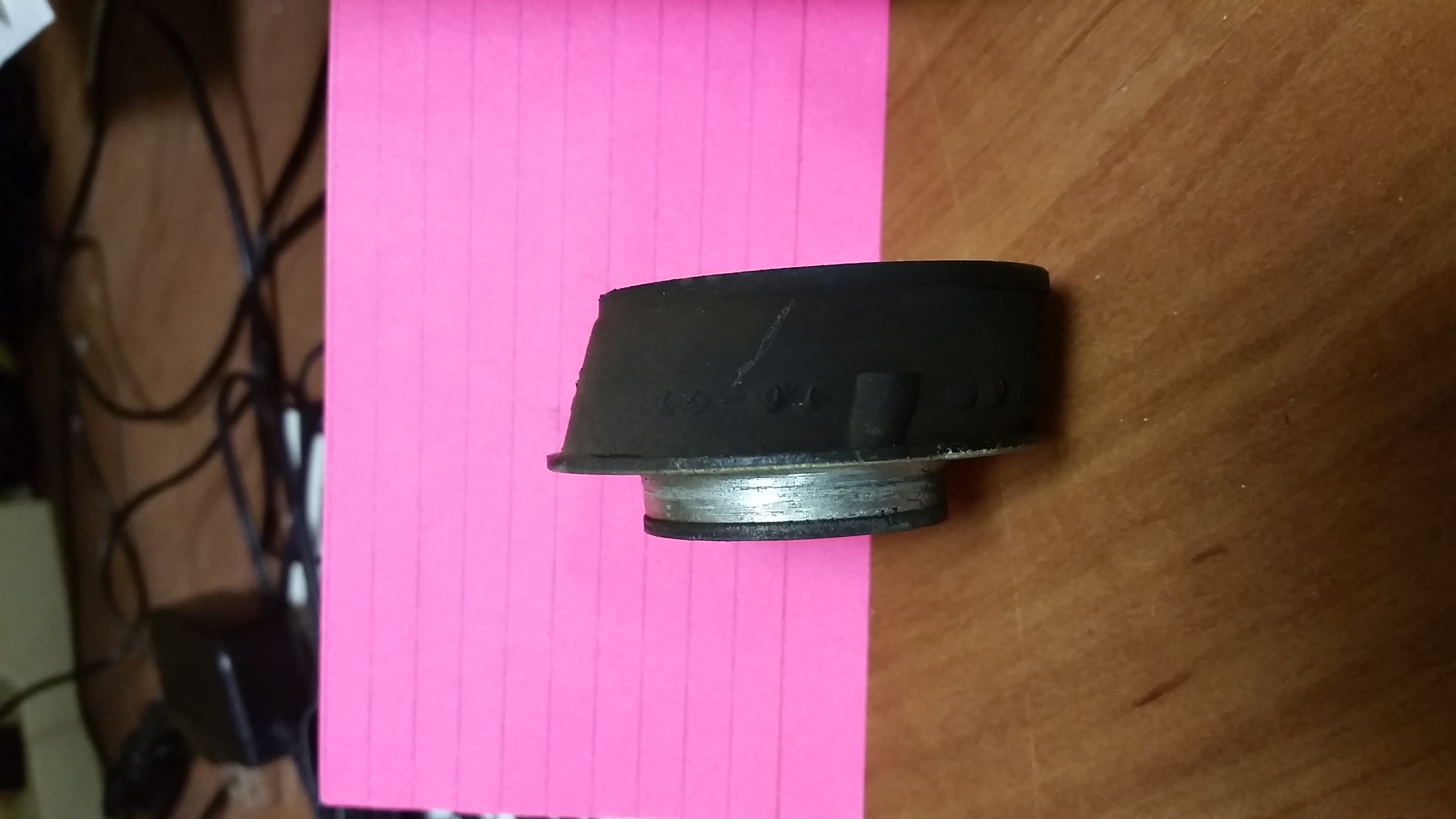

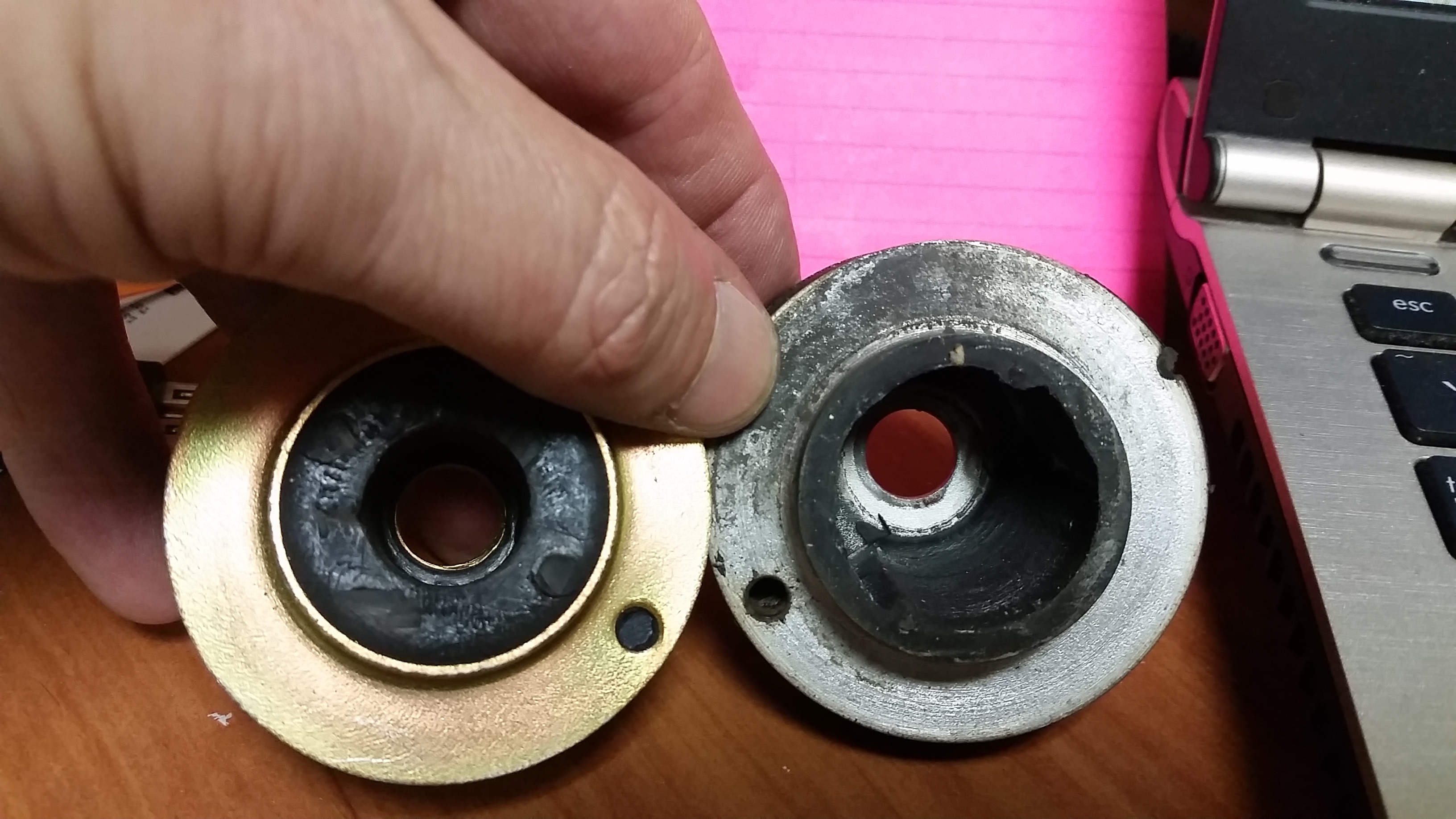

This is the reason why I removed the engine. The rubber engine shock mounts were sagging really badly. Severe mis-alignment from years of age. I'm not sure if they are from when the plane was built in 1974, but they were the original Lord mounts (J-7401-3) specified in the plans on sheet 479. I don't see anything in the log books regarding their change-out.
Anyway, as stated elsewhere, I'm replacing them with Aircraft Spruce part # 08-03600 which is the beefed up version of their 08-3500, which is their equivalent to Lord mount J-7402-5. I'm so glad you guys are so helpful because, as a newbie, I really struggled to figure out what to get.
File comment: Front-view and side by side comparison of the new, beefier mount (left) compared to the old one (right). Note that the one on the right is the same mount as in the side-view image below.
File comment: Side-view of one of the old Lord mounts with years of weight on it resulting in sagging. The center of the small hole is approx 3/8" or more off-center.

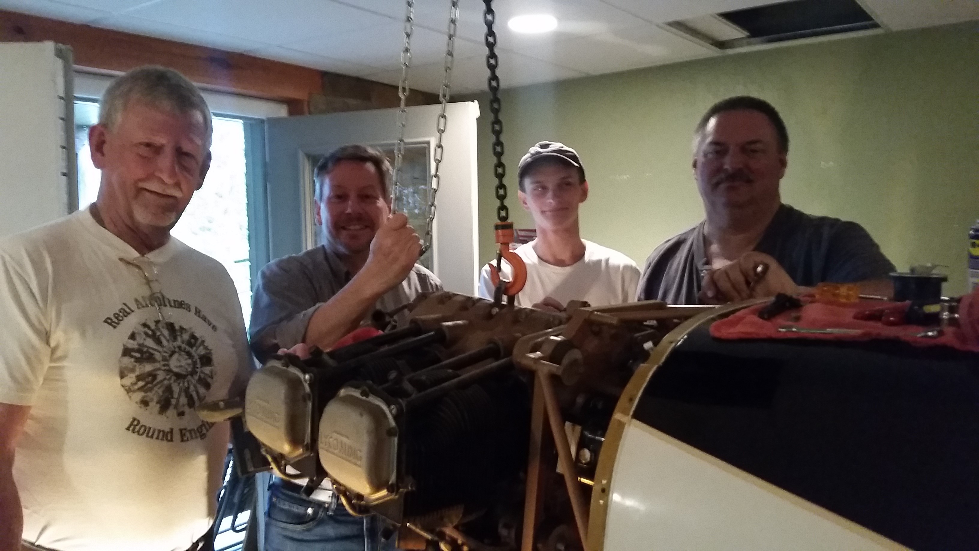

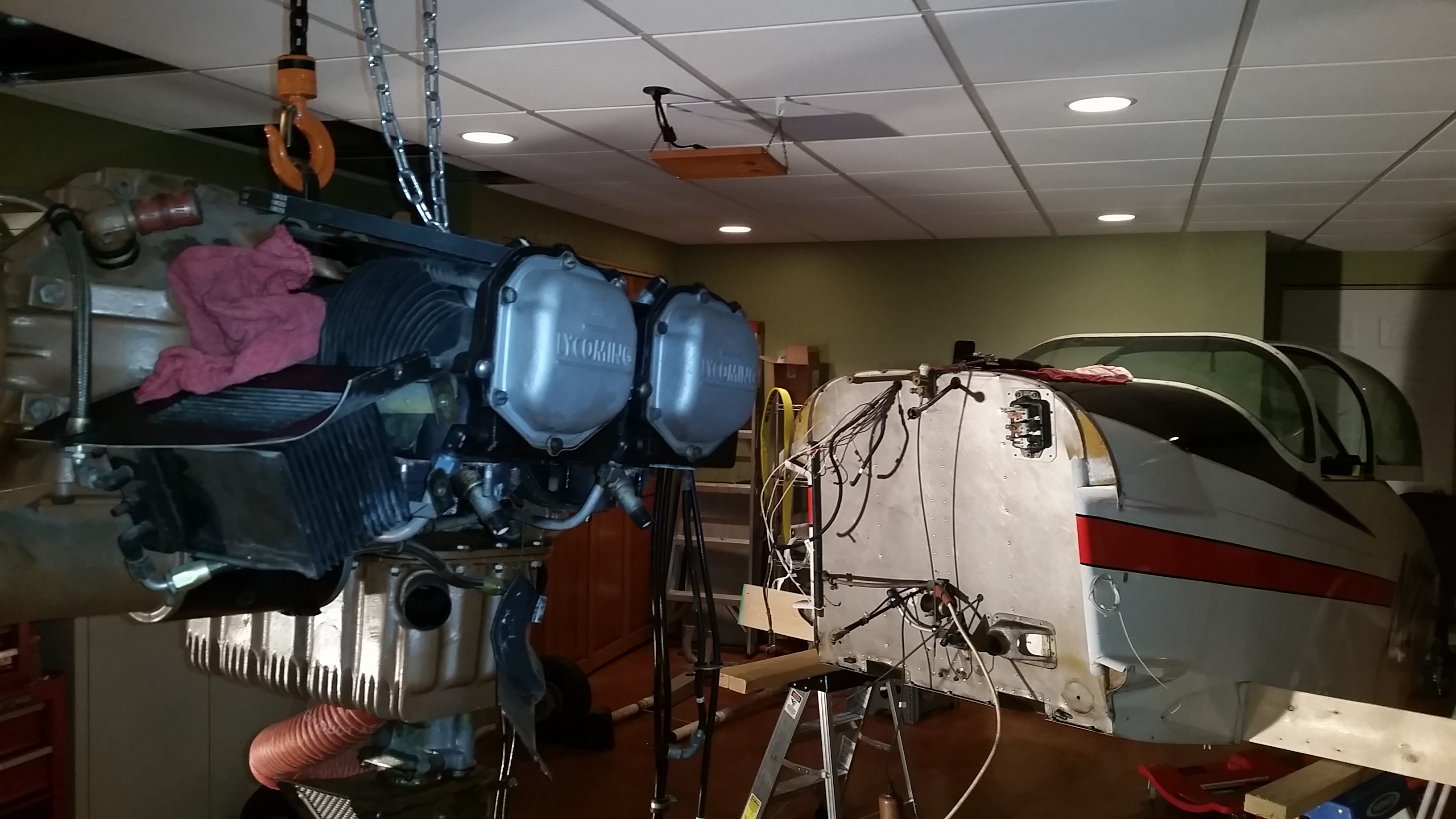

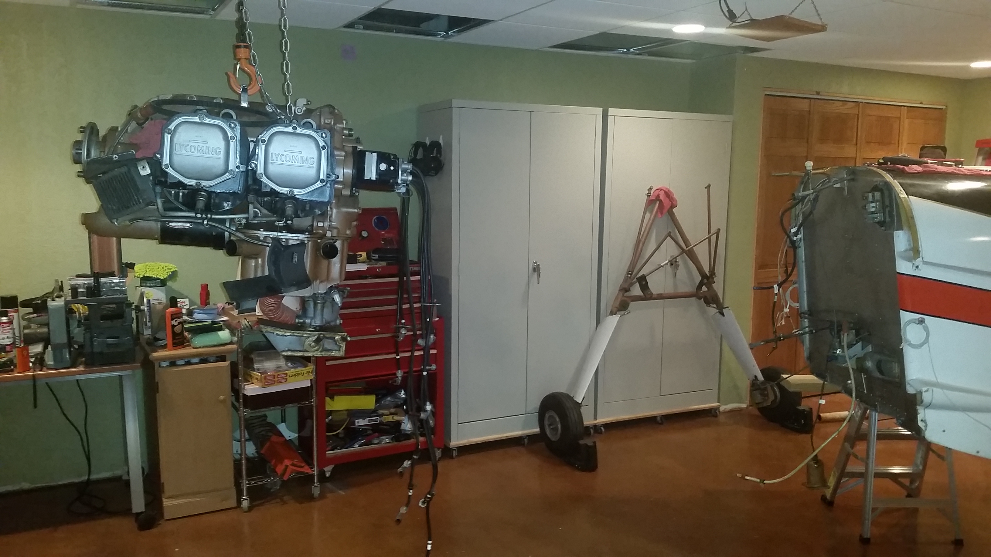

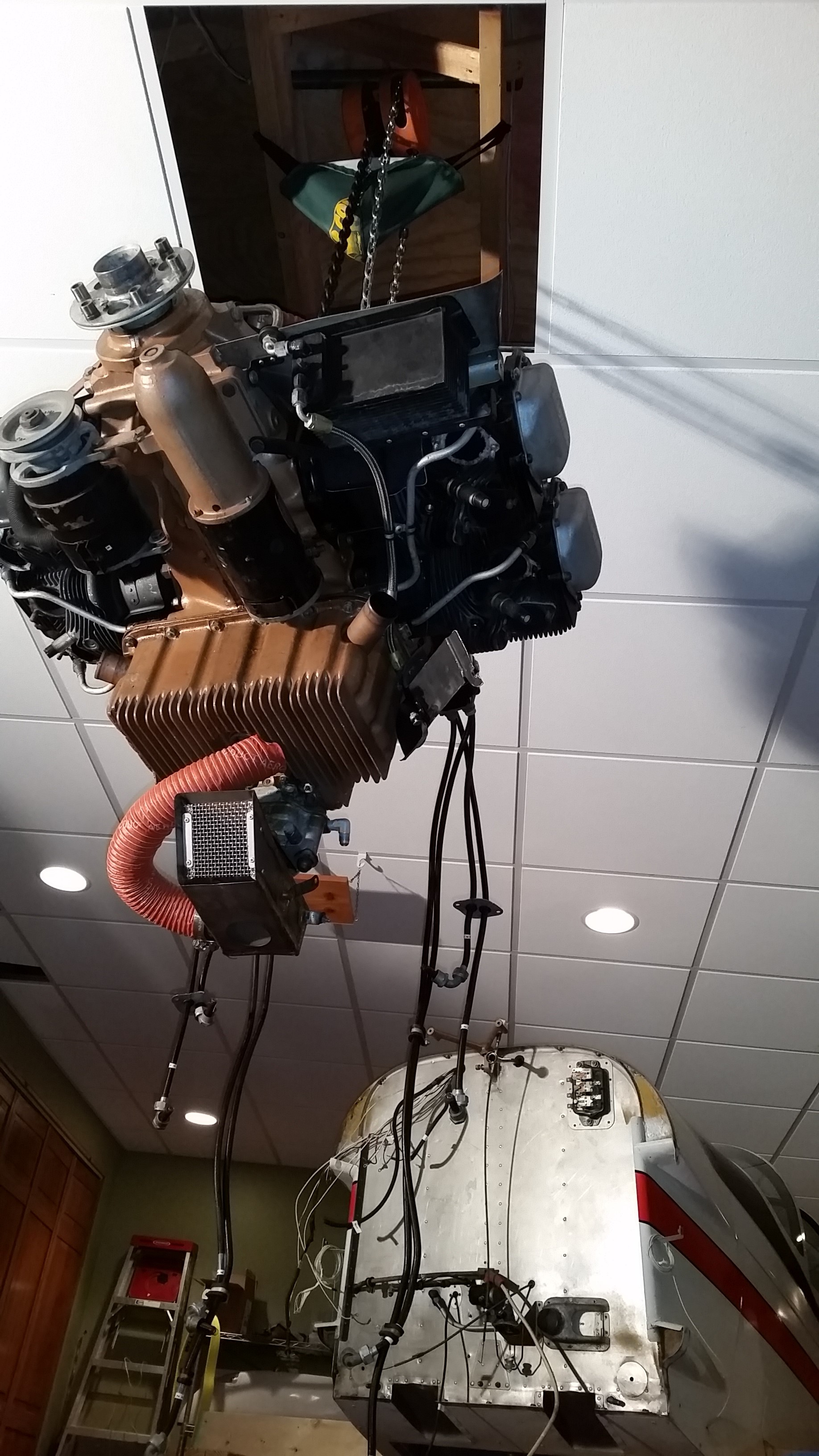

Tonight some of my EAA Chapter 45 buddies came over and we pulled the engine and the main gear off the fuselage. Five buddies and 5 hours later...
File comment: Getting ready to lift and remove the engine
