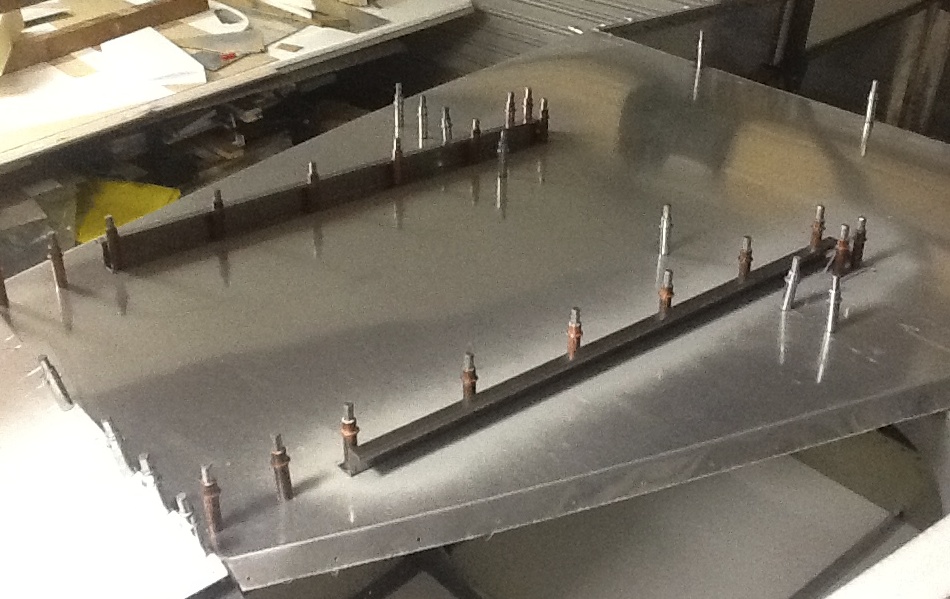

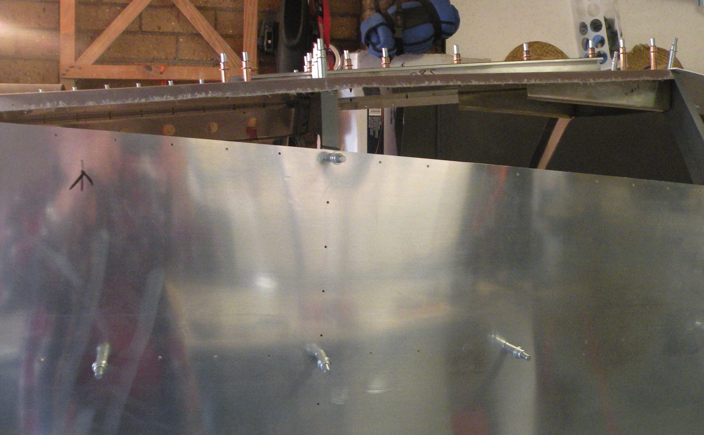

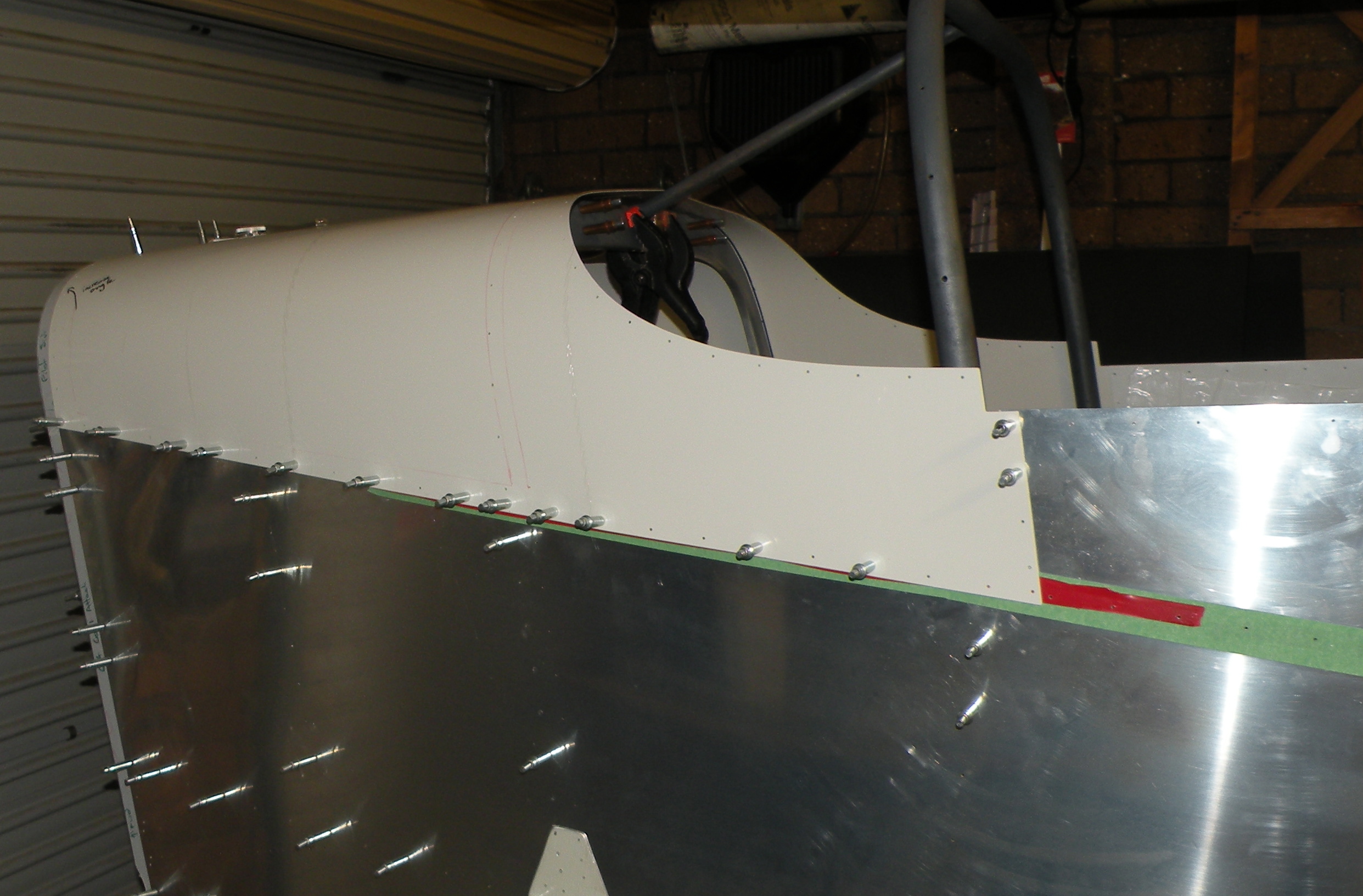

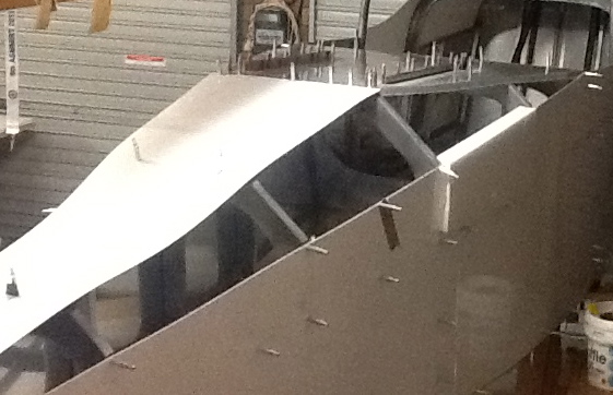

Recently we managed to make some progress by fitting the 669 deck. We were confused for a while as the fitting at the forward end under the canopy track is not provided and not shown on some drawings. After getting advice we ended up making up a part from scratch. Also it seems that extending the fitting 580-16-A that fits under the rear of canopy track so that it extends forward to the next frame is also a recommend modification. Am yet to remake that part.
While not much has happened on the aircraft itself we now have all the skin panels except the hip skins converted into CAD suitable for CNC cutting.
Our first Thorp might be taking years to put together but the second will be a breeze.
