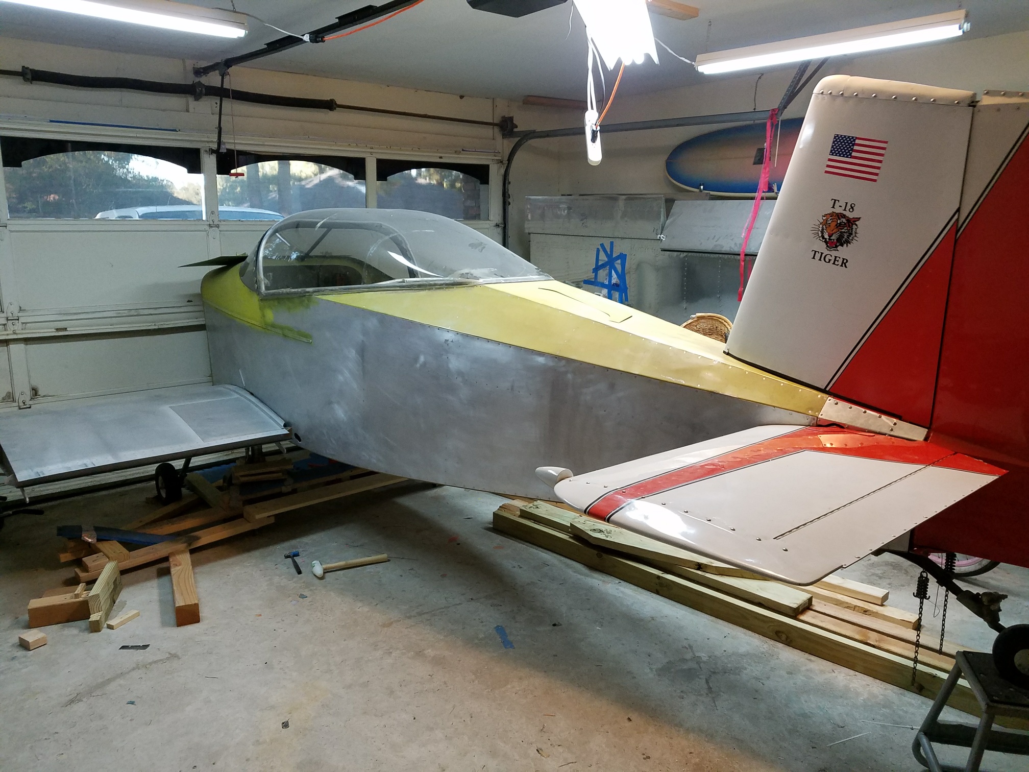

I feel like I'm about ready to pull it out of the garage and go fly!
PostPosted: Sun Oct 29, 2017 6:51 pm
Nice! The ends are cut back so you can get a bucking bar in to rivet.

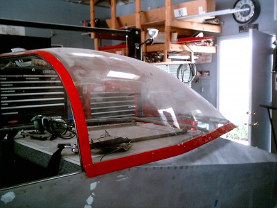

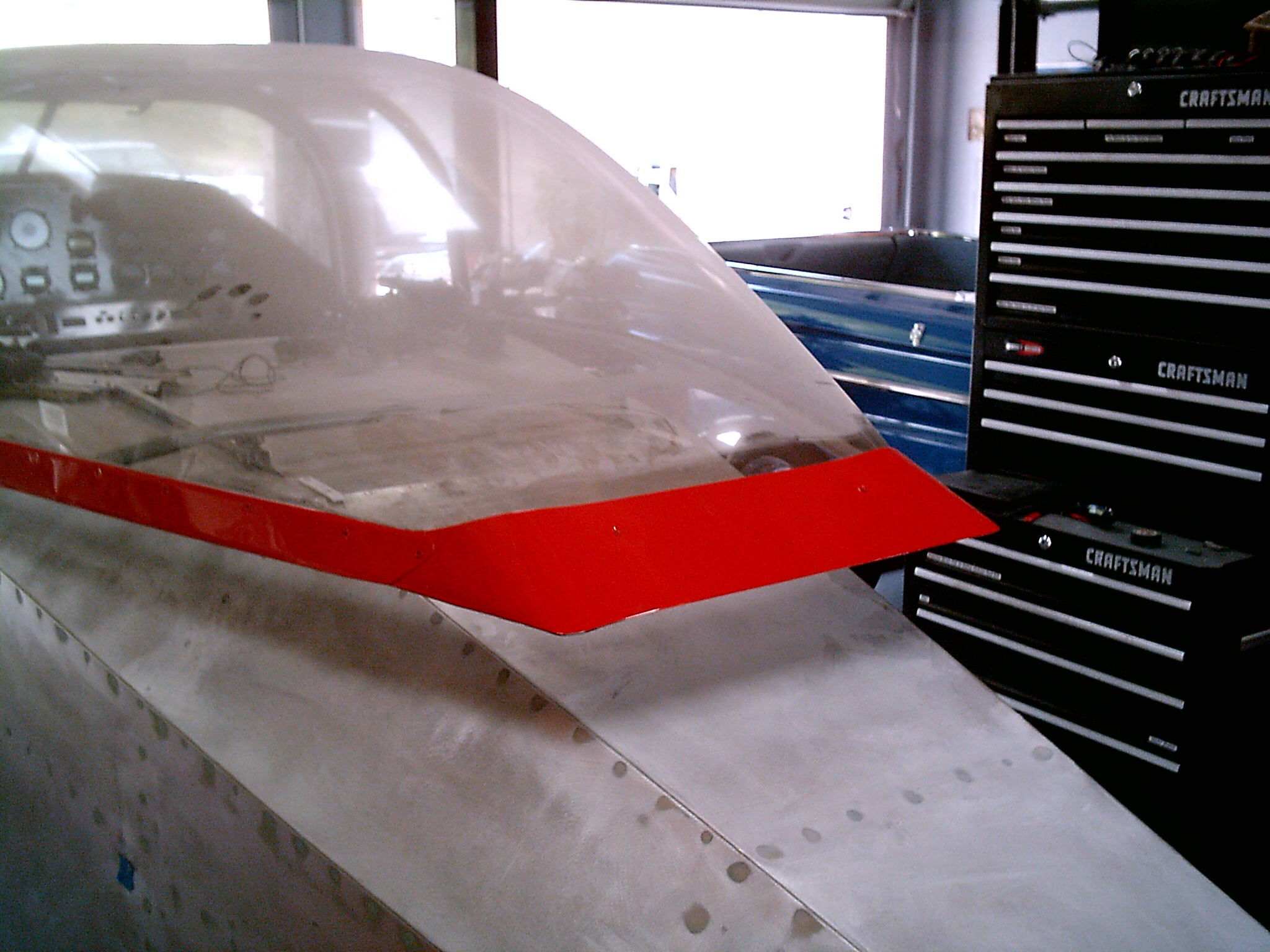

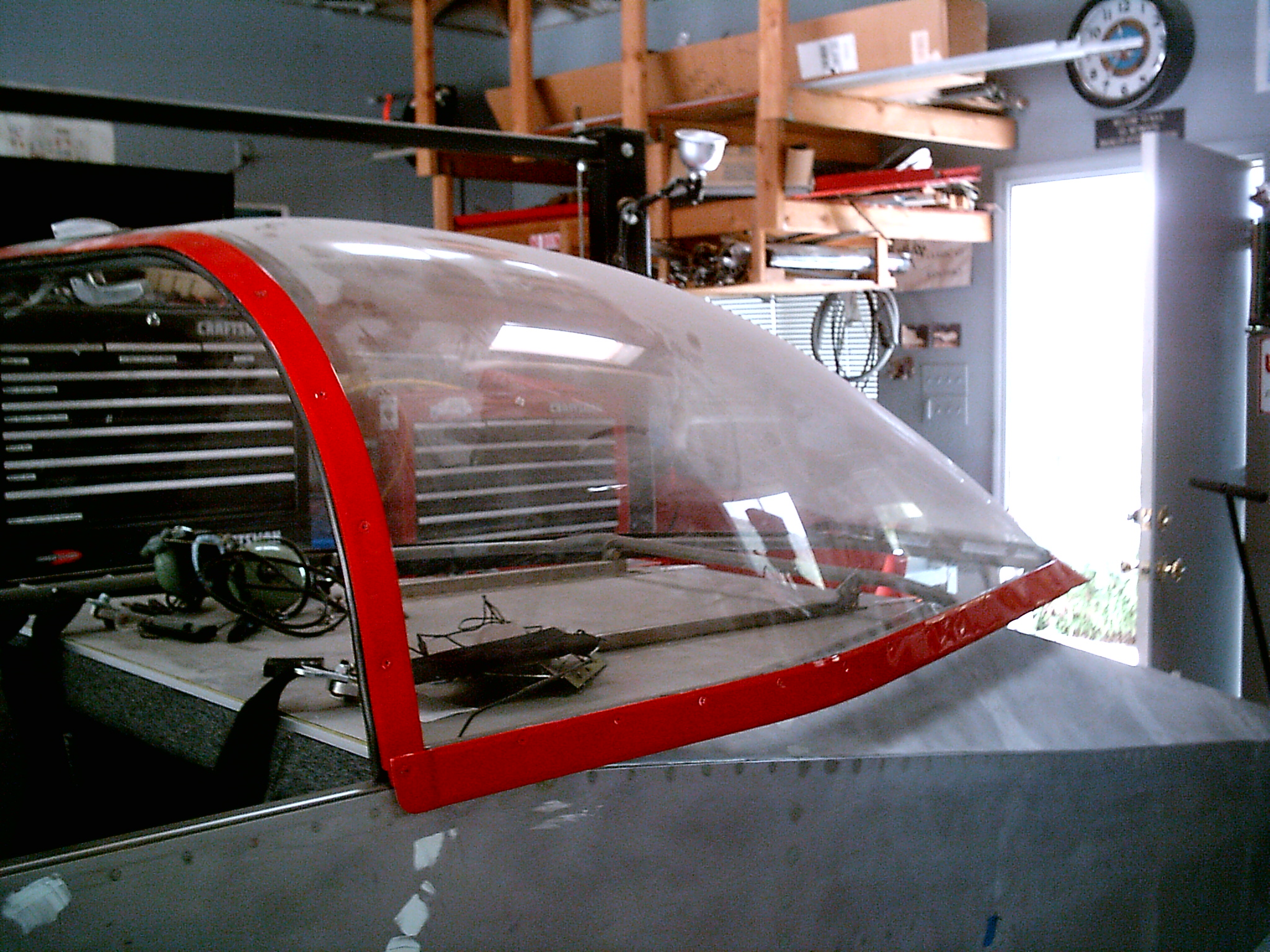

PostPosted: Tue Jan 02, 2018 11:14 am
Posts: 1173
If anyone has any tips about cutting/fitting/installing the canopy skirt, I would be all ears. Or if you did a write up anywhere, I would like to read it. I am leaning towards installing the canopy with sika, not that it should affect installing the skirt.
PostPosted: Tue Jan 02, 2018 2:42 pm
I used large sheets of poster board . Cut them into EXTRA wide strips taped them together and then fine tuned them to the size (width) I wanted . Takes a lot of poster board as it is a compound curve , just like the windscreen roll bar/canopy roll bar strips . ??? Take your time and it will turn out great !! :D
