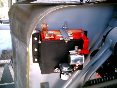

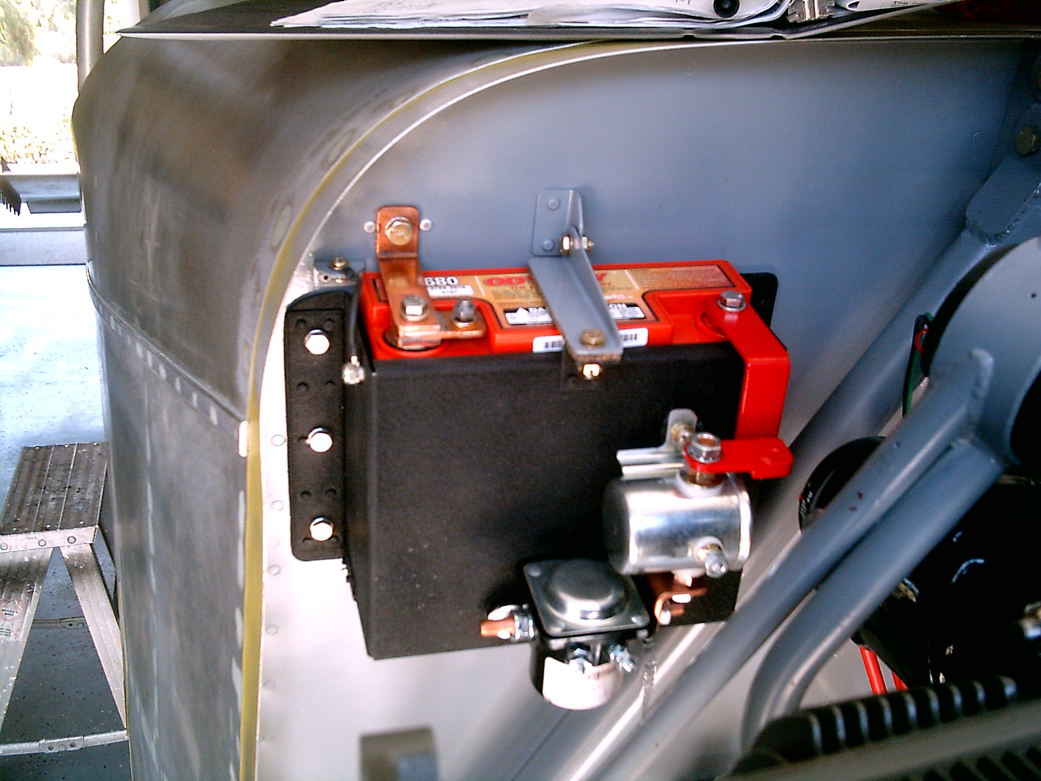

I'm trying to find and prevent problems before I drag old' N12055 back out to the airport in April. The big (to me) issue that I found last night :-[ is that the plane only has a starter solenoid. It does not have a battery solenoid. Therefore, the starter solenoid (and the big cable to it) is always hot regardless of whether the master switch is turned OFF. Was this typical for the '70's homebuilts?
Anyway, this is a mandatory change in my mind. Where do you guys mount your battery cut-off solenoid? I was thinking of mounting it inside the battery box (which is in the baggage compartment) because the new PC680 battery is so much smaller than the box. Or, outside the box on the forward side of it. There is a good 6" of space there that I could protect it from coming into contact with baggage (metal buckles, etc.)
That is not typical of 70's homebuilts. All aircraft should have a "master solenoid" relay. Are you saying that main power from the battery is being controlled directly by a switch? The starter solenoid should be downstream of the master. As far as where to mount everything, would the starter solenoid be easier to access for service, etc. if mounted on the outside of the box? There are other reasons that it should probably be outside, in my opinion. For whatever it's worth, my master solenoid is mounted on the outside of my battery box (behind the baggage compartment). I ran a heavy wire (#4 AWG) from there forward to the engine side of the firewall, where it connects to the starter solenoid which is mounted there. A smaller (#10) wire connects at that same point and goes back through the firewall to my main power buss for the instrument panel. The starter solenoid mounted in that location provides a good connection point (the "in" terminal) for the "B" lead from the alternator also. That particular arrangement was chosen also because it resulted in the shortest wire run for the main buss supply - the heavy #4 wire had to come all the way forward anyway. These choices were to try to accomplish maximum efficiency with the least weight. I believe that many T-18s use the same set-up as I did.

I agree with John . Here is my set up I mounted on the firewall . I used solid copper bar material from the + battery terminal to the "Master" solenoid and then another short copper bar from the MS to the "Starter" solenoid . This avoided using short lengths of wire with attached terminal lugs . With the battery on the firewall it also meant a very short wire run from the SS to the starter . I also ran a ground wire from the - battery terminal to the engine block . 200 + hours and no problems to date .
rjaeger

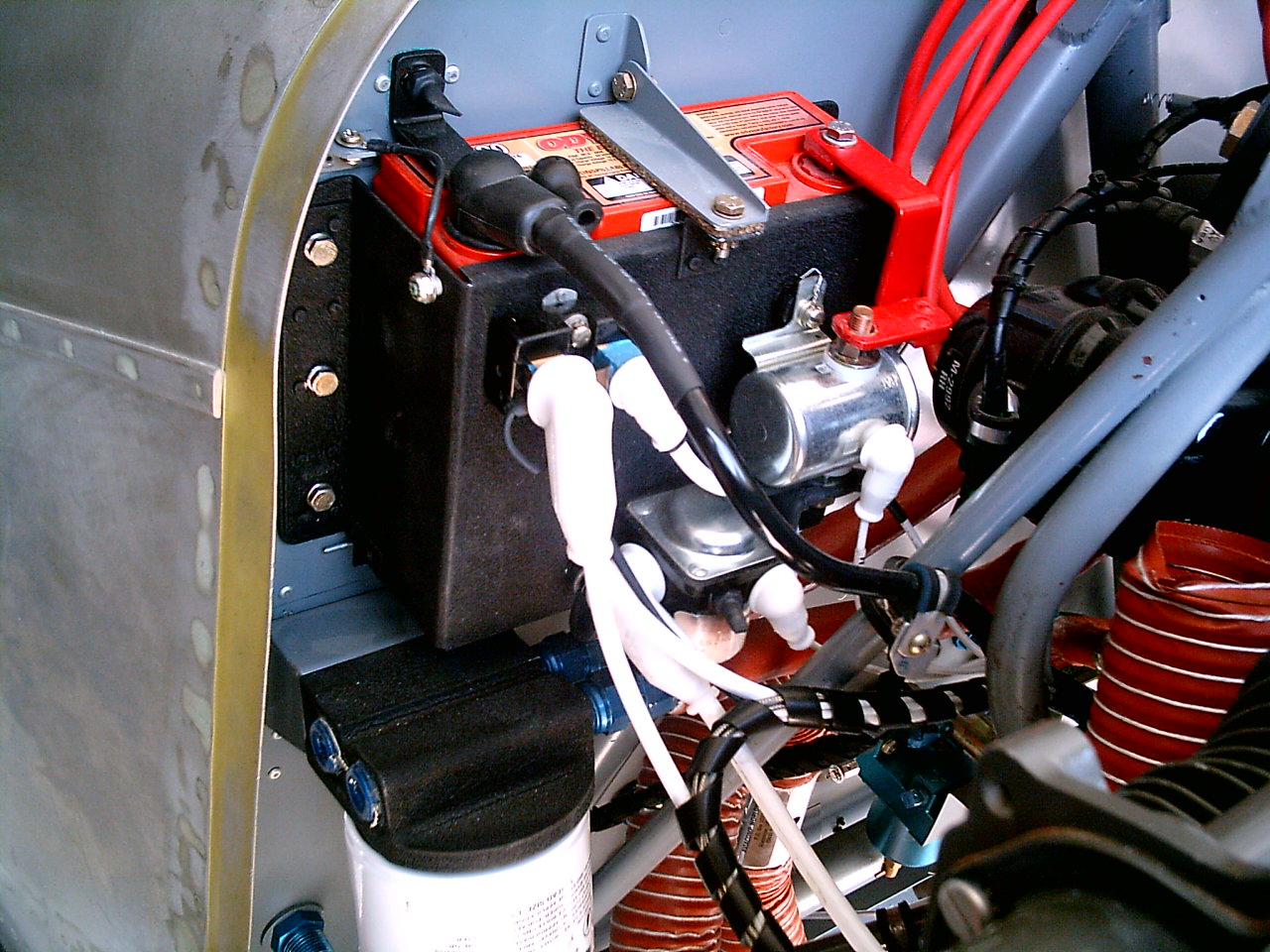

jrevens - Hi John, sorry I wasn't clear. I was saying that the #4 gauge cable from the battery goes directly through the passenger cabin and under the fuel tank to the starter solenoid. Further, since there is no switch for it, that cable is hot all the time regardless of the position of the master switch. Not a good design to have in an accident so I want to isolate the battery which is in my baggage compartment. At the starter solenoid, I have a similar #10 wire going back through the firewall to, in my case, the master switch and then the main power bus. I understand your description of your setup now and I'll copy it for mine when I put the master solenoid in.
Bruce - Your picture convinced me to go to the outside of the box. It makes the most sense, doesn't it?
Rich - Wow. What is the device mounted on the outside of your battery box in the upper left hand corner (as shown in the picture with the wires hooked up)? An electrical filter of some sort?

John: DC shunt for the amp meter .
