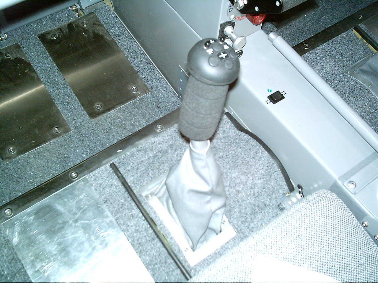

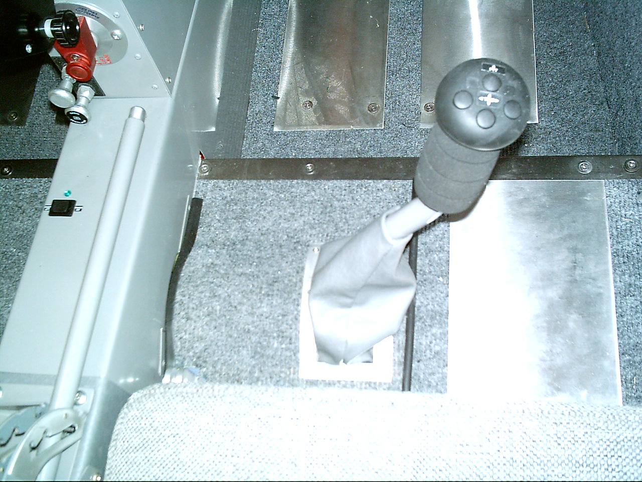

PostPosted: Fri Mar 04, 2016 8:10 pm
Glad you found a set to fit . I bought several parts store boots and spent hours online trying to find something that would work . I eventually used some of my heavy duty vinyl material from my seats and side panels and rolled them into a cone and had the local shoe genie sew up one side and then mounted them in a "rounded" cut out piece of 0.050 aluminum . I got the idea to round the piece from Danny Boy. Rounding the piece I was able to clear the stick socket and not have to build a box to raise up the boot . Gave me a couple of inches around the floor area . It has held up fine for 5 years . Still have enough material for a few more . ;)

Hey, does anyone know where I can get a spare boot for my master brake cylinder? I have exactly what Terry has in the second photo.
PostPosted: Sat Mar 05, 2016 6:12 pm
Hummmm ? Don't recall seeing any boots on any MC's I've looked at installed in a T-18 ? Sure didn't see any on new cylinders that are listed at ACS . My project may have come with boots on the MC's , but I elected not to install them as it sure looked like to be a pain in the arse to try and bleed the brakes once installed on a completed AC . I'll take a quick look to see if I still have them , but the rubber is over 30 years old and may have foot rot ? New out of the box would be the way to go if you can find them . I'll let yuz know tomorrow . :P
