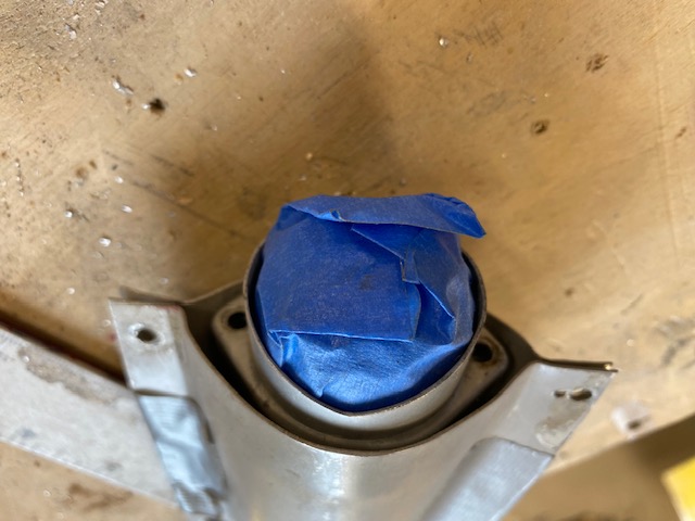

Here is my issue. I cant see the best method to attach the rear nav light to the housing. Any suggestions?

May be this may help? https://www.kitplanes.com/adding-a-taillight-to-a-completed-rudder/
PostPosted: Sun Feb 01, 2026 5:12 pm
Posts: 1173
Interesting, thanks! He used friction to hold the light inside the housing. Unfortunately, I dont think that will work in my case.

I would wrap the light (with some padding if necessary) into several layers of kitchen clingwrap and then fill the housing with epoxy and place the wrapped light there. Once epoxy is cured, you can remove the light, unwrap it and you will have a perfect match shape in the housing to glue or bolt the light in.
You can try this approach with RTV silicone too.
PostPosted: Wed Feb 04, 2026 9:15 am
Posts: 1173
i think i solved my problem, but i may incorporate your epoxy suggestion as trim.
