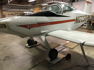

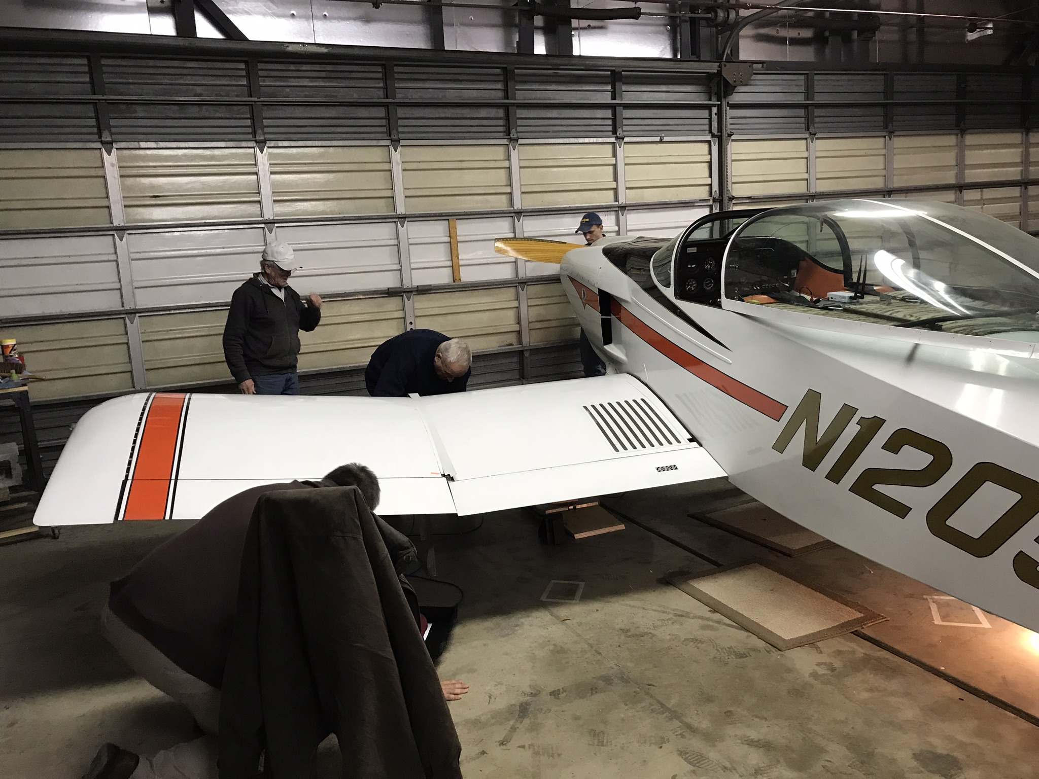

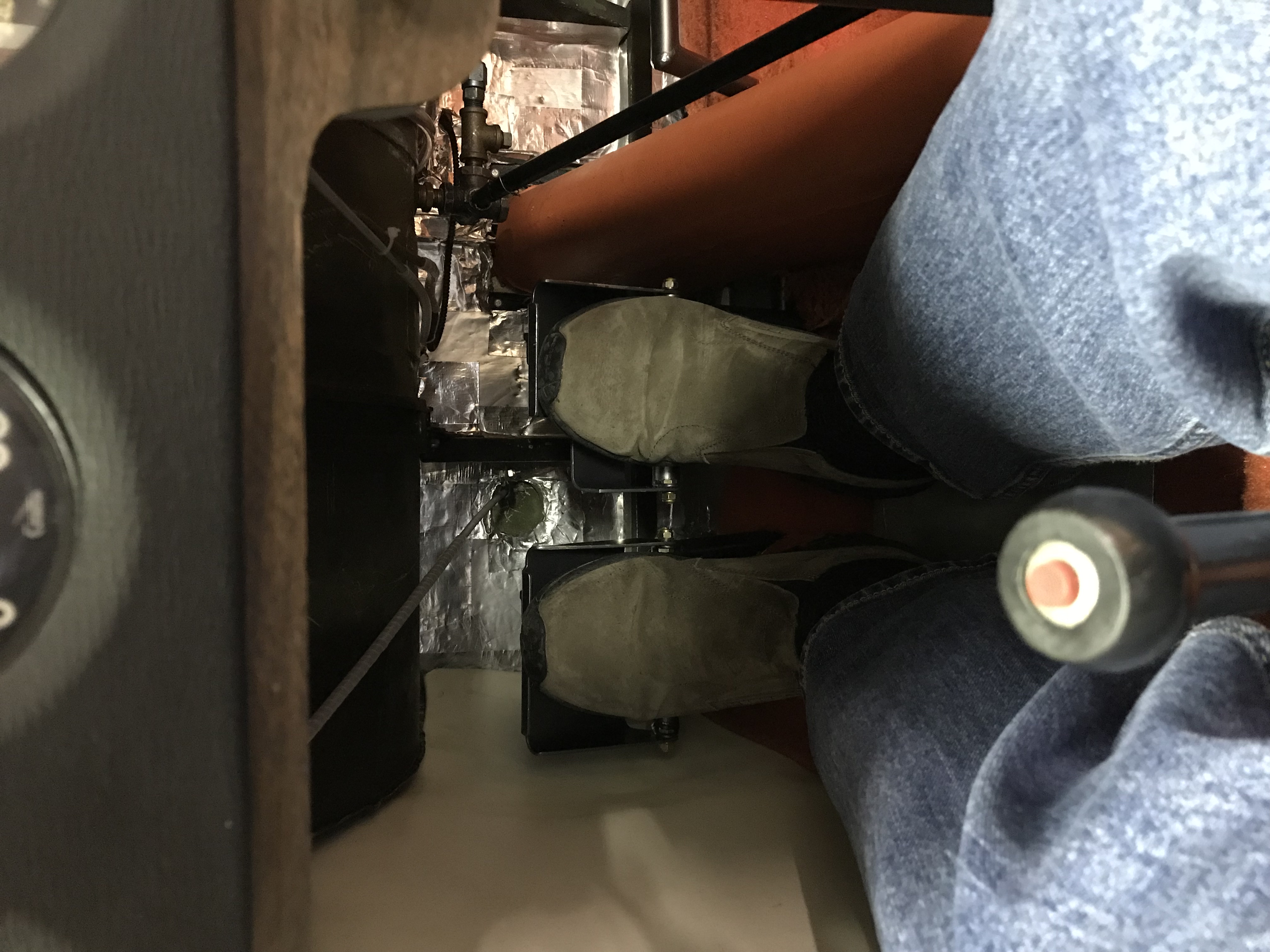

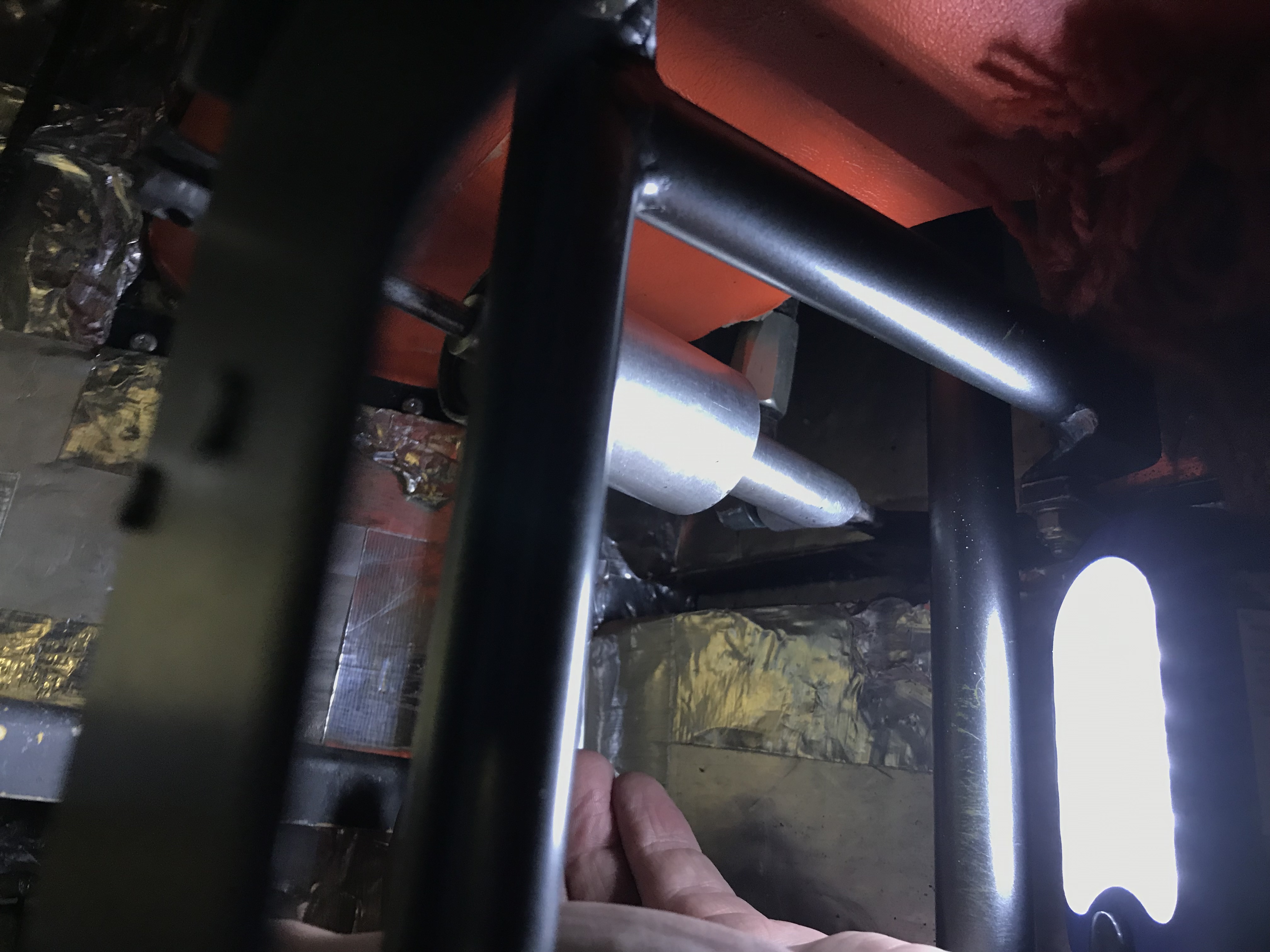

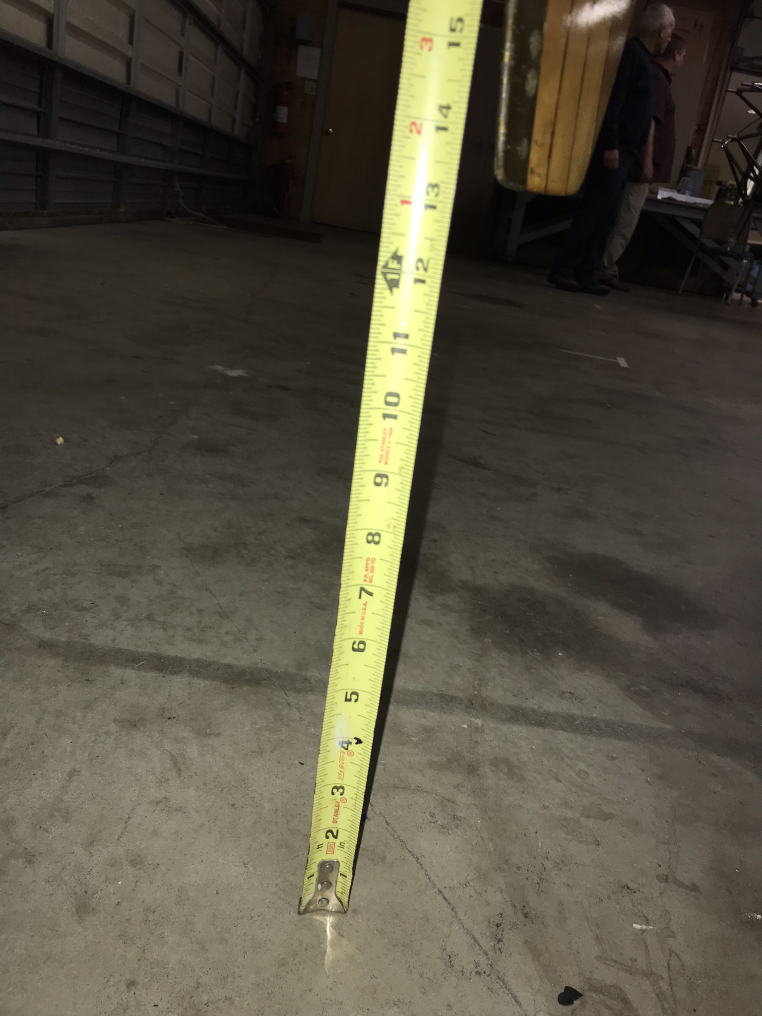

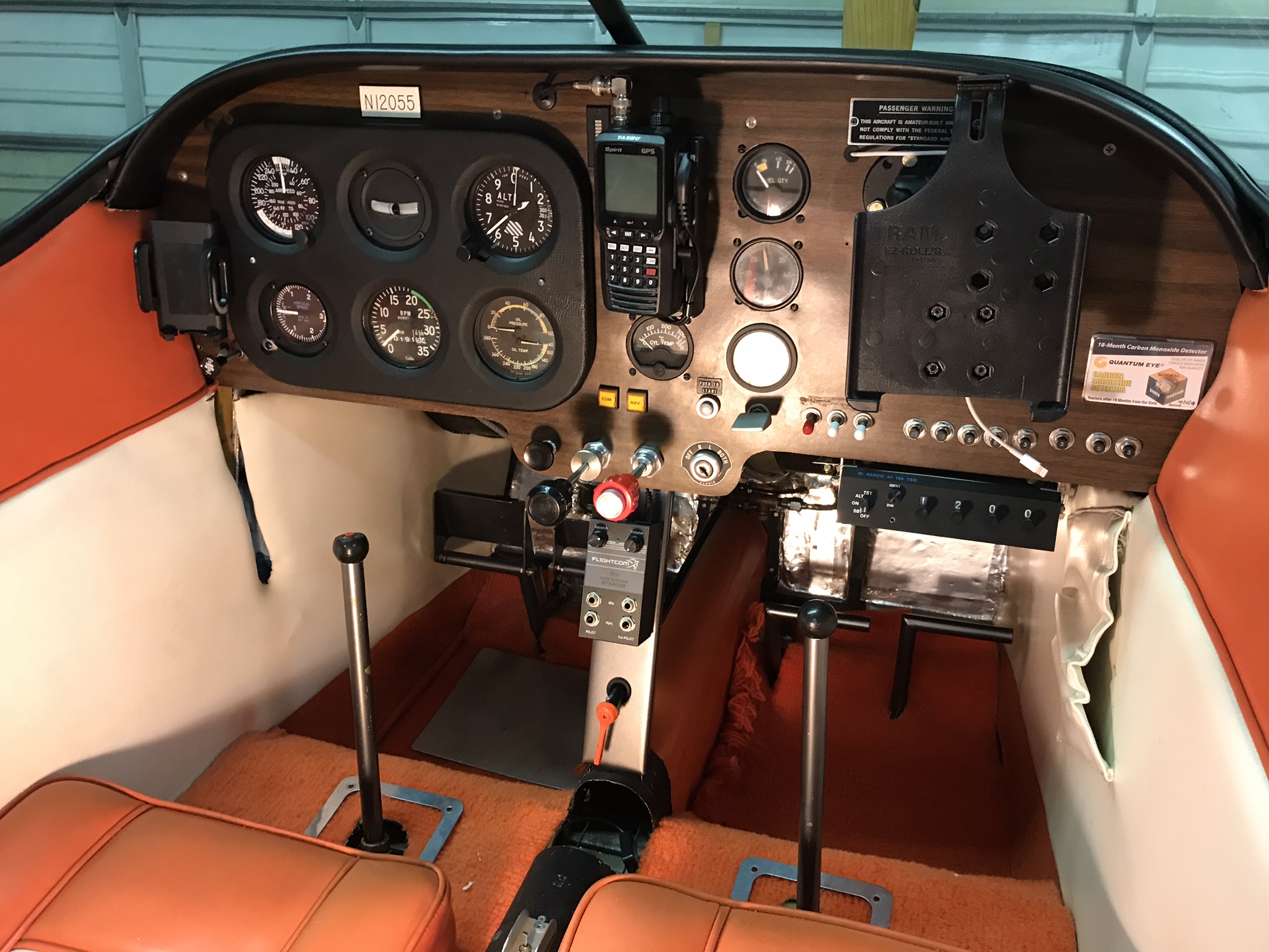

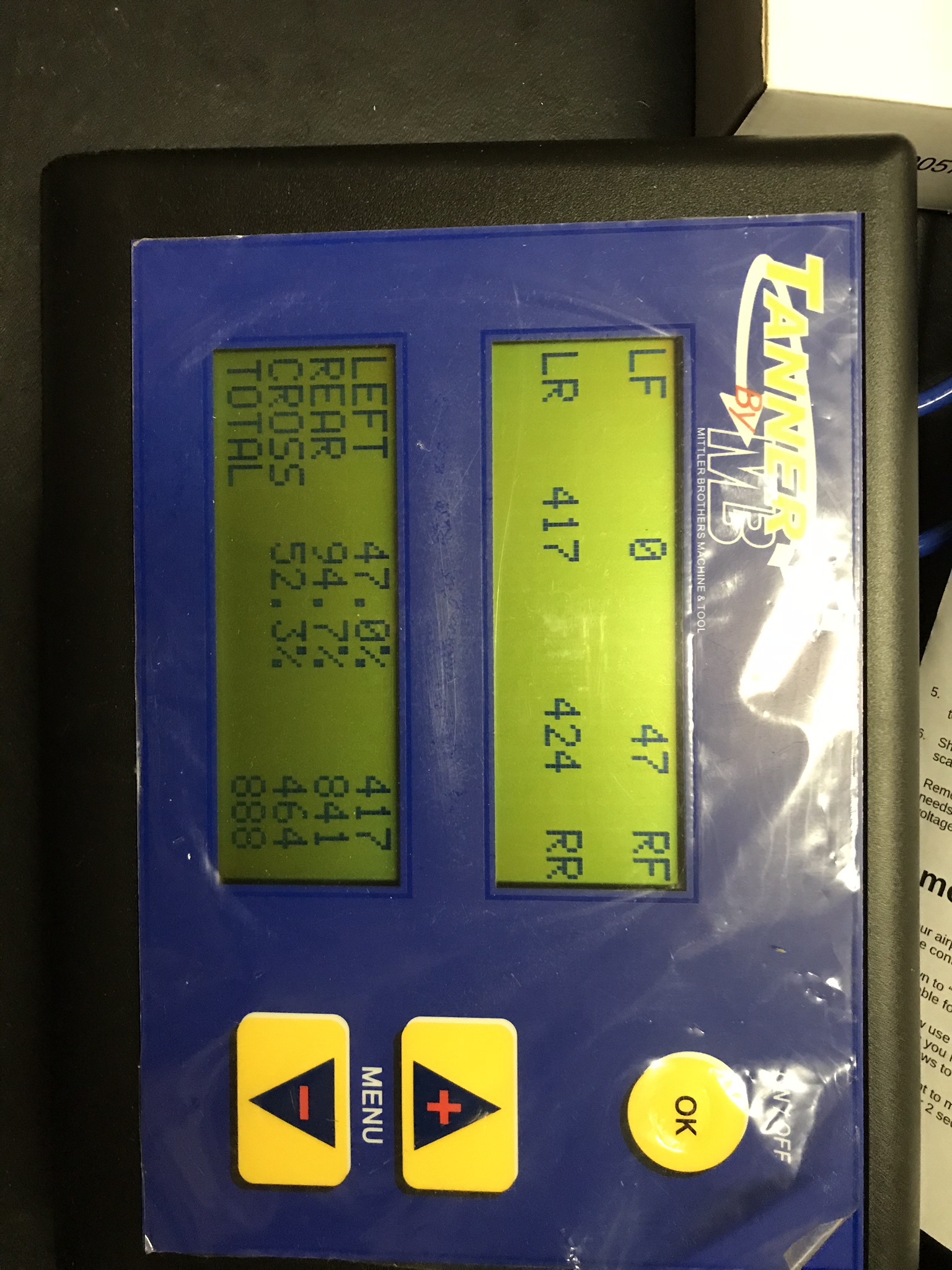

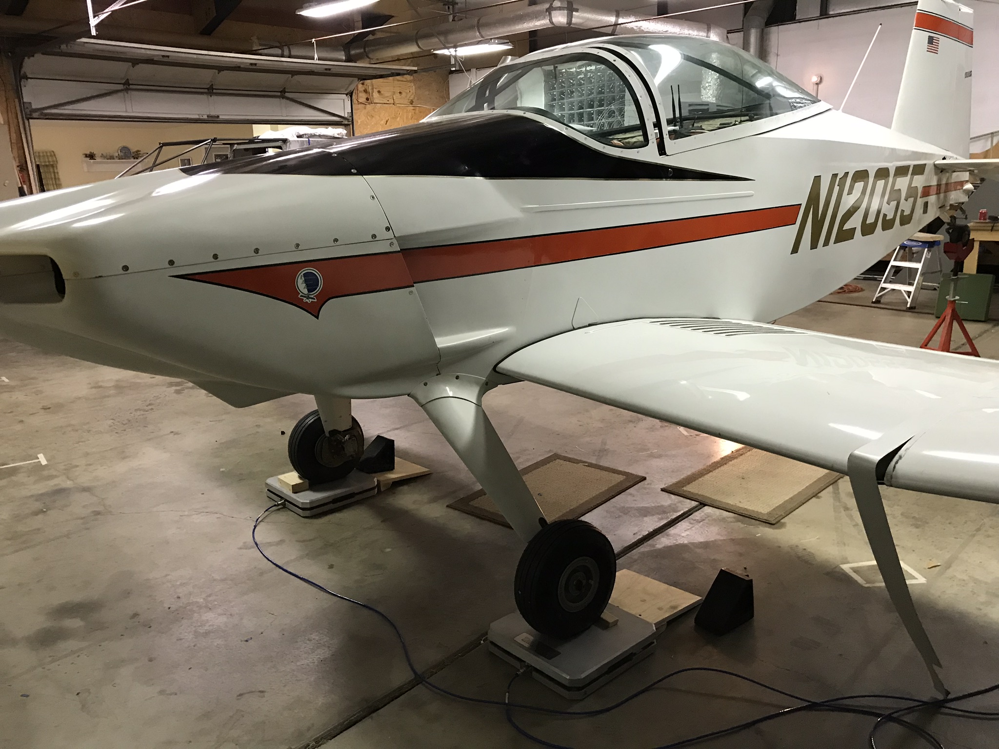

Hi all, I hope everyone had a nice Thanksgiving! N12055 is nearly ready. We did the weight and balance last night after getting the interior put in. Empty weight is 888 lbs with 47 lbs of that on the tail wheel. Prop ground clearance in level configuration is 13.25”. Still a few more punch list items to finish (aren’t there always it seems :o ).

Looking great! It is kind of interesting to lift the tail (hang on cause it will try to over center) until the prop is about 2 inches from terra firma just to see the extreme nose low attitude you have to be in to hit the prop. Of course the gear could spread a little on a nose low hard bounce, but the Thorp gear isn't going to flex much! Even sinks in a little more if you can be sitting in the cockpit when someone else lifts the tail. Helps to reduce the pucker factor if you are apprehensive about raising the tail during wheel landings or correcting small bounces.

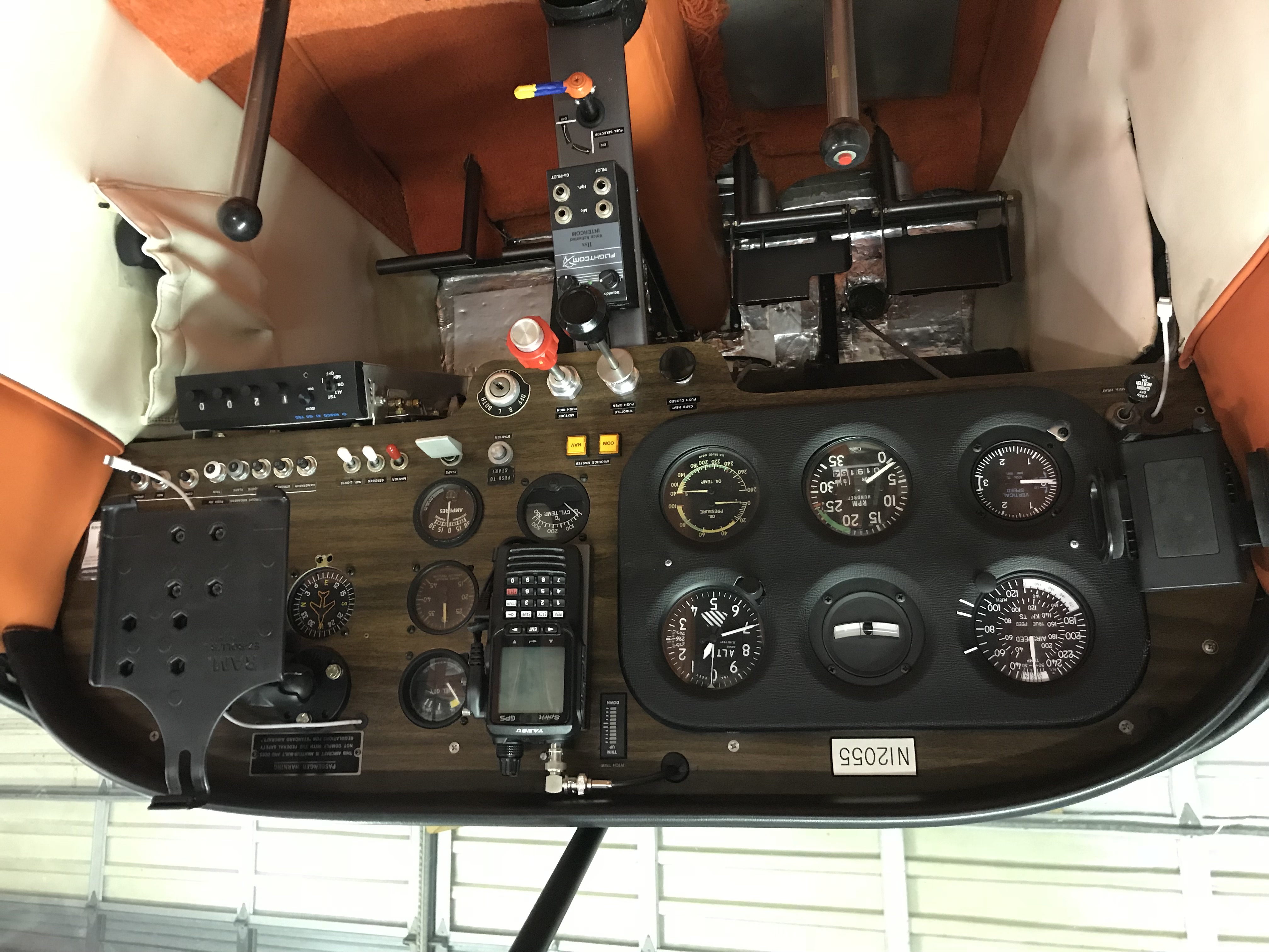

Happy New Year, everyone! N12055 has been getting ready with instrument panel labels, and other punchlist items being done. I've been doing taxi testing the past couple of weeks. She rolls straight and true with no tendency to veer one way or the other. Just touched 50 MPH last weekend.
The engine runs a little rougher than I'd like at idle with the original plugs, so she's getting new plugs. Anyone have a favorite plug for the Lycoming O-290-D?
Last weekend, I was testing the max RPM and got only slightly over 1800 RPM. Scratched head several times and then borrowed an optical RPM instrument and found that the installed tachometer reads 190 - 260 RPM too low. ??? ::) For example, 1000 indicated is actually 1260. I found out that the problem was magnets - many mechanical tachs have magnets in them and will read lower and lower as these magnets age. I think mine is 45 years old - but it looks great - haha. So, the tach is being replaced with a new 3.25" Mitchell tach from Aircraft Spruce with the green arc and redline option as well as them setting the hours for me.
I also found that the right brake wouldn't hold the aircraft still during run-up. It failed completely back in the hangar a day later while investigating, testing, and topping off the brake fluid. I think there is some sort of poppet or compensator valve in the brake's piston that failed. Anyway, both brake master cylinders are getting replaced perhaps with Matco MCMC-5A (Aircraft Spruce p/n 06-00375) units if they match the correct hole-to-hole length of the existing brake cylinders. What master cylinders (with Reservoir) works best for you guys?

Just noticed you asked about floor panels. Maybe I got the image properly attached, but in case it failed I also added it to my album in the photo section. I can't speak for other concepts, but for mine, I was intent to maintain shear strength of the original design; the floor panel is a critical structural item. I didn't really cut the panel for access, but kept it whole (I can crawl up inside with it removed). Instead, I replaced a screw for every rivet used to attach it. For the same reason, I used flat-head screws and dimpled the panel and (crosswise) mating joints, which is good for shear strength. Corresponding longerons for R&L edges of the fuselage are countersunk with locking nut-plates. This was extra work but handy for under the panel maintenance. You'll also see scuff plates for pilot and pax heels. There is a small access hole at center only to inspect rudder cable connection and springs inside the forward tunnel. The right pedal is notched to clear the fuel tank support as you'll see in early newsletters. External R & L ports are a redundancy to a single vent line going to the fuel tank. Brake lines are nylon with additional protective plastic tubing (Brake lines down the gear legs are aluminum tubing with a flex-bow on each end). The whole thing is a sub-assembly itself as the photo indicates.
