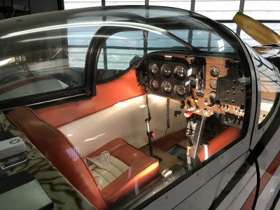

Thanks Brent and Fraser. It certain it feels like a long time and I didn't expect to be working on her for three years. I can only spend Saturdays and Monday nights working on her because of my business, but that's OK. I'm almost done. Here is a picture from Saturday.
File comment: Just a neat shot of N12055 that I took while working on the interior
