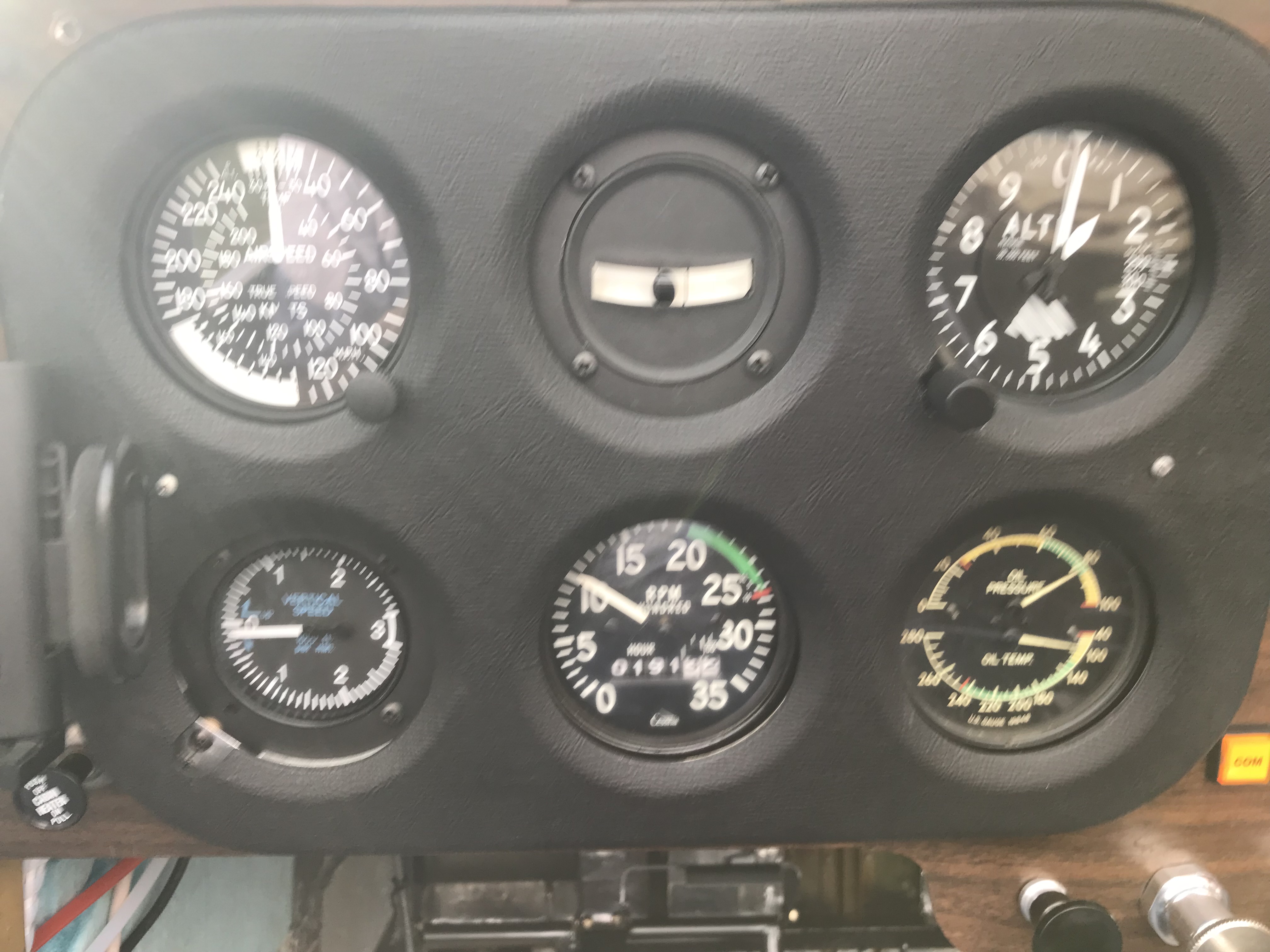

Successful engine start on Saturday after all the new wiring and throttle/mixture cables were hooked up. The engine sounded great and we took it up to 1700 RPM.
This Lycoming O-290G engine has 191 hours on the tach since converted to an aircraft engine. This is the original engine since N12055 was built in 1974. It is a low-time engine and then sat in a dry hanger for 12 years before I bought the aircraft. I started it two years ago and it ran great, then I removed the cylinders/pistons a year ago to change the O-rings and pushrod seals. There is no corrosion on anything we inspected such as the camshaft or wrist pins, pushrods, etc.
Question - I'm assuming that the rings are seated properly from the '70's. So, in your opinion, is it best when I'm flying it to either 1) run it normally because the engine is already broken in or 2) run it harder to ensure everything is still seated. I'm planning to use regular aviation oil and nothing special.
File comment: Oil pressure is 80 at 1100 RPM

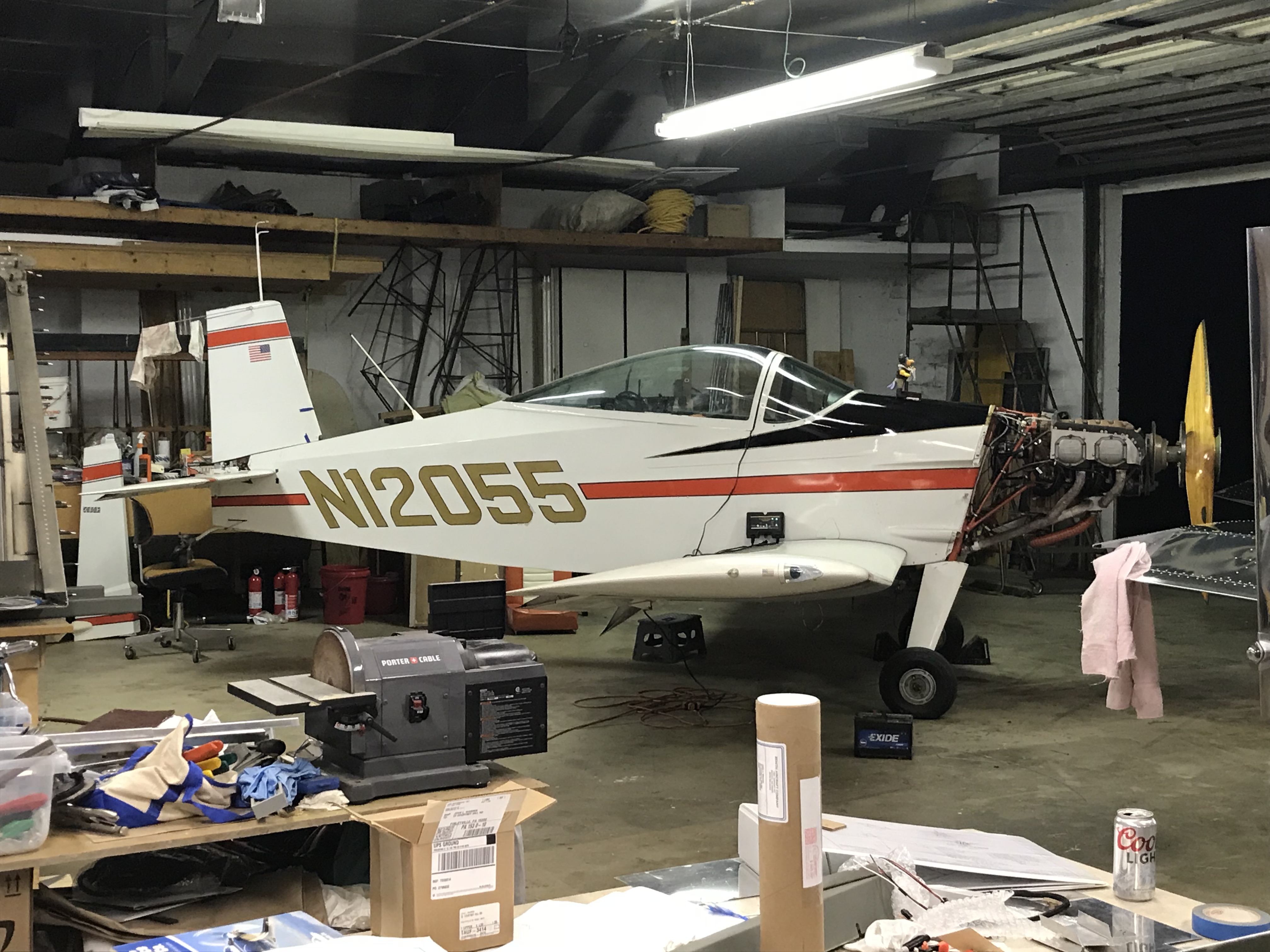

File comment: Just before N12055 was started

Congrats John. I would think the engine should be good to go. But you dont have to guess. Use your instruments. Check the oil temp, CHTs and oil consumption. Check the quality of the oil within a few tenths.
PostPosted: Mon Sep 03, 2018 10:23 pm
Compression test ? If all #'s are good I would do what Cubes said . :o
PostPosted: Tue Sep 04, 2018 5:45 am
A compression test before running doesn’t hurt but is of very limited value. A cold test will normally yield lower than normal results. If the cylinder walls were oiled/greased during reassembly then they will likely test higher than normal. About the only thing a compression test at this point would reveal is a bad valve (which there shouldn’t be any since since it was just reassembled). I usually wait around 10 hours if I am curious about compression after performing top maintenance to give things a chance to settle in.
