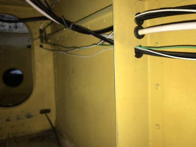

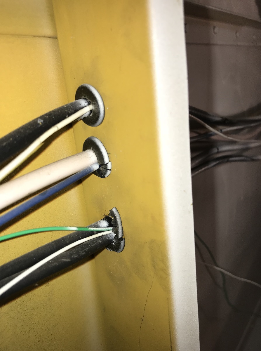

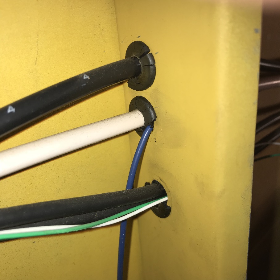

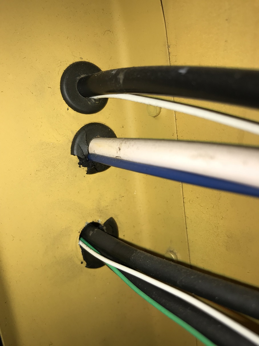

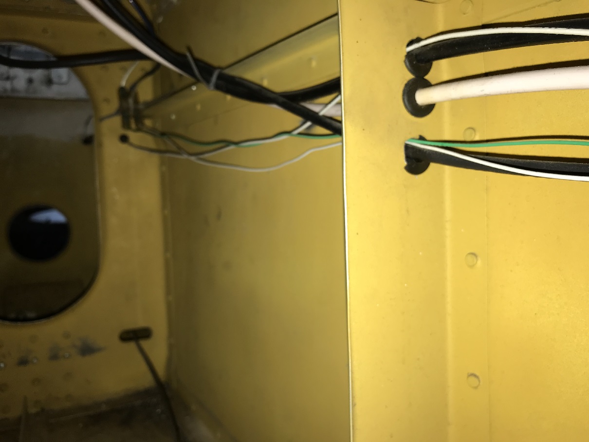

:o For anyone who has bought someone else's plane or project, one important lesson that I learned from crawling back in my plane's tail is that you don't really know what you have back there and even though it's a pain to crawl back there, you must take a look. I think that a previous owner had someone do some wiring in the '80's for the new electric flaps and trim and IMHO the hired "mechanic" did a terrible job. Look at the pictures of the grommets and wire in direct contact with metal bulkheads and you'll see what I mean. That person cut chunks off of grommets away so that the new trim wires could be pushed through the gap. So, be careful and take the time to look. It cost me an extra month to fix it all, but now I know that what I have back there is all new and done right.
File comment: Here you can see the cracked and rotted grommets in the rear baggage compartment bulkhead. The wiring forward of the bulkhead is a spaghetti mess too.

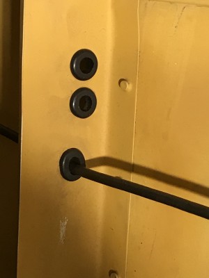

File comment: Moving rearward to the forward face of the next bulkhead. Same thing. Wiring is in direct contact with metal where the grommet had been removed or deteriorated.
File comment: More wires in direct contact with metal

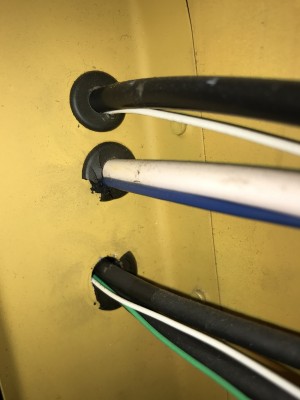

File comment: All wires in direct contact with metal in this bulkhead. One grommet completely failed.
File comment: All wires in direct contact with metal in this next-to-last bulkhead too

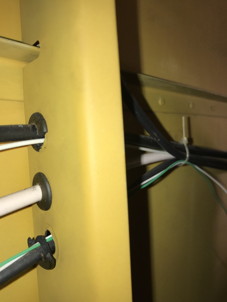

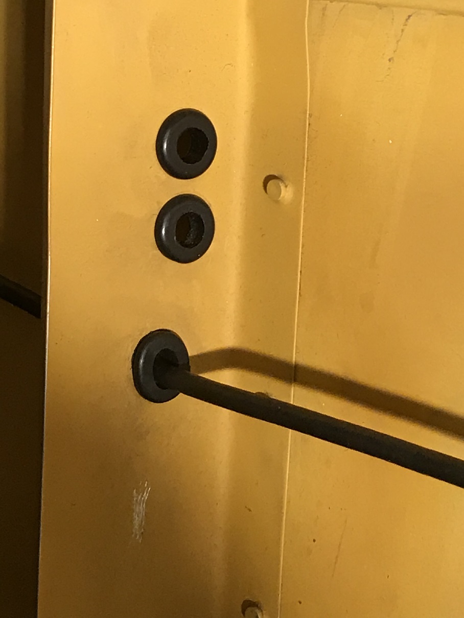

File comment: New grommets installed in all bulkheads.

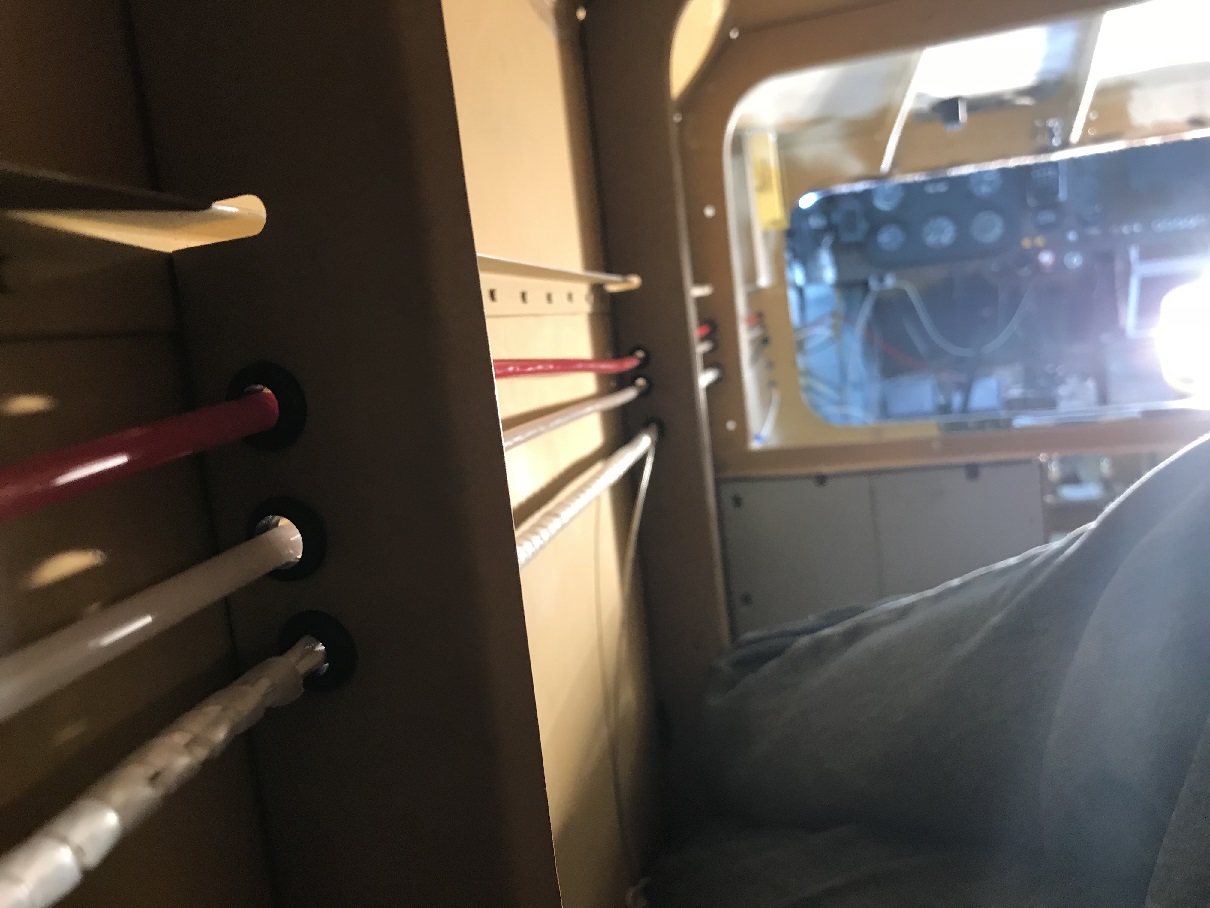

File comment: The new pitot (red) and static (white) tubing that I installed. I installed new wiring throughout the aircraft.

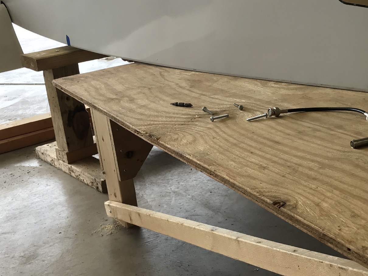

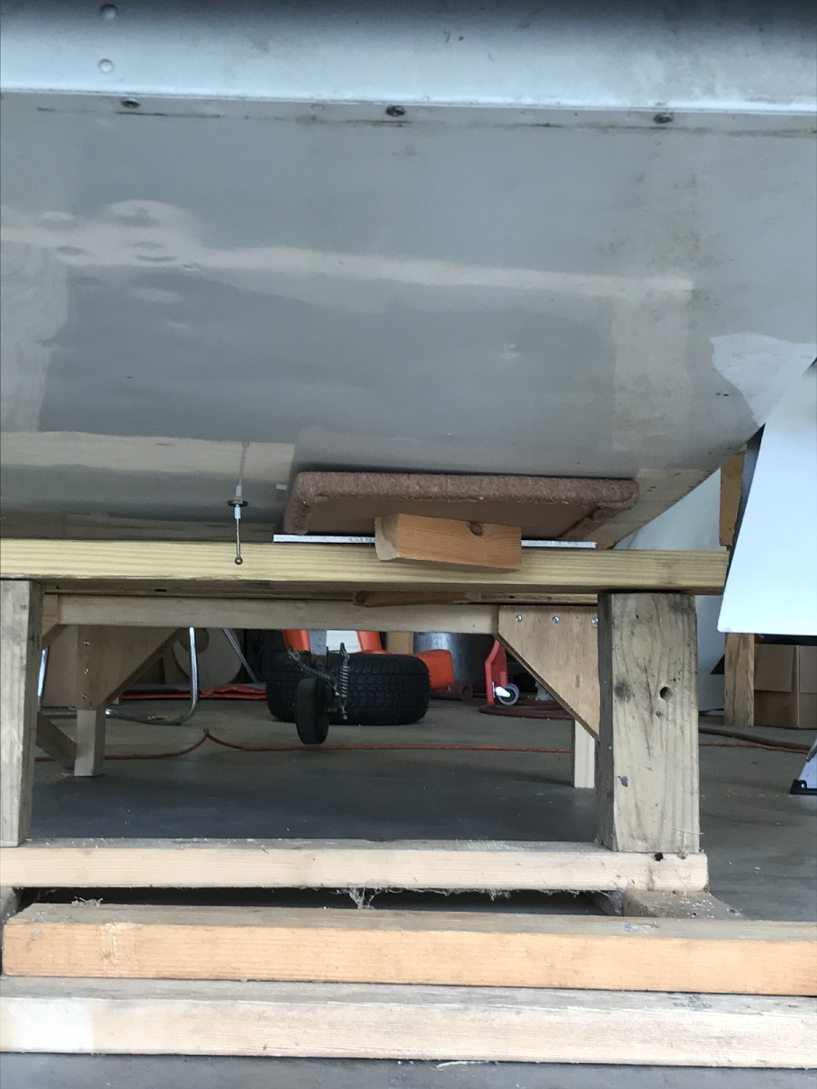

When I first got my Thorp, I asked the forum how people got back into the tail. I got a lot of answers and the consensus was that it was a pain and hot. I concur. Before I began, I started by building a small table to support the rear fuselage where it's essentially flat. I didn't want the fuselage skin and rivets to support my 170 lb weight and end up bending something. The table only lifted the fuselage a little so that the tail wheel was only 1/2 inch off the floor. Then I built an even smaller support for the port-side baggage compartment floor where it's a little curved.
Make sure to watch out that you remove any belly strobes first and that you don't hit/bend your transponder antenna. Before climbing in, I decided to remove the stabilator and its push/pull tube. I didn't see any other way to have enough room to work. You'll probably want to disconnect your rudder cables at the pedals too. When inside the tail, try to move the disconnected and slack cables off to one side so that you don't rub them against the fuselage floor with your butt ??? and scratch your floor.

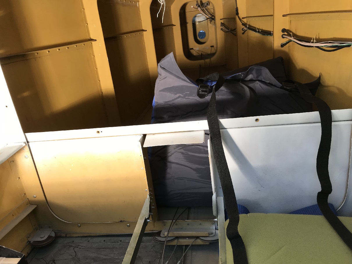

On a hot day, you'll need a fan to blow air back there. You'll also want to put something down to protect the fuselage floor metal. I used an inflatable sleeping bag cushion for camping. I found it easier to crawl out of the tail than into it. Crawling into it was kind of like a sick version of the old Twister game - but where a wrong hand placement can cut you. I have a lot of sharp metal here and there at the back of the baggage compartment and it really was a concern. Make sure to take your cell phone with you for pictures and emergency use. You should have a safety person when you're going in and out. I didn't think of that the first time :o ::) .
I hope this helps anyone who is thinking about how to get back there. Do any of the veteran builders have other suggestions?

File comment: I used a inflatable sleeping back cushion to protect the fuselage floor.

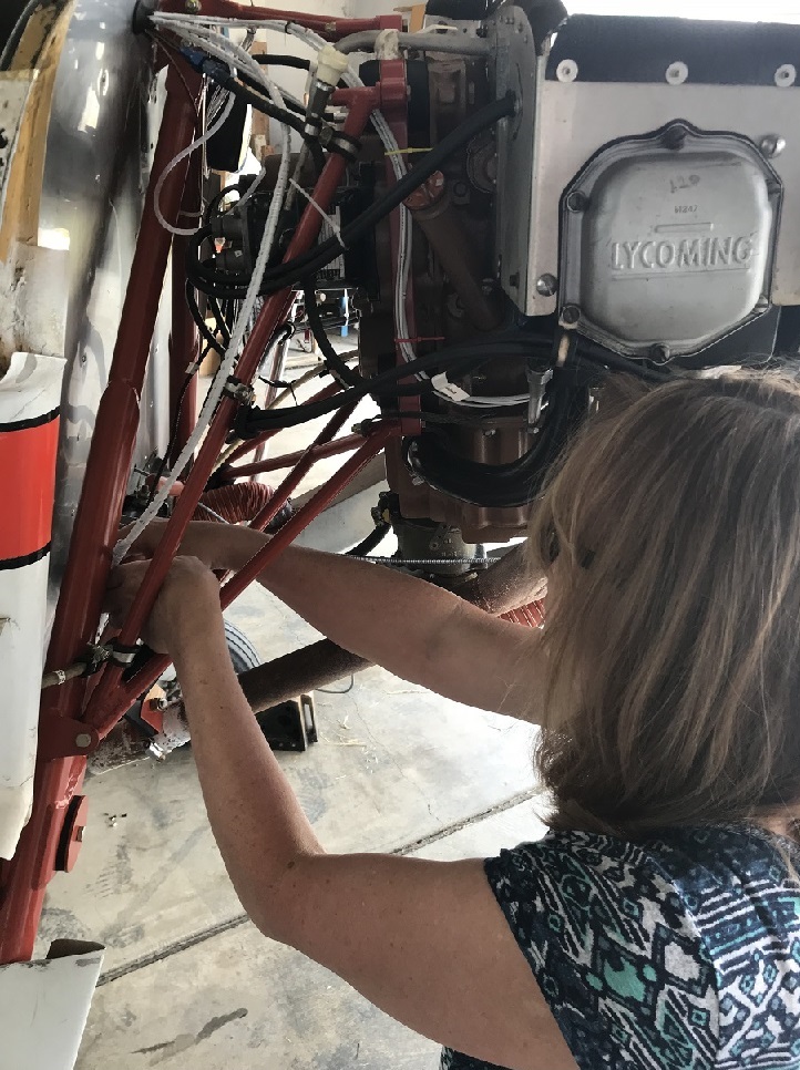

My wife, Maddie, came out to lend a hand last weekend for my birthday. SH*T's getting serious now!
File comment: shaving old carpet glue off stuff

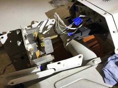

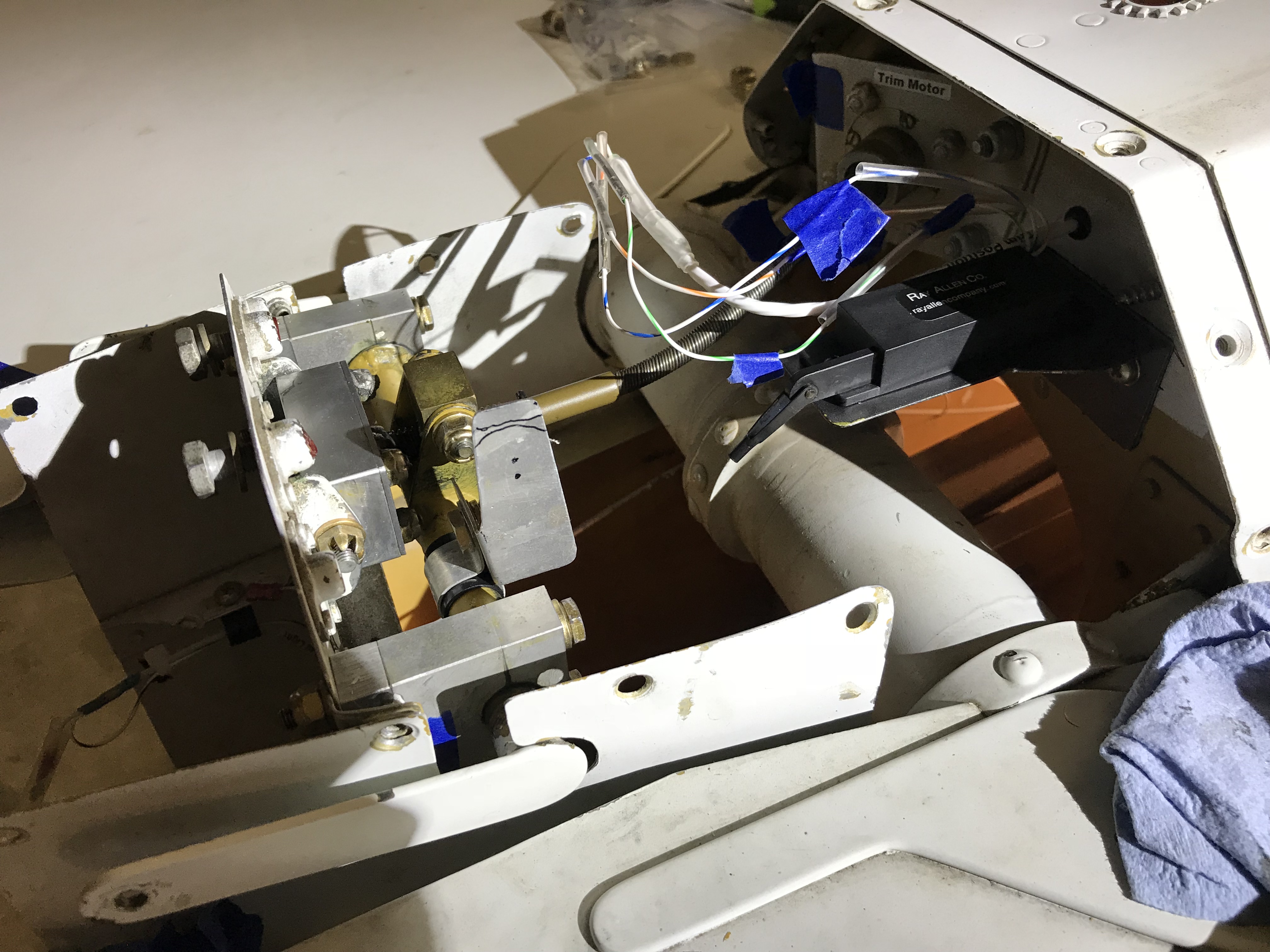

Here's a picture of where I added a Ray Allen trim position sensor in the tail and mounted a corresponding arm to the trim axle. There is about 1" clearance between the sensor and the top of the horizontal stabilator spar. The rod between the sensor and the arm (with the two black ink dots) is yet to be installed.
PostPosted: Thu Aug 30, 2018 6:13 am
Posts: 1167
Thanks for that photo John. I'm going to give your setup a try while I still have my tail area open. Thanks again.
PostPosted: Thu Aug 30, 2018 2:22 pm
Hi Ryan, a couple notes on the above picture.
1. I used an Adel clamp to go around the trim axle. However, I found I had to take the rubber off the clamp otherwise the metal would easily slide inside the rubber. After that, I put some electrical tape under the clamp to cushion the axle from getting scratched or worn from the clamp.
2. Note that the top of the arm is too high and that I marked an arc on it where I wanted to cut it down so it didn't hit the underside of the cover.
3. The Ray Allen position sensor that seemed to work best for me had the .75" slide travel.
4. Ray Allen recommends that a threaded model aircraft rod and clevis be used instead of a thicker, aviation-style. The hole in the position sensor is very small. The picture shows the threaded model aircraft clevis that I installed.
