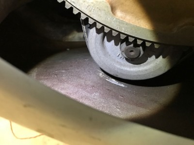

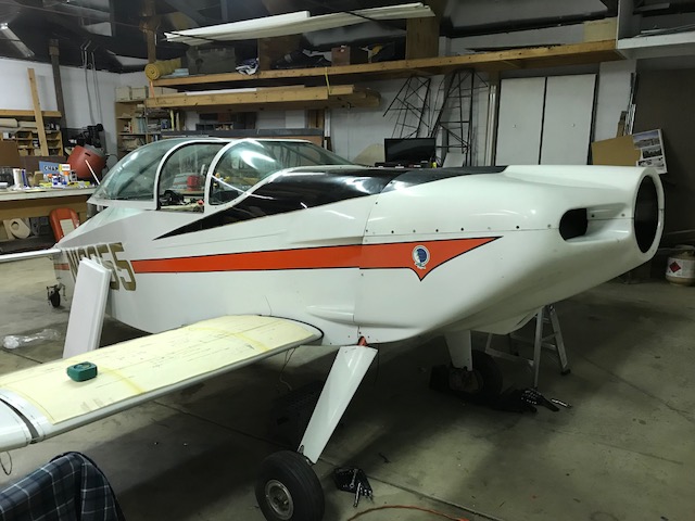

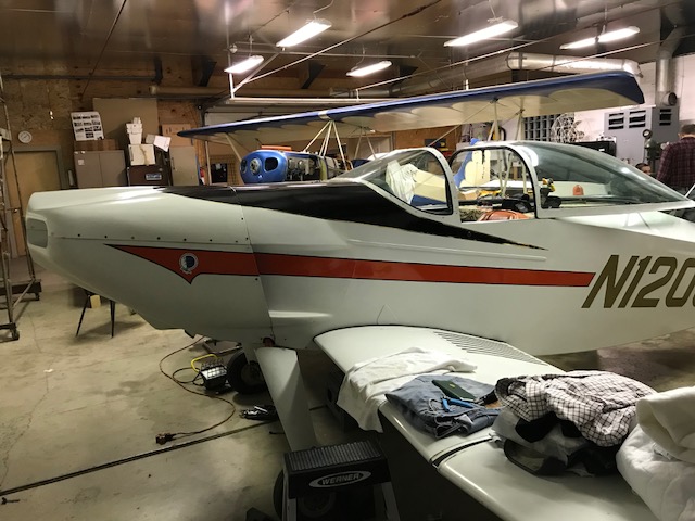

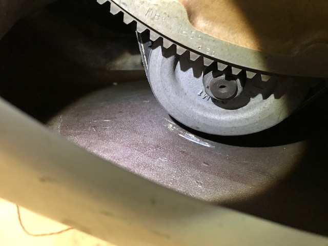

Hi Everyone, I hope you are all well and had a good winter. I basically took a 2.5 month break while it was very cold here, and I've now started working on N12055 again ;D .
Last night I did a cowl fit check. After changing out the old, sagging rubber shock mounts last year, the new donuts lifted the engine back to where it used to be (about 3/16"). The prop hub is now centered in the cowl's prop spinner opening. And you can see where the generator pulley was rubbing on the inside of the cowl but isn't any more.
I've read that this type of cowl required people to remove the prop to remove the lower half just to change the oil, for example. If so, what are best remedies such as cutting in access doors, etc?

PostPosted: Tue Mar 20, 2018 11:11 am
I don't remove my lower cowl to change the oil. I've got a quick drain. I feed a small hose up through the exhaust opening to the quick drain. Easy.
PostPosted: Tue Mar 20, 2018 11:33 am
thats what I do as well. I remove my lower cowl once a year at CI time. I am able to get it off and on without removing the prop, but it takes some time to do it.
PostPosted: Tue Mar 20, 2018 8:07 pm
Ryan - do you have the Ratray (sp) cowling like mine? If so, what is the procedure you've worked out to get it off and on?
PostPosted: Wed Mar 21, 2018 7:12 am
I dont know which type cowl I have. But, to make my life easier, when I remove the lower cowling, I remove the gear leg fairings first which I have made to be undone with a few screws. I basically drop the back end down first then drop it out of place. Reverse goes for the installation. IT has to be done that way because the prop/spinner will get in the way otherwise. The only part about my lower cowl I dont like is that my carb heat system is part of my lower cowl, so I have to remember to undo the carb heat cable, and tubing.
